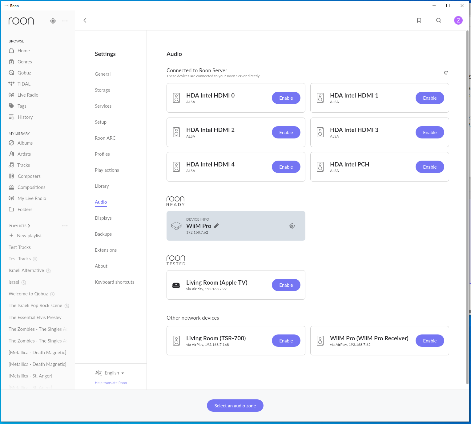

@Zachi, are you saying that you W10 PC is not showing as a Roon Remote or Roon endpoint option with either Roon or Roon Bridge installed on it? Have you checked that the W10 PC has roon.exe, raatserver.exe, and roonappliance.exe set as exceptions in the Windows (or third-party) firewall, as well as ensuring your W10 PC is set to Private network?

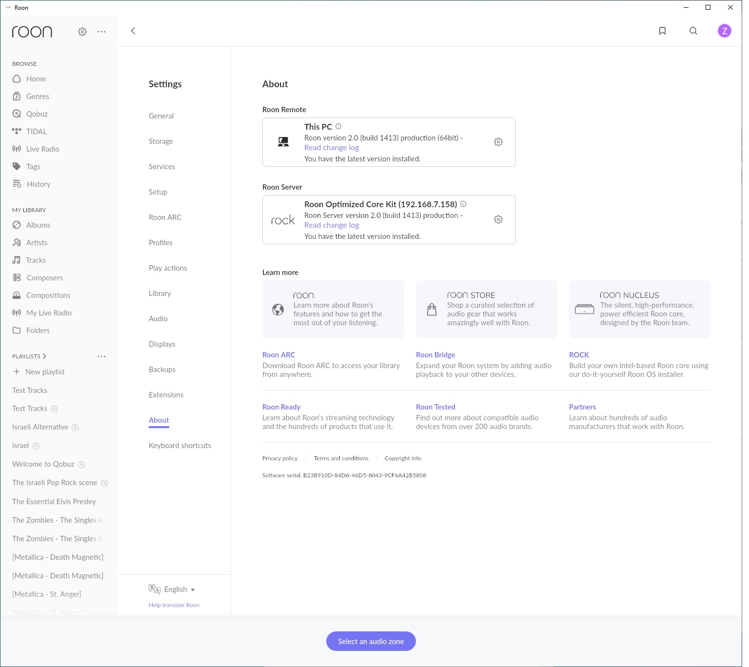

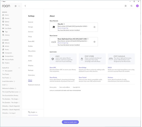

I am running Roon on the PC - see “about” tab in settings:
And what about this?

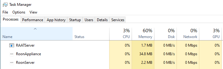

Looking at the Task Manager - I see both Roon Appliance as well as Roon Server are running.
Is that normal? Should I somehow stop Roon Server process on the W10 PC?
It shouldn’t matter but you can stop it. Right-click the little Roon icon in the notification area on the Windows task bar. Also uncheck the “Launch at startup”:
(The Roon installer installs the Roon Server on Windows as well, but as you use ROCK it’s not necessary)

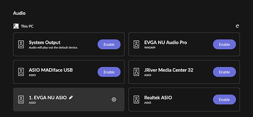

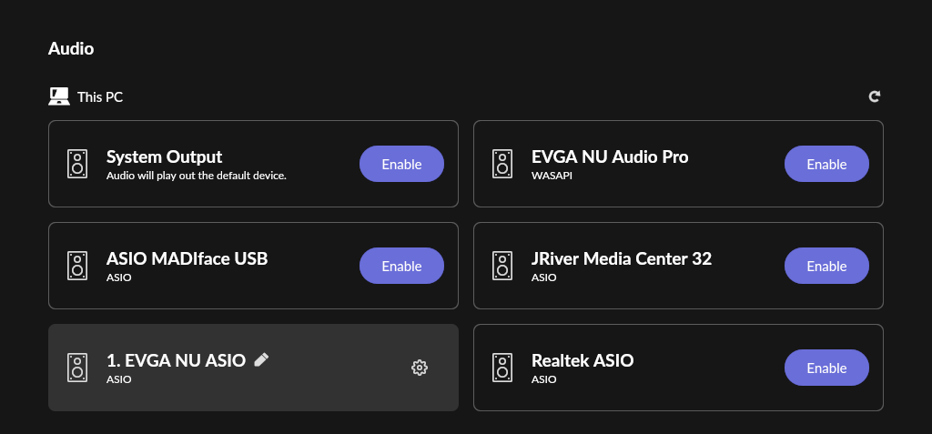

There is an issue of communication between your Server and your PC. The Server queries the PC to find out audio devices on it, and then the Server builds the audio devices using the responses.
Notice the “This PC” section…
You’ll notice that your screen pic is missing the Local “This PC” completely which again suggests that the communication is broken.
Some people have mentioned the most common causes.
  1. Firewall. This can be mis-configured, so I’d just test by turning off the firewall completely and see if the audio devices show up. If not, then turn it back on. If so, then you know that a firewall configuration is the issue.
  2. Private vs Local which you’ve already said that you checked that it is private.
  3. VPNs running on the PC. VPNs and other network software can cause issues.
  4. Software Conflicts
  • Conflict with software that controls audio devices, including Gaming Overlays, DAW software, etc.
  • Sometimes out of date Realtek drivers have caused this.
You might try resetting your Raatserver which would force the server to recreate the audio devices.
