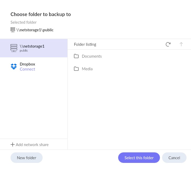

I have tried to get an answer on this since setting up my Nucleus One on July 1st. I want to set up a secondary backup location and can't get the software to recognize it.
Nucleus One connected to Gig ethernet with primary backup location a NAS on same network. All devices see each other so not a connection issue. How can I delete the NAS backup and add a different share.

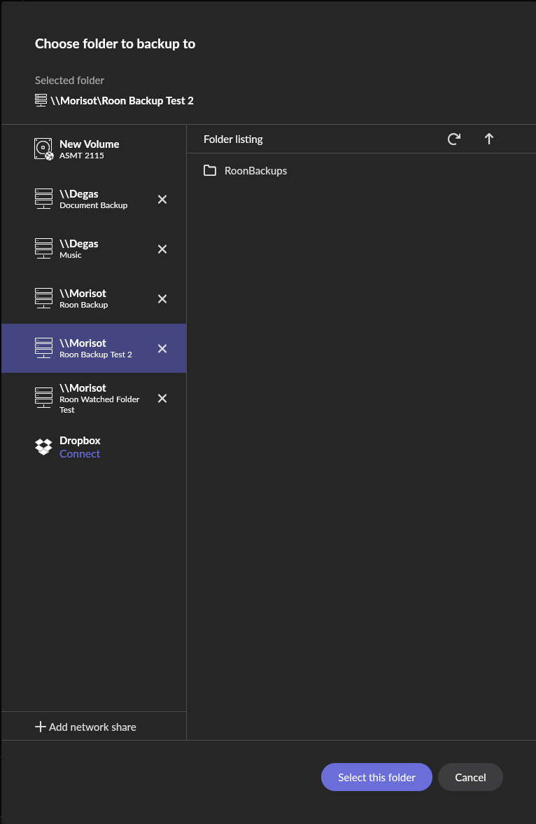

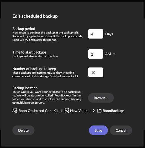

@Jim_Serenbetz - I believe that your existing Backup folder (\\netstorage1\public) cannot be deleted in the screen you show because you only have the one Backup location defined. It’s not until you have additional Backup locations defined that you are able to delete them directly from this screen. For example:

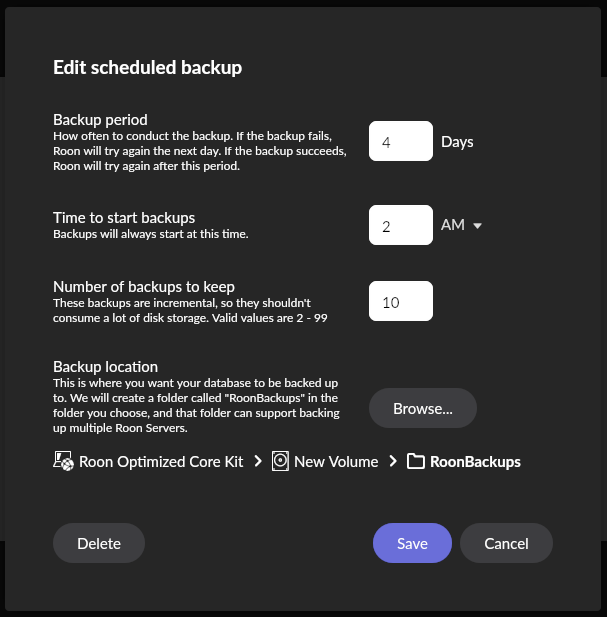

What I think you need to do is to edit the Backup location that you have and delete it there:

I’ve selected “edit” and deleted it but it remains as the choice folder. What am I missing?

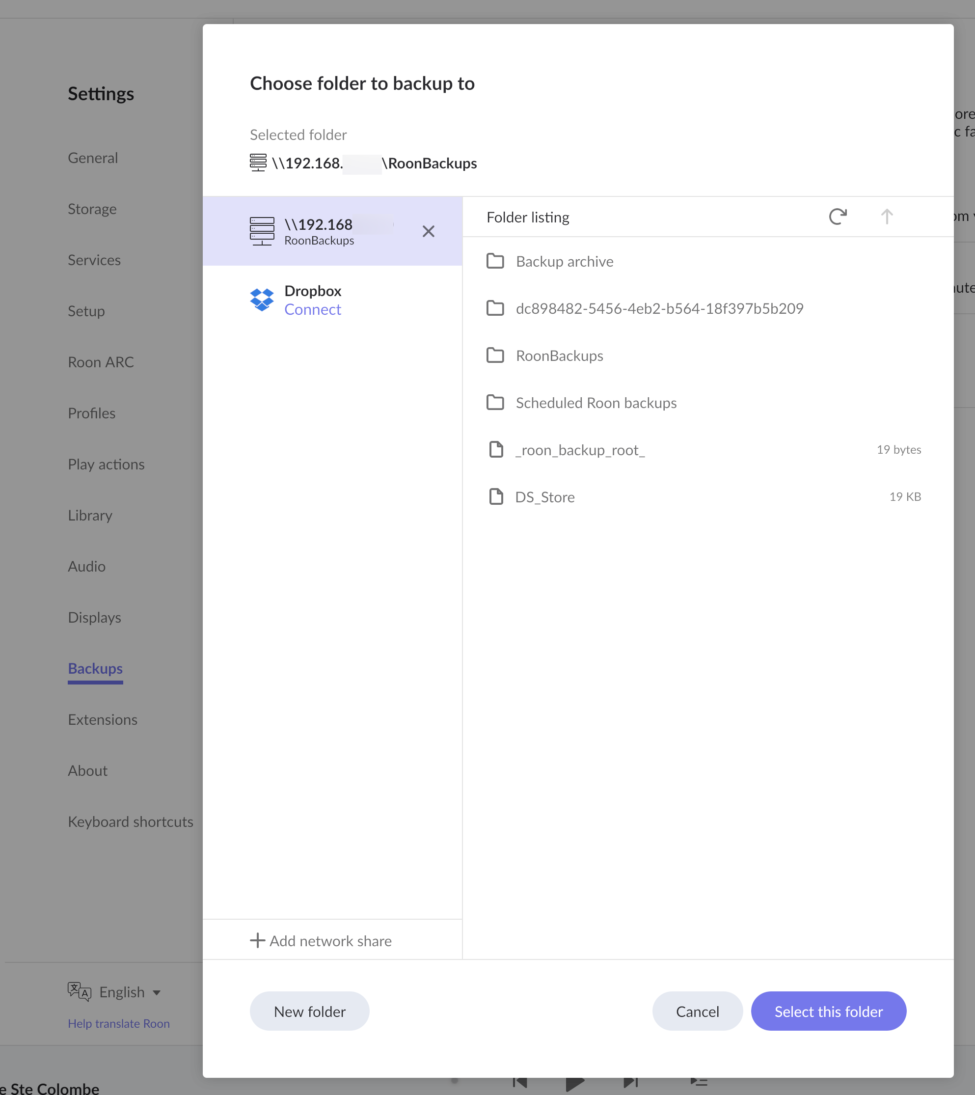

Sorry I missed spelling of your name Geoff ! I noticed on your screen print you have an active up arrow. Mine is grayed out. Despite what I try, I can’t get the “x” next to my NAS location to delete - even after deleting the path to it in a previous step.
Jim,
As Geoff says, that’s because Roon needs at least one Backup location (other than Dropbox, which most people would strongly suggest you avoid - corruption can occur if the slowness of Dropbox ‘takes over’ while the Roon database is being written to; avoid direct to Time Machine for the same reason) and so prevents you from deleting the one you have, however ‘currently malformed’ that may be.

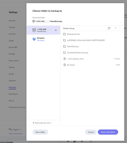

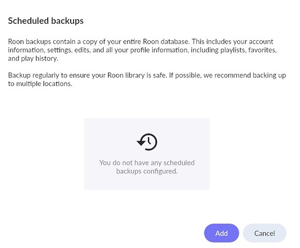

From your screenshot here, can we clarify: you are seeing the same ‘behaviour’ for manual backups (Settings > Backups > Backup Now > Select Location), aren’t you?
This is what I see in my case - once I successfully managed to get the syntax right (apologies for the over-cautious ‘redacting’ of my last two octets!):
Can you get anything close to that? Presumably you will have to use the Control Panel (or equivalent software) of your NAS to get its IP address.
