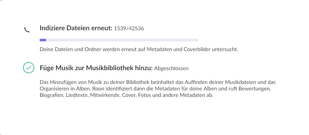

Very slow indexing after update.
takes several days on a small library

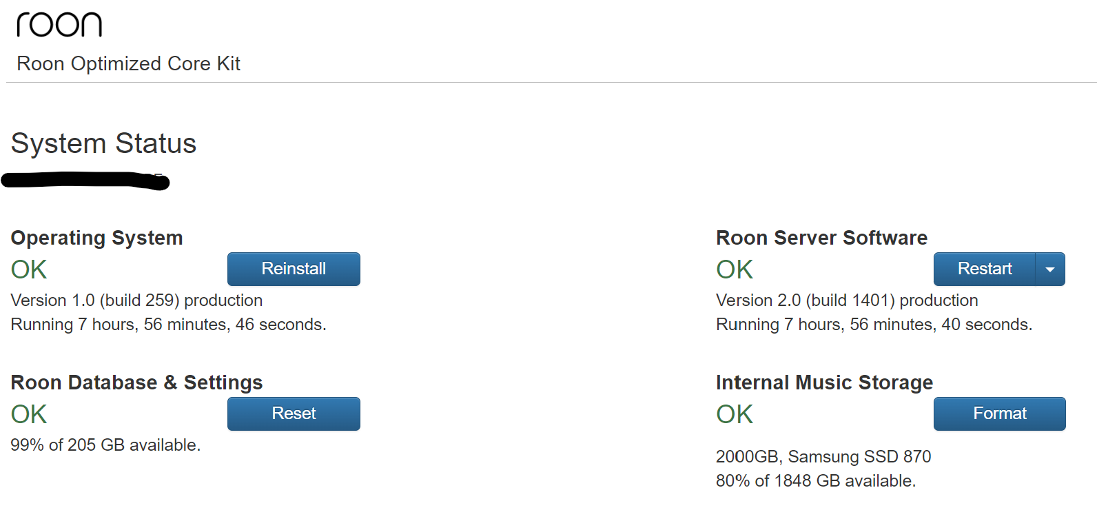

Describing your server and system will help Roon support
Ok, it’s an Intel NUC 7i5BNK 256gb M2 SSD 20gb RAM running ROCK. The music is on an internal 2TB Samsung SSD 870.

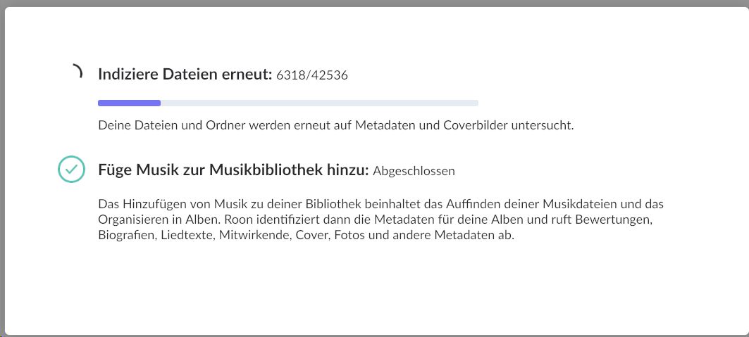

I did a hard reboot bot on router and the NUC. After that index speed is still slow on 12 Songs per Minute. 28.000 Songs left. So it will take 2 more days.
Would it be helpful to send the logs for further analysis? Indexing was often slow.
Hi @Helge_Hartmann,
Thanks for the update. As a follow up test, could you temporarily remove all the content related to Biodanza/Biodanza Musik from your watched folder, and see if things are still moving slowly? Roon seems to be tripping up on a number of works from this artist
This is the main folder with my music. The indexing has now been completed.
