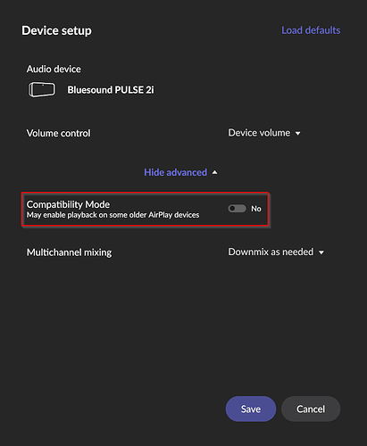

Thanks for reaching out. If you try to manually click somewhere in the seek bar when in this state, does playback temporarily work? Is there any change in behavior if you try to enable Compatability mode in Device Setup?
Hi Noris
Thanks for reply.
Sorry, but my device setup doesn’t show the compatibility mode button at all.
All the other ones, but not this one.
Finally, all the devices I tried are brand-new models. I tried the Devialet, I tried the Denon Heos and also the Bluesound in AirPlay mode. Always the same. With a Cyrus amp I played in Chromecast, but the same unit did also not work in AirPlay , so it is by sure a general AirPlay problem… (with v 1.8)
