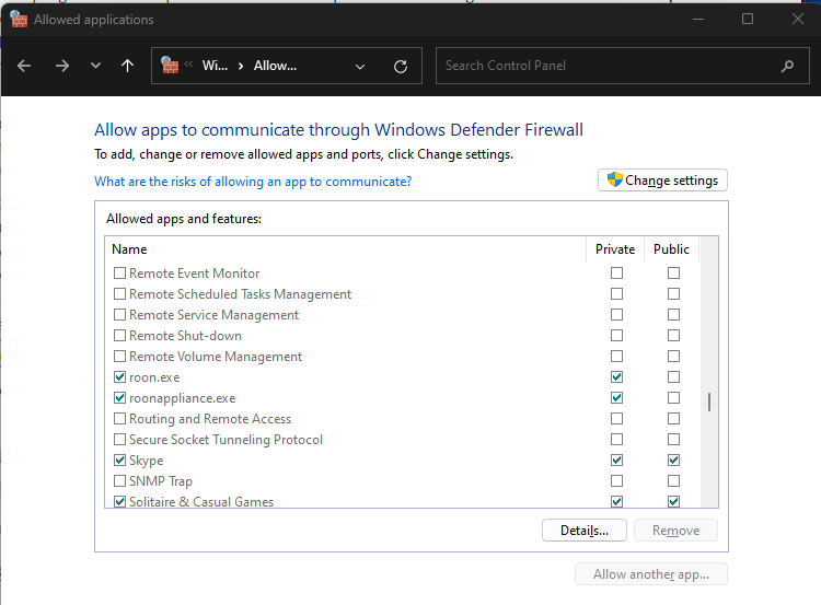

What you should probably have in your Firewall exceptions list are entries for roon.exe and roonappliance.exe:
What happens if you temporarily disable the Windows Firewall as a test? Do the PC audio devices appear in Roon?
Hi Geoff,
Yes, it works with firewall disabled. I have found in the past when I have got it working it reverts to not working after a few days.
I have found that both roon.exe and roonappliance.exe are in the list of exceptions for the private network

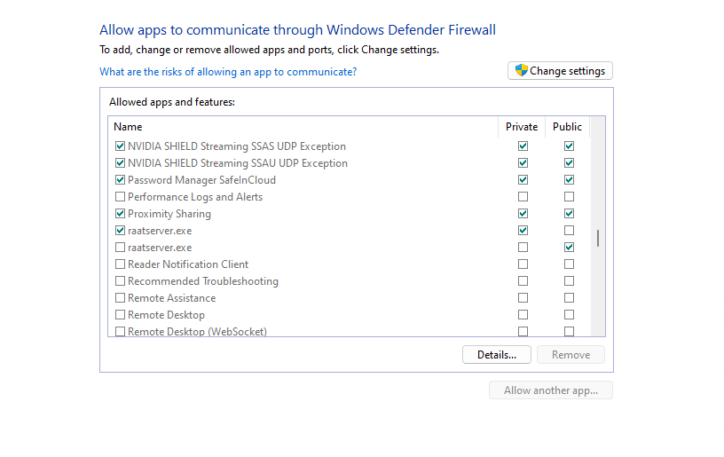

What about raatserver.exe and roonbridge.exe. raatserver.exe should definitely be in the list of exceptions for the private network. roonbridge.exe should be in the list of exceptions for the private network if you are using Roon Bridge. roonappliance.exe is only required to be in the firewall exceptions if the windows PC is your Roon Server - in which case roonserver.exe should also be present. However, it will not do any harm if the exception is present and unused.
Have you checked that you Windows network is set to private? If it is set to ‘public’ then it will not be applying those exceptions. The public/private network attribute is set ‘per network interface’. ie. It may have to be set for your wired internet connection and your Wifi connection if you use both.

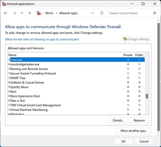

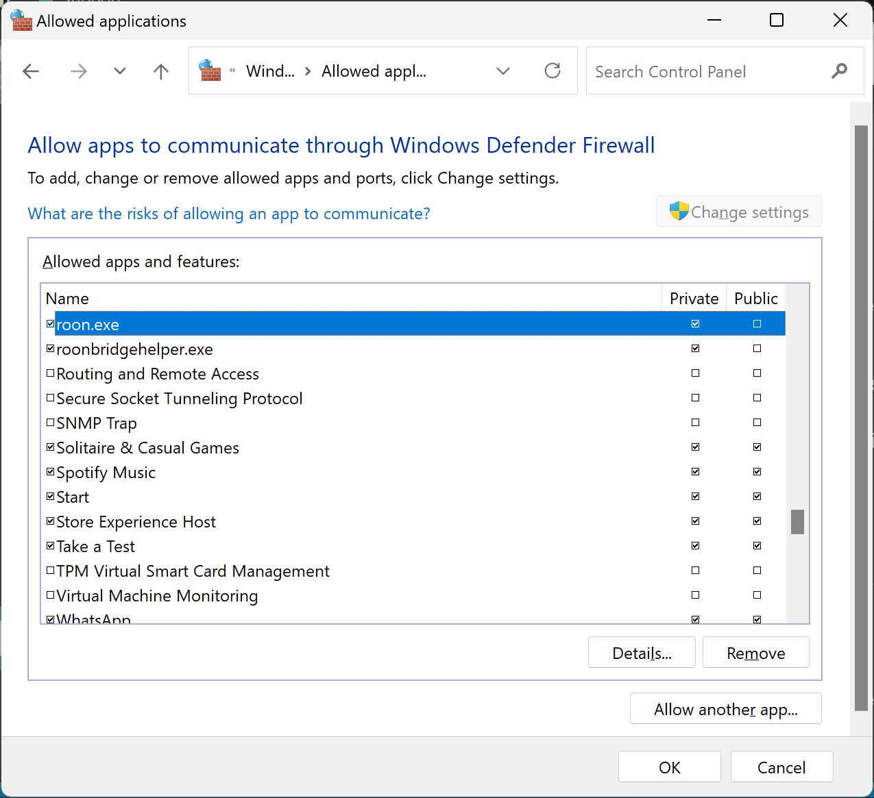

I do not have roonbridge.exe listed for exception. There is a listing for roonbridgehelper.exe which is checked.
I was using information from the help article on the firewall at:
It appears that this article is out of date as it looks like it may be roonbridgehelper that is required as well. Here are a couple of screen shots from my firewall excedptions that show what I have:
This setup works both with and without Roon Bridge running.
