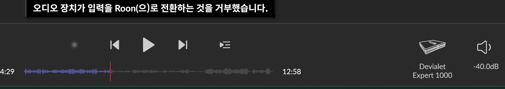

Hi Roon Support Team,
Ever since updating Roon Server and Remote to Build 1696, I have encountered a consistent issue with auto-input switching on my Devialet Expert 1000 Pro when using the Roon Ready (RAAT) protocol.
[Setup Details]
- Roon Server: Synology DS1522+ (Roon Server v2.73 Build 1696)
- Audio Endpoint: Devialet Expert 1000 Pro (Connected via Ethernet, Roon Ready)
[Description of Issue]
1. Previous Behavior:
When the Devialet 1000 Pro was in standby mode, hitting "Play" in Roon via the Roon Ready zone would automatically power ON the amplifier, switch the input to Roon, and start playing music immediately.
2. Current Behavior (Build 1696):
When pressing "Play" from standby, the Devialet powers ON successfully. However, playback fails immediately, and Roon throws the following error message:
"오디오 장치가 입력을 Roon(으)로 전환하는 것을 거부했습니다." (Audio device refused to switch input to Roon.)
If I manually press "Play" a second time after the amplifier is fully awake, it plays fine.
3. Comparison Test:
When using the "Devialet AIR" protocol under Other Network Devices, pressing "Play" from standby works perfectly (wakes up and plays without any error). The issue occurs exclusively with the Roon Ready (RAAT) input switching handshake.
It seems that the RAAT handshake/trigger timeout during wake-up might have changed in Build 1696 before the Devialet finishes sending its input-switch acknowledgment signal.
Could you please check this issue? Thank you!
Synology DS1522+ NAS and Devialet Expert 1000 Pro are both ASUS RT-AX88U connected via Gigabit Ethernet (LAN cables) to the same local router/network switch.
