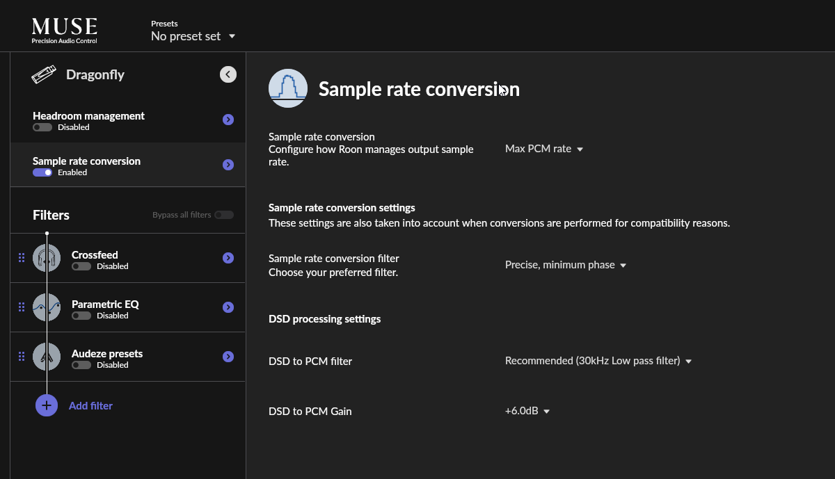

While you check with Focusrite on this, one temporary workaround you can use is to upsample everything in Roon to this same sample rate using MUSE:
