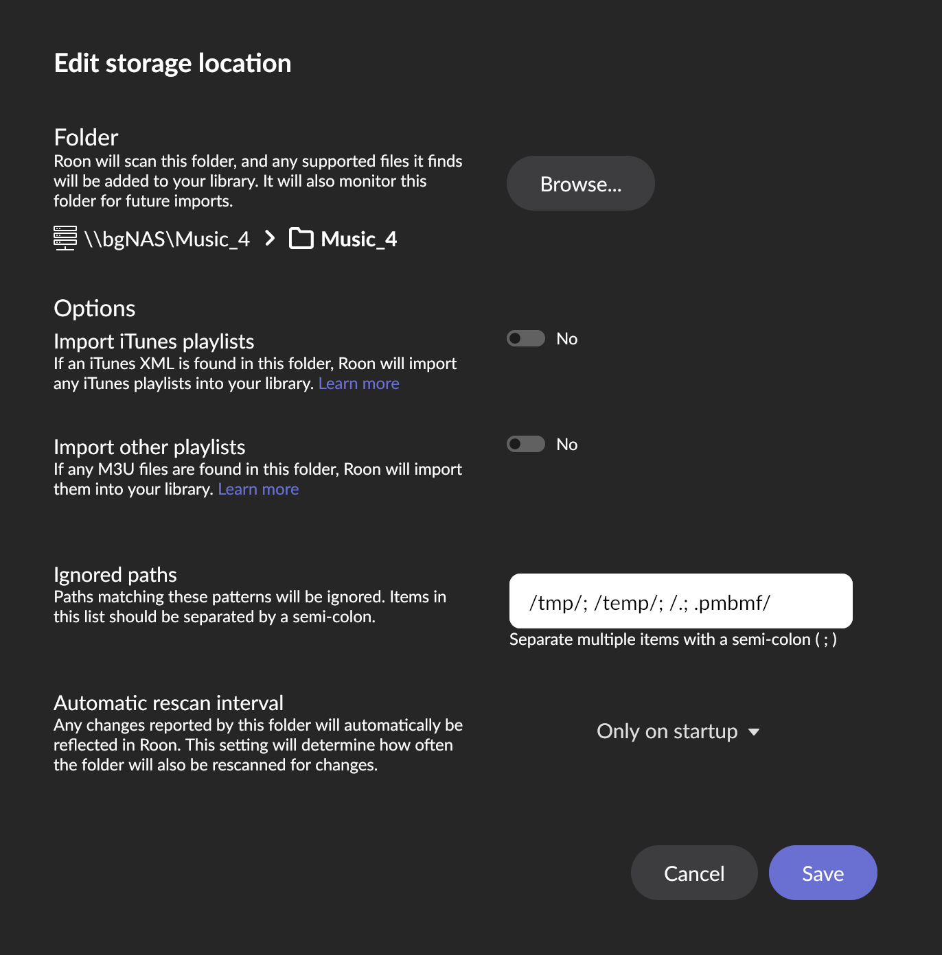

Thanks @Marin_Weigel. I already have my library broken up into 9 different volumes on my NAS and each artist and each album has its own folder. For those artists with more than 100 albums it is further broken down.

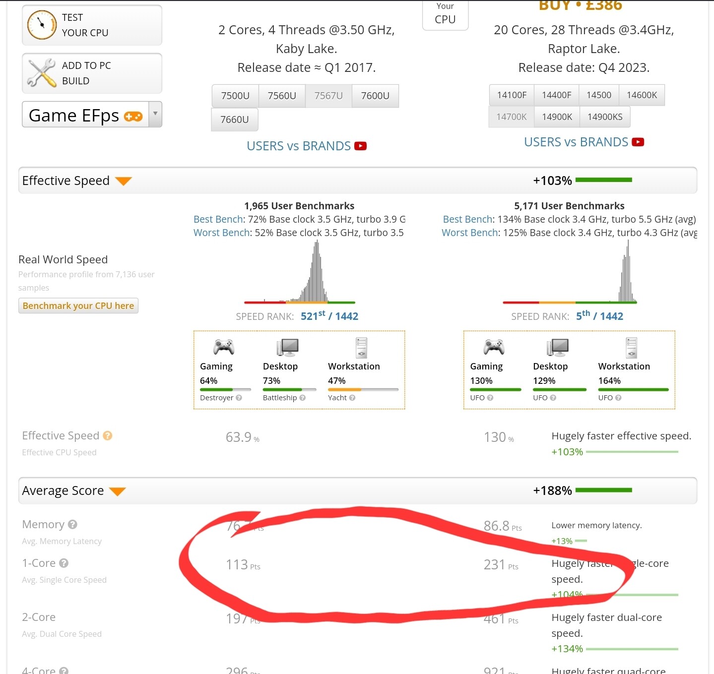

@BobG, how large is the internal drive on the NUC holding your Roon OS and database? A 7-year system containing 2M+ tracks also may be pushing the OS drive to its limits.
256GB but it is only using 60%.
Every configurator I’ve looked at says it takes 64.
@ged_hickman1 - My bad. In haste I looked up the model NUC from records I had at the office and pulled the wrong one. This is actually a NUC7i7BNH, not the NUC 11. The NUC 11s were for another customer project we have going. Unfortunately the RAM max is 32GB for the one I have here.
PS - Tried to edit my initial posting but not possible.
That would explain it then :grin:

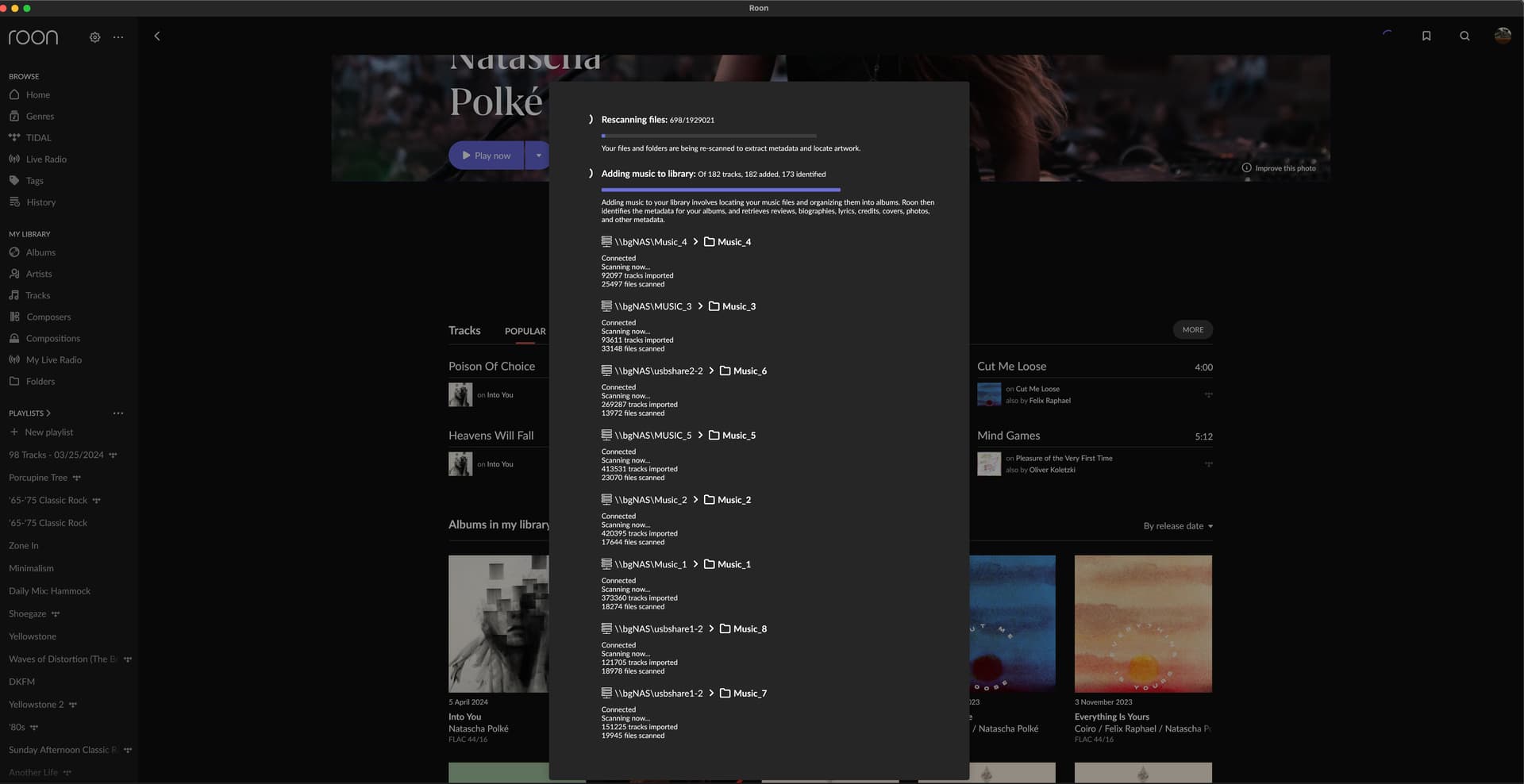

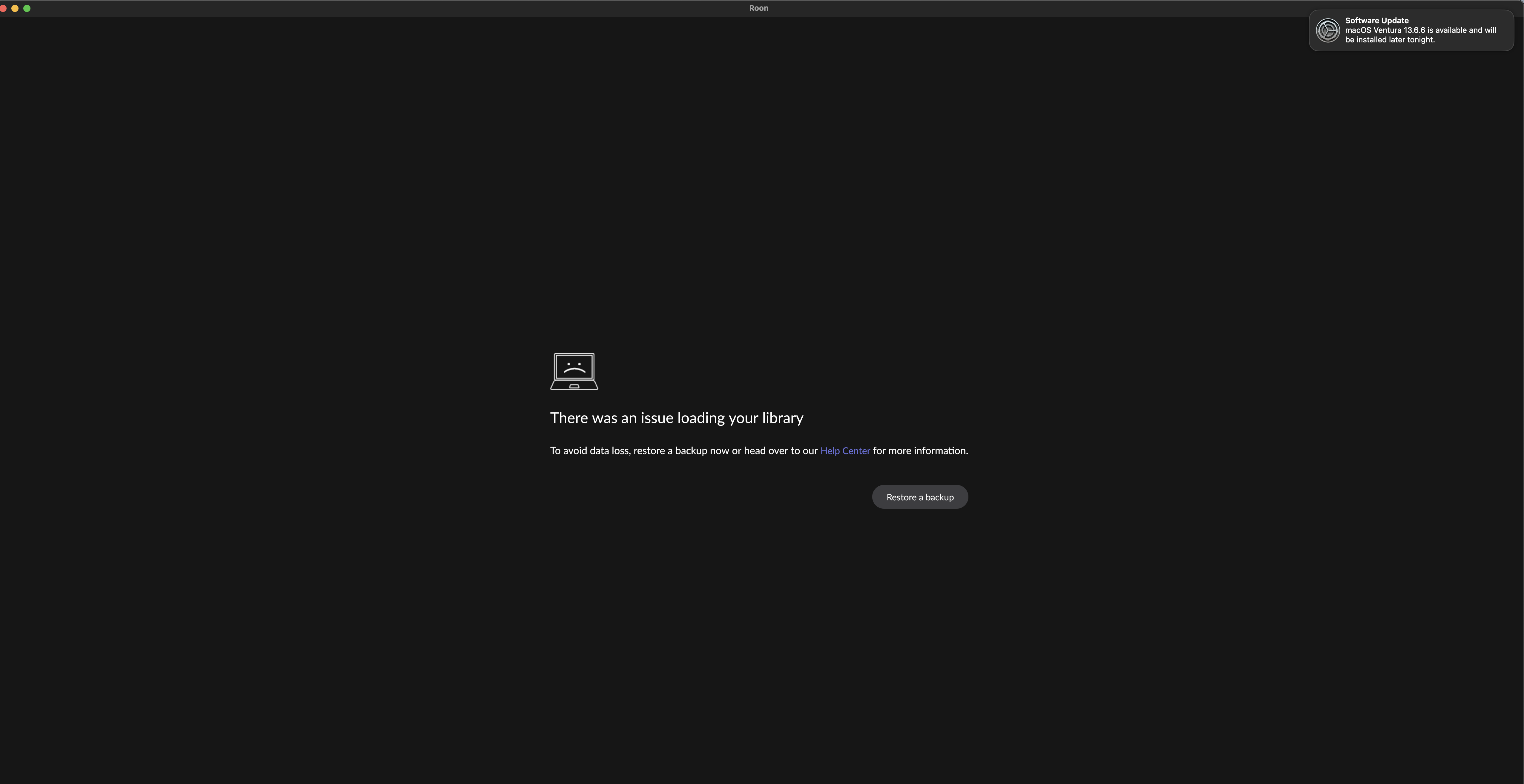

Here are some more observations noted with this recent release ROCK 2.0.33. When I first restart the server now, it goes through and scans all the media as it normally would in the past, but also noted it is trying to rescan my entire library for changes in metadata.
Here’s a snapshot of a log showing the failure pattern. Note that it is NOT tied to these two albums (folders) shown in this example. The error occurs on random folders.

04/15 16:26:28 Error: [broker/database] corruption detected: IO error: /roon/data/RoonServer/Database/Core/82ea5ac15fd64b5ca9e4424625740f6f/broker_4.db/91669164.ldb: Too many open files
04/15 16:26:28 Warn: [broker] detected corrupt database, notifying client
04/15 16:26:28 Warn: [broker] detected corrupt database, halting broker threads
04/15 16:26:28 Critical: Library.EndMutation: LevelDb.Exception: IO error: /roon/data/RoonServer/Database/Core/82ea5ac15fd64b5ca9e4424625740f6f/broker_4.db/91669164.ldb: Too many open files

Any NUC7 or NUC11 for that matter is woefully underpowered for running a 2,000,000 track library. A laptop class processor is not the answer.
Get a desktop class i9 to handle that morbidly obese library.
AJ
I doubt Roon will spend a lot of time investigating your use case as you are such an edge case. Probably one of a handful with such a large library and perhaps fewer trying to run it on inadequate hardware.
As @WiWavelength says, get a PC fit for purpose, a new desktop processor is twice as fast in single thread tasks, which is what you want for Roon.
