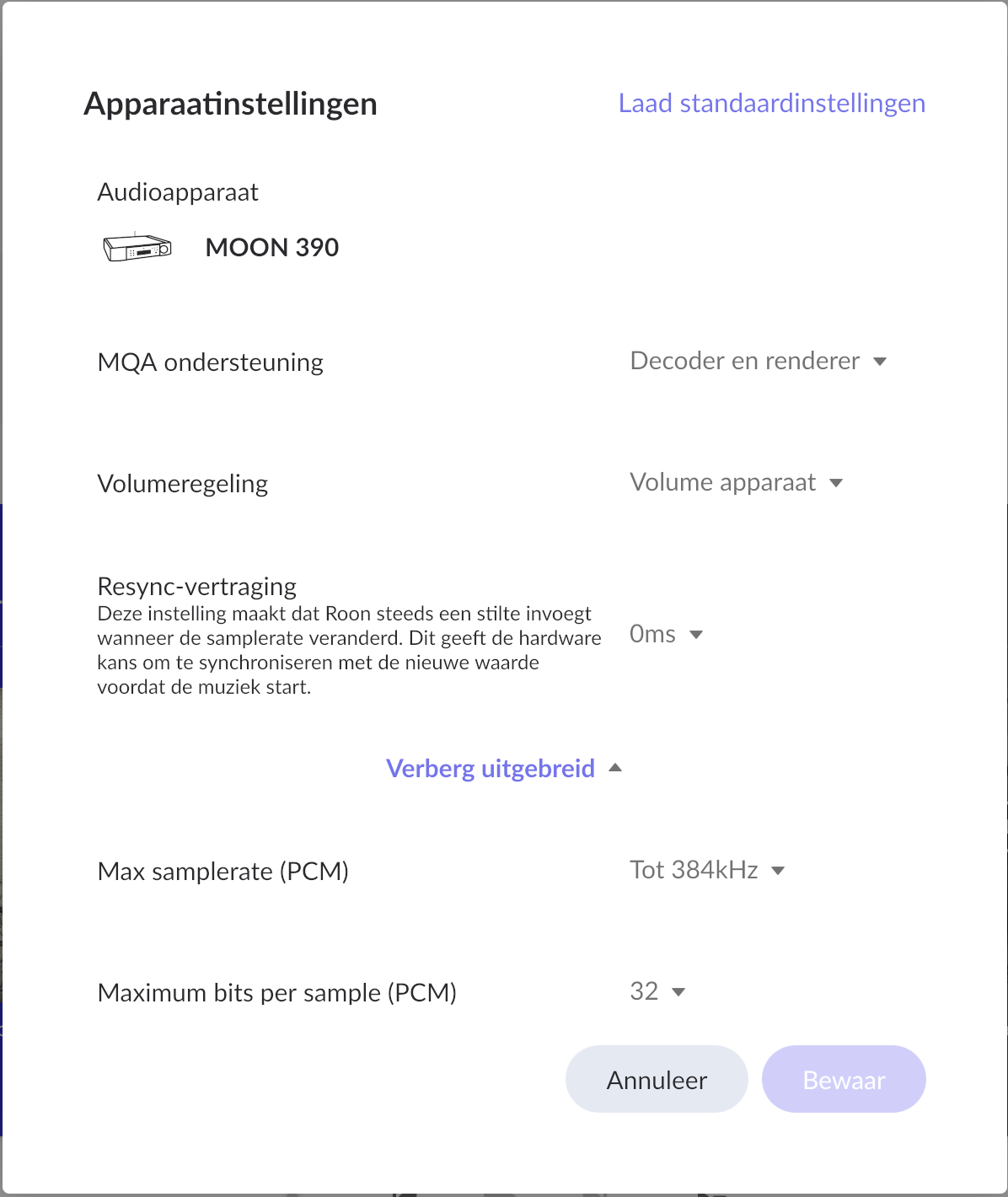

Please see attached screenprint for volume-settings (I hope this is what you mean).
I doubt if it was a power-glitch as all other electronics (NAS, PC etc.) gave no problems at all and power to the Moon setup is via an Audioquest Niagara 1200 Power Conditioner.

The important piece here is the “value” at the very end of the log, in combination with the ‘GOT’ trace. This tells us that something sent the command to Roon to push the volume to max. So we can confirm in this case that Roon was not the culprit behind sending the volume adjustment.
Unfortunately, I’m not able to give you any additional insight into what specifically sent the command, outside of it relating to your Moon 390 device.
