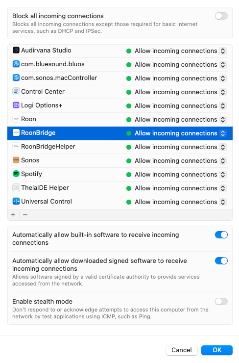

The firewall is on. I’ve added the Roon and RoonBridge applications:
Do I need to add RAATServer also, and if so how, since it is not a separate application?
I’ve been able to validate access to the Air port 9200 from a networked Windows machine, but I haven’t been able to validate access to other ports I see in the logs.
Not sure overall which ports I need to be able to hit remotely, nor precisely how to validate. I can validate from another Mac or PC; not sure if there is a way to validate from the NAS itself where Roon Core is running?
According to Roon’s firewall FAQ, you need roon.app, raatserver.app, and roonbridge.app:
I looked at my 14.4 configuration and it has an option only for Roon (I don’t run Bridge on it), so not sure about raatserver.app.
On Mac, if I look in Applications and expand Package Contents for RoonBridge I see a RAATServer.app. But even when I add that to the Firewall I’m still getting the connectivity errors.
What do you recommend as a way to validate whether the right ports are open?
