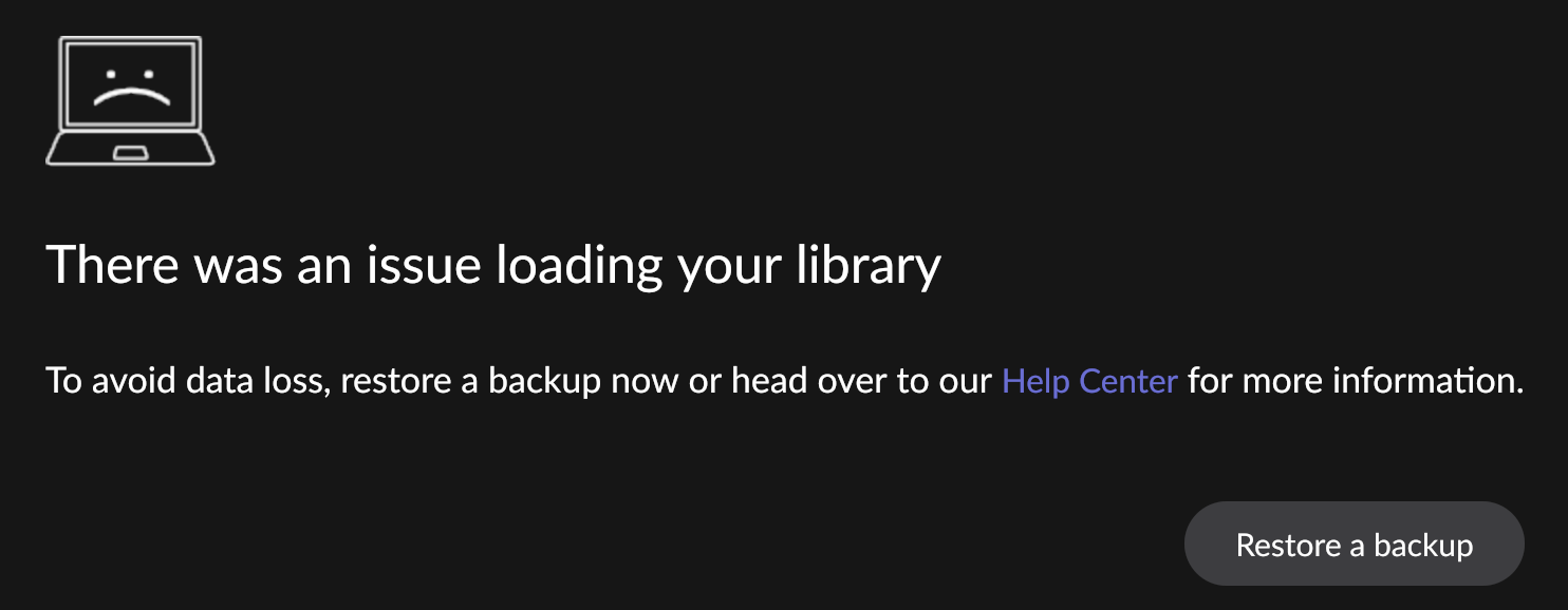

Running it on Ugreen DXP4800PLUS with 64GB RAM. Everything seems to work but backup. It is mapped but when it runs or I tried to run it manually, I always get this:
There was an issue loading your library
I can restore and old backup from the same location, but backing up to it does not work!
To get ROON running again without a useless restore, all I have to do is to go to Docker on Ugreen and restart Roon project or container.
Backup is mapped in docker compose as - /volume1/docker/RoonBackups:/RoonBackups
I have tried to restore the database, restart and tried to backup right away - still got the same error.

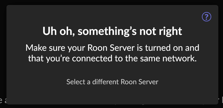

At this point, I decided to reload the Roon container and run manual again:
At this point, I have it running again and we can close this issue.
