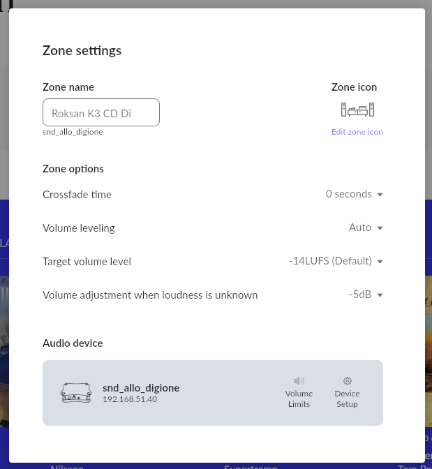

This is my Roksan connected to S/PDIF. Note that Roon sees the Allo DigiONE not the Roksan.

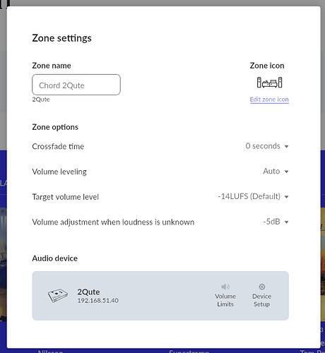

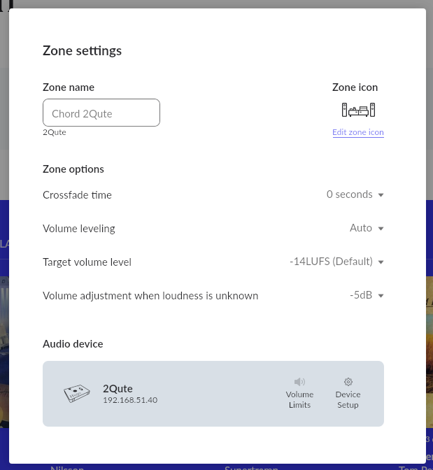

And, here is my Chord 2Qute, which uses the same transport (Raspberry Pi) but is connected via USB.
The 2Qute is not Roon tested, so I have used the Hugo, which is, for all intents and purposes, the same DAC.
