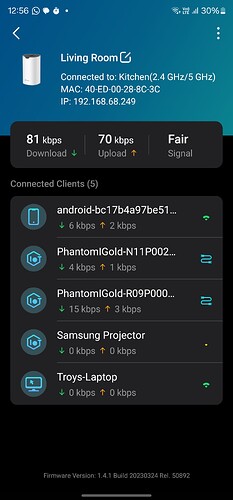

What was the result of looking into this? Can the devialet be found in your in your router admin panel?
The laptop and phone and speakers a appear on the mesh network. It’s confusing
Okay so in your picture I see 2 items labeled Phanthom1Gold. I assume these are the Devialets you are trying to find? If so we need to compare their IP addresses to the one for your laptop to see if they are on the same subnet.
Hmm, I think we are getting somwhere.
This is the IP situation
PC: 192.168.68.103
Phantom1: 192.168.68.101
Phantom2: 192.168.68.105
Well, all of those are on the same subnet. So let me consult with the rest of the team. I’ll get back to you when I have some next steps.
