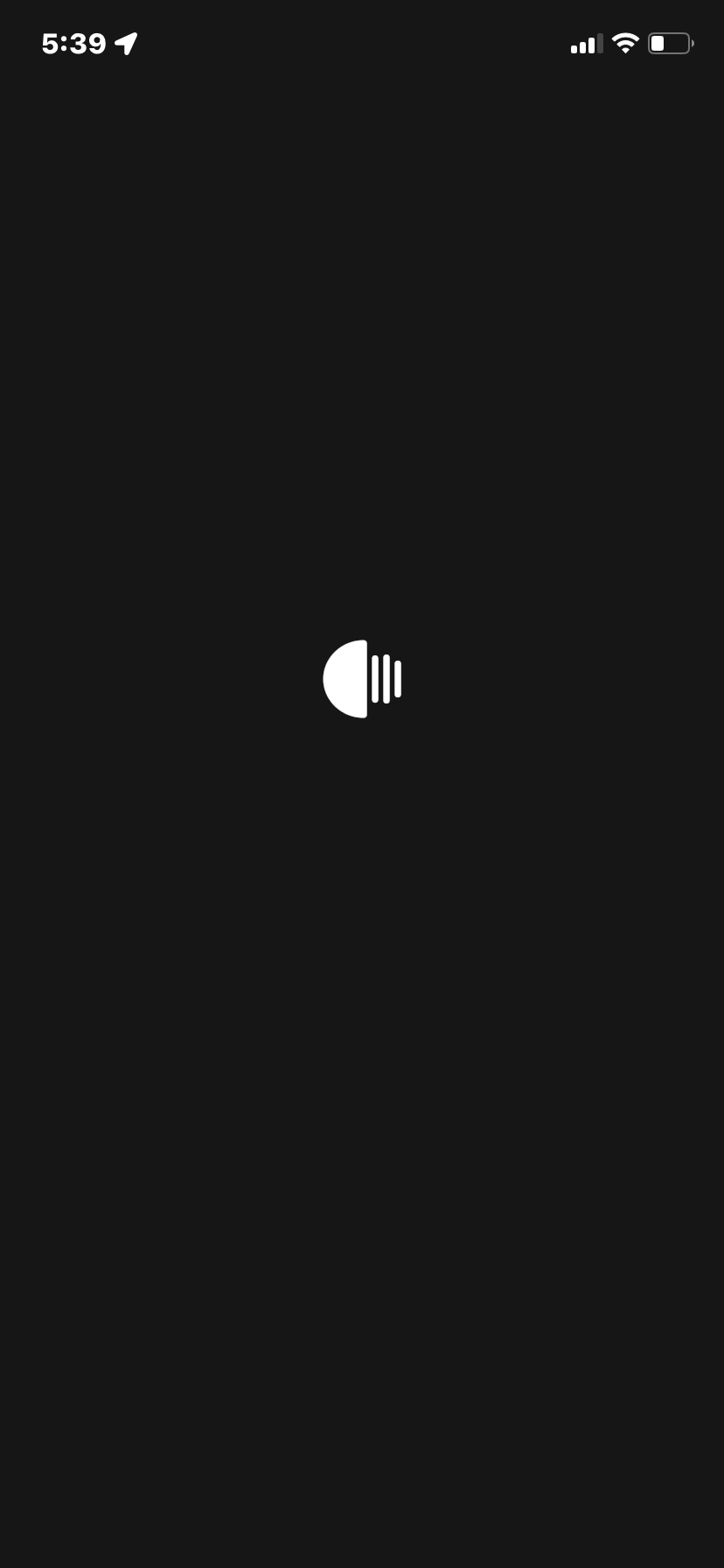

Everything was working fine then I updated Roon, since then I get the Roon symbol. I did restart several times, as well as press the reinstall os button on the settings page.

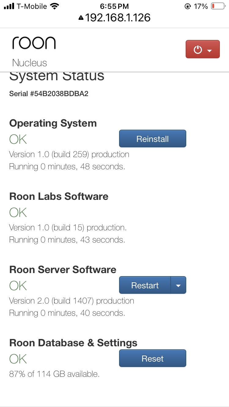

Thank you for the reports. What do you both see when you access the Nucleus Web Administration page from a separate browser?
Actually…I power-cycled the Nucleus and Roon returned to life. Thanks for checking with me. I hope Winter_Fleury has the same good fortune I did.
I was hoping to be so lucky, that something I didn’t try would just work. But it is not the case for me. My setting page looks the same as it always does.
