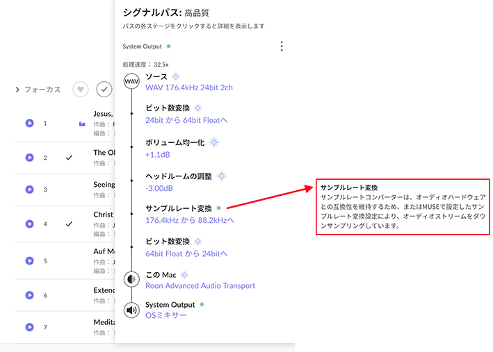

· サンプルレート変換について困っています。
· Roon使用中にサンプルレート変換が起き176.4Hz→88.2Hzとなってしまい困っています。ダウンサンプリングを防ぐ方法が分かりません。MUSEによる設定方法が分かりません。具体的に、どこから入りどの様に設定すればダウンサンプリングが発生せず176.4Hzのまま使用できるのか?教えてください。できれば操作方法の画像付きで教えていただければ助かります。よろしくお願いいたします。
Hello @YUTAKA_KUROSAKI,
Thank you for the screenshot.
The 176.4kHz → 88.2kHz sample rate conversion you’re seeing is not a bug in Roon and is not caused by MUSE.
It is happening at the macOS (CoreAudio) level, due to the output device’s sample rate setting.
As the message in your screenshot indicates:
Sample rate conversion is being applied to maintain compatibility with the audio hardware.
The audio stream is being downsampled to match the sample rate set in the OS.
In short:
  • Roon is attempting to output 176.4kHz
  • The macOS output device is fixed to 88.2kHz
  • macOS therefore downsamples the stream before it reaches the hardware
How to prevent downsampling and keep 176.4kHz playback
Method 1 (Most important): Change macOS Audio MIDI Setup
  1. Open Applications → Utilities → Audio MIDI Setup
  2. Select the output device used by Roon (System Output / DAC)
  3. On the right side, set:
  • Format / Sample Rate: 176,400 Hz
  • Bit depth: 24-bit or 32-bit
  1. Restart playback in Roon
Once this is done, macOS will no longer force downsampling, and the signal path will remain at 176.4kHz.
Method 2: Verify MUSE settings in Roon (for confirmation)
  1. Go to Settings → Audio
  2. Click the gear icon next to the affected device → Device Setup
  3. Under MUSE, confirm that:
  • Sample Rate Conversion is disabled
  1. Disable any unnecessary DSP options if enabled
(In this case, MUSE is not the cause, but it’s good to confirm.)
Summary
  • Cause: macOS Audio MIDI sample rate is set to 88.2kHz
  • Roon is correctly outputting 176.4kHz
  • macOS forces downsampling for compatibility
  • Setting the device to 176.4kHz in Audio MIDI Setup resolves the issue
If you’d like, please let us know:
  • The exact DAC model you’re using
  • Whether playback is via System Output or a direct USB DAC
We can then provide more device-specific guidance.
