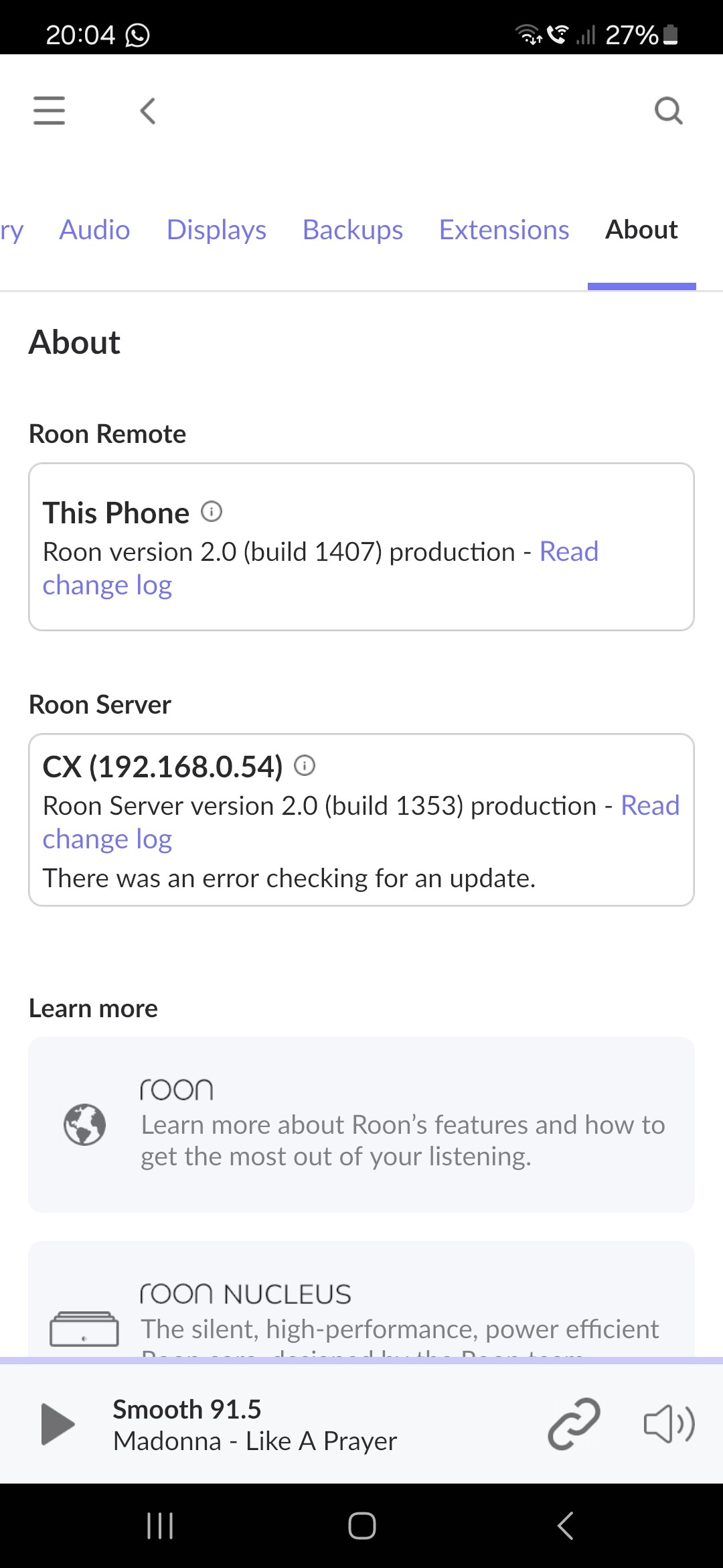

This is suggesting that the Roon version on the CX is older than your Galaxy and needs update.
Go to settings:about and you should see an option to update.
If not please take a screenshot shot of the version of it and your Galaxy phone.
Thanks for looking into this for me!

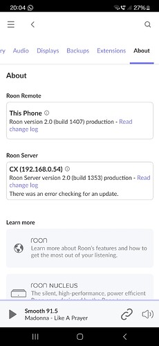

Yes it appears the Roon version on the phone is newer, but it does not seem to be able to download the update for the CX, see screenshot attached…
You will probably have to use the Antipodes gui to try and make the Roon update.
One trick I have used is to remove Roon from the antipodes and then reinstall it when it gets hung up like this.
