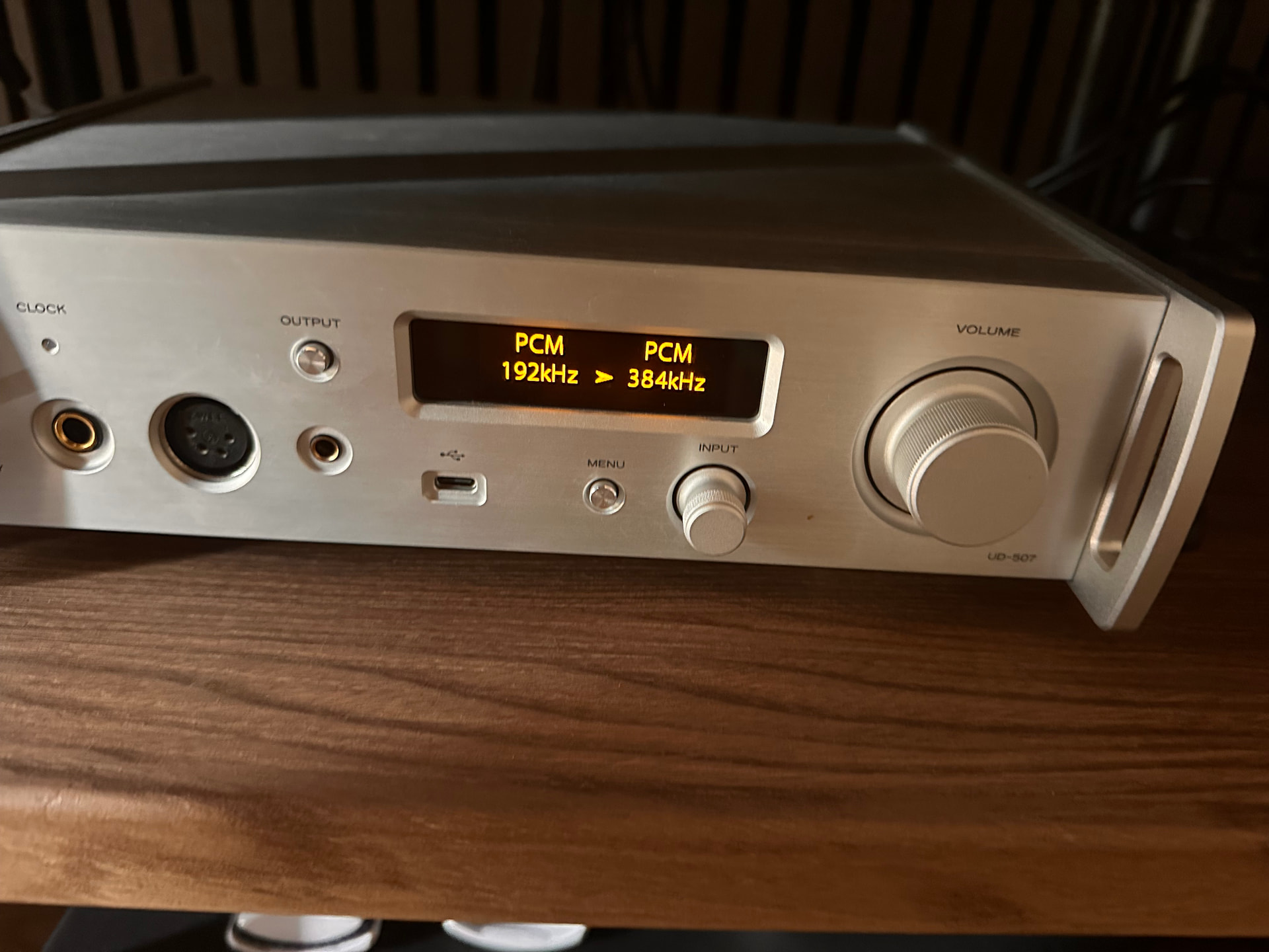

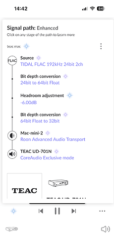

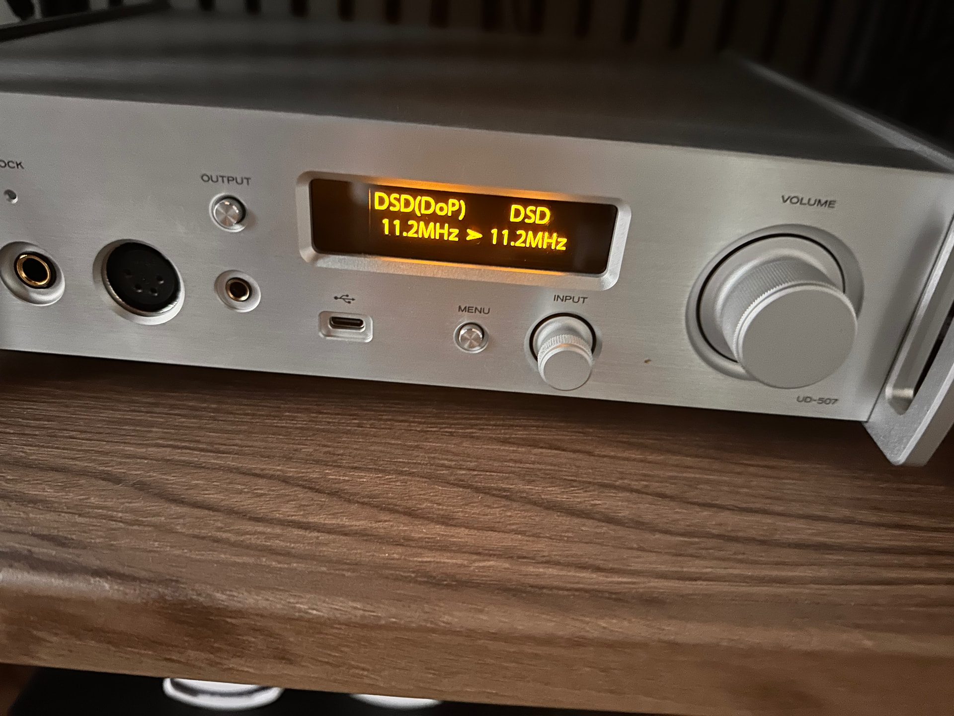

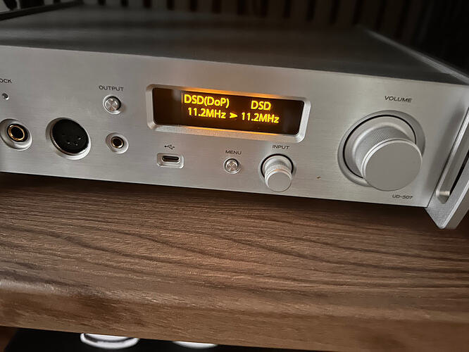

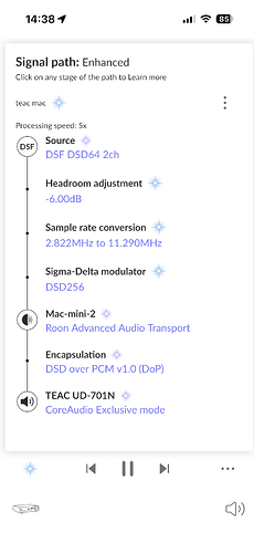

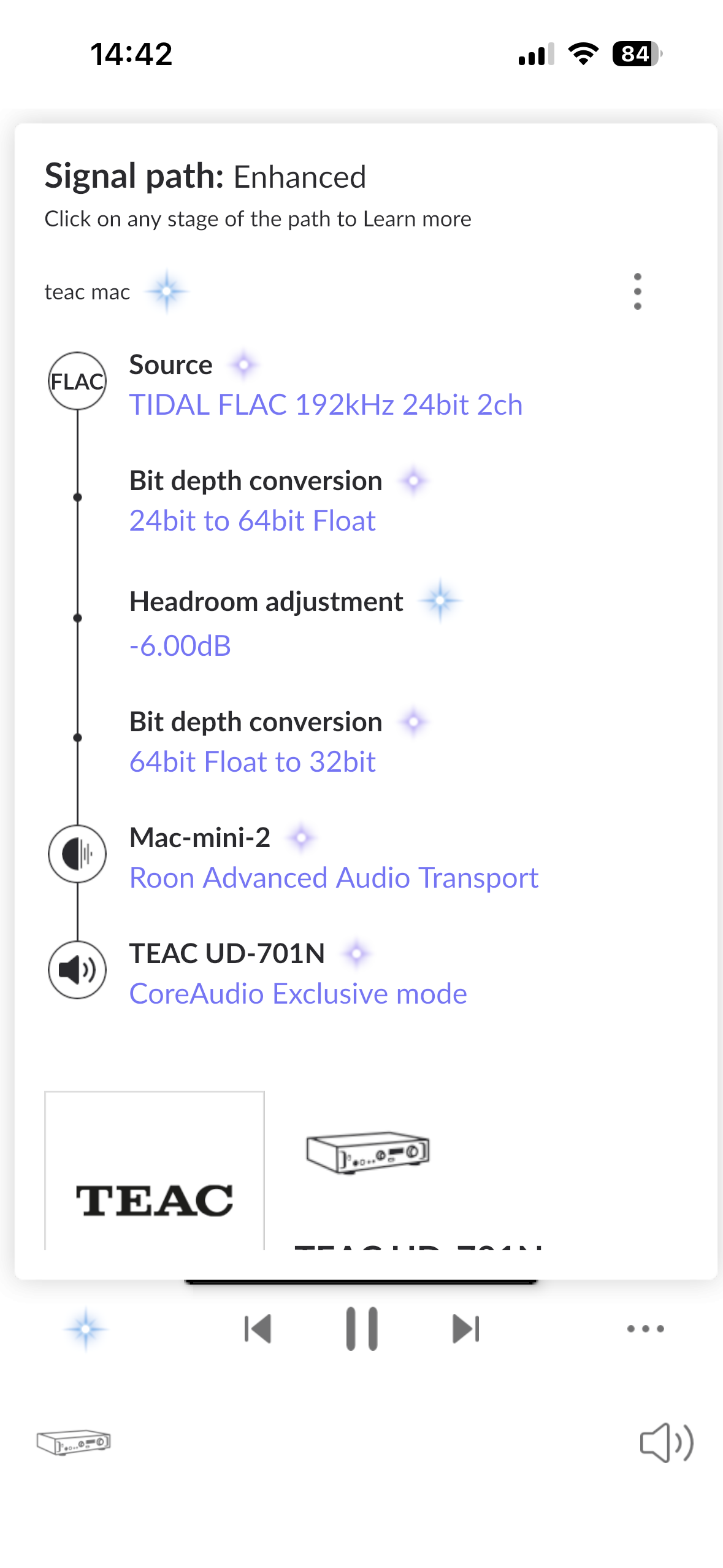

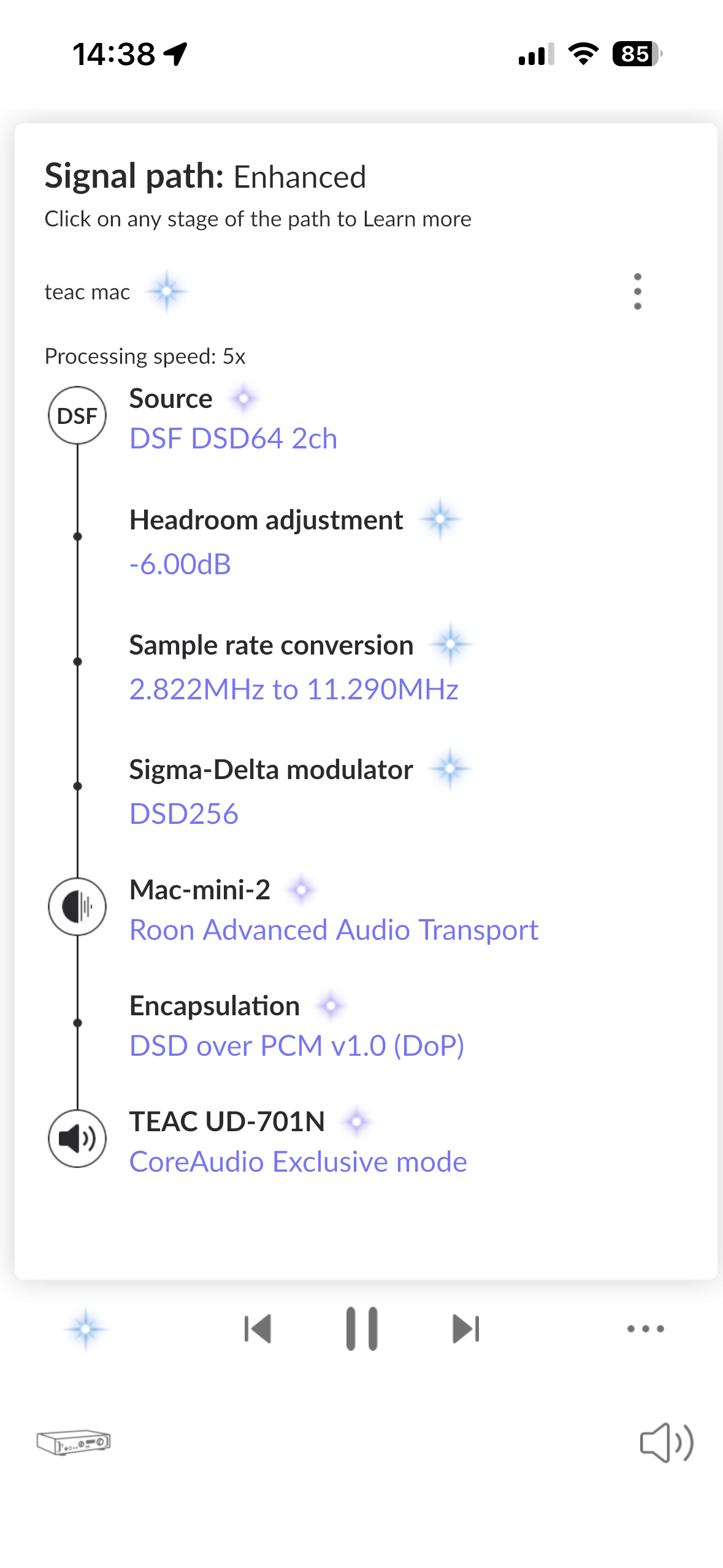

Here is mine playing DoP DSD256 without issue . Mac mini m4 with a Supra usb cable
And here is pcm

Do you have any idea why your UD-507 shows as a UD-701N in Roon?
Probably the same reason my Chord 2Qute is listed as a Chord Hugo… the exact model isn’t Roon Tested, and the alternative has the same specifications. @MarcMarc?
The images are of the UD-507.
