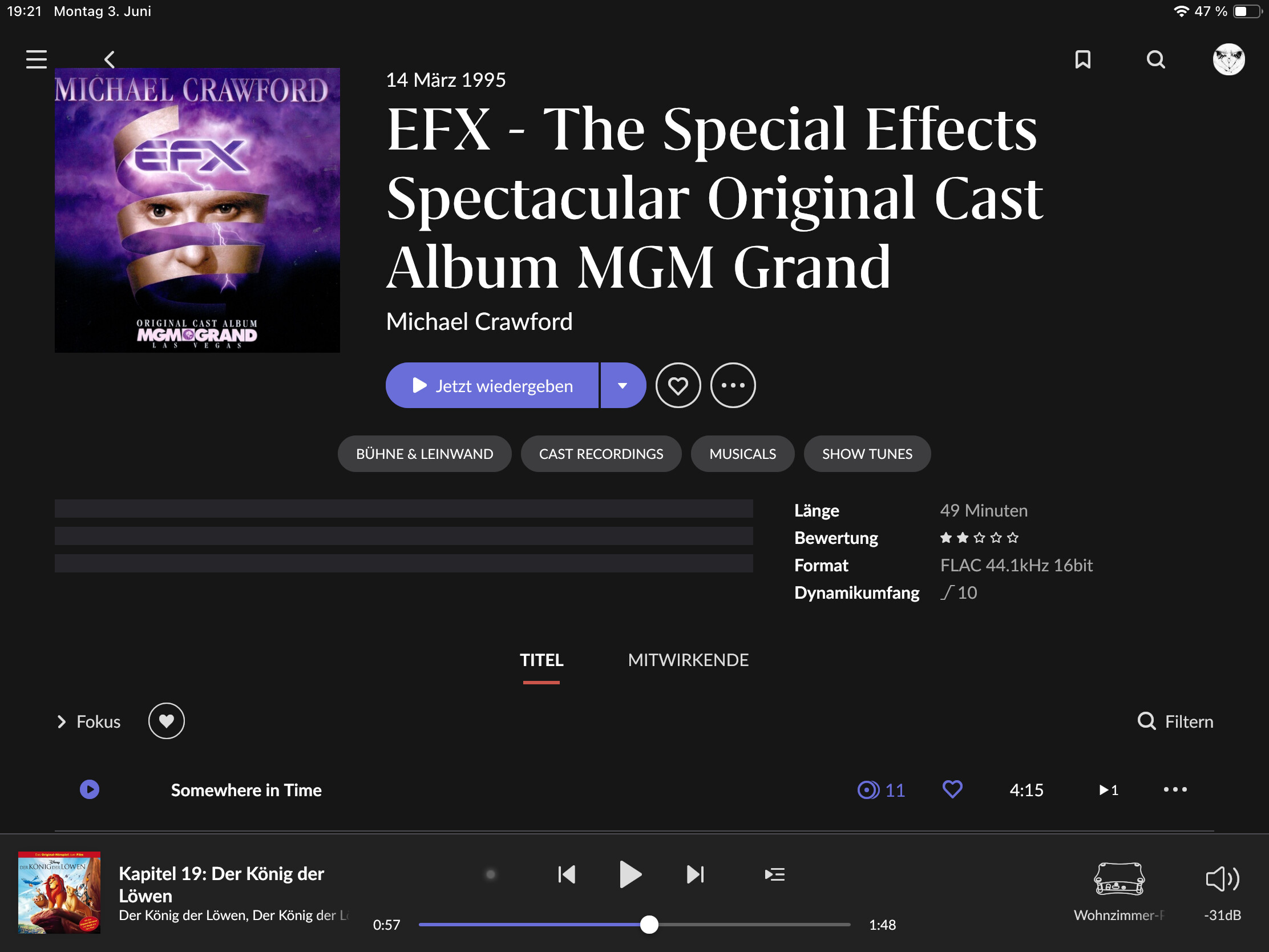

-Sometimes the Roon search takes an unusually long time and returns the error message in the screen shot (“Cannot connect to Roon search”)
-Relatively often the additional information about the album is not loaded in Roon, as well as the information when, for example, the album was added to the library (regardless of whether it is Tidal albums or albums on my server)

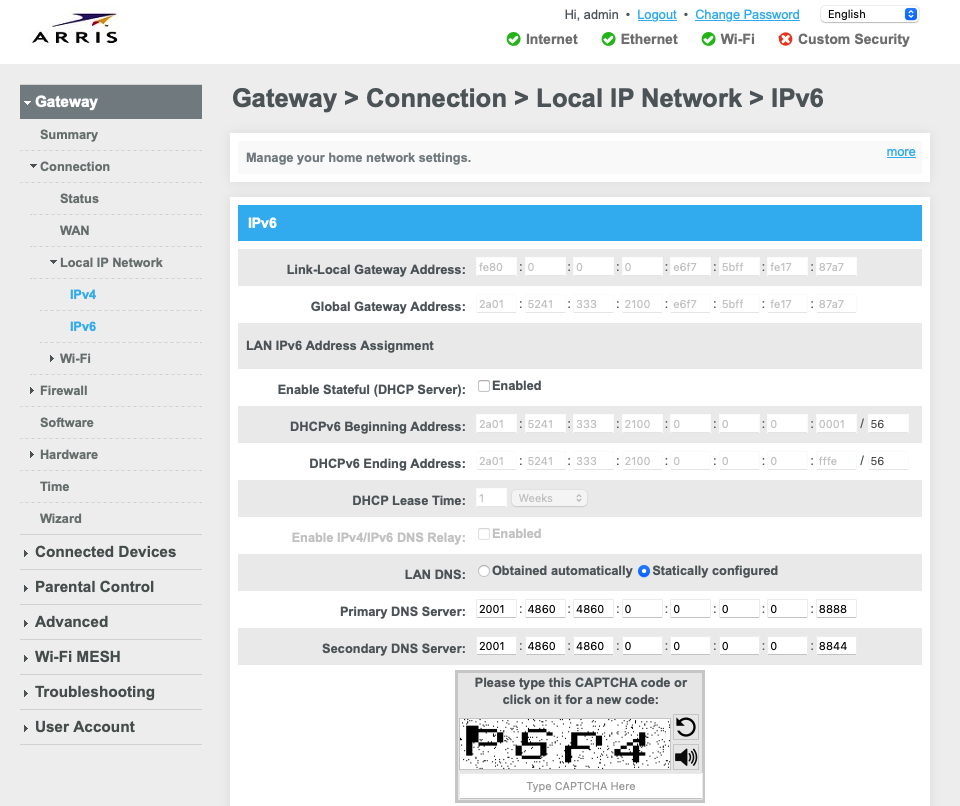

We have seen users have a better experience in the past if they change their Router’s DNS servers from the ISP provided ones to Cloudflare DNS, Quad9 or Google DNS. Can you please give this a try and let me know if it helps?
Dear @Daniel,
I have tried both Cloudflare DNS and Google DNS settings.
While I was changing the settings, the Roon server was switched off. When the router settings were finished, I deleted the Roon Server cache.
Unfortunately, the error persisted. There is no Tidal ↔ Roon synchronization.

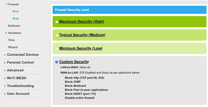

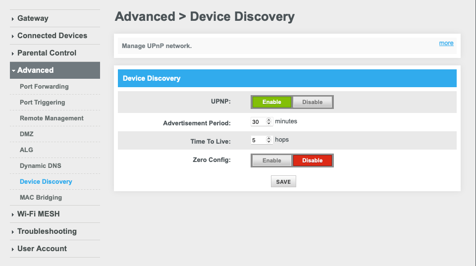

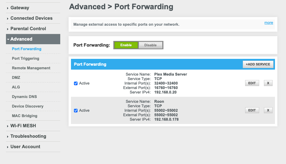

Below you will find the settings of my router:
