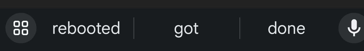

Ha! I ask so often that my my phone automatically suggests the words of
Have you …
