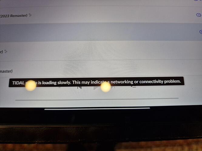

I'm having trouble connecting to Roon
Sometimes I can connect, sometimes I can't

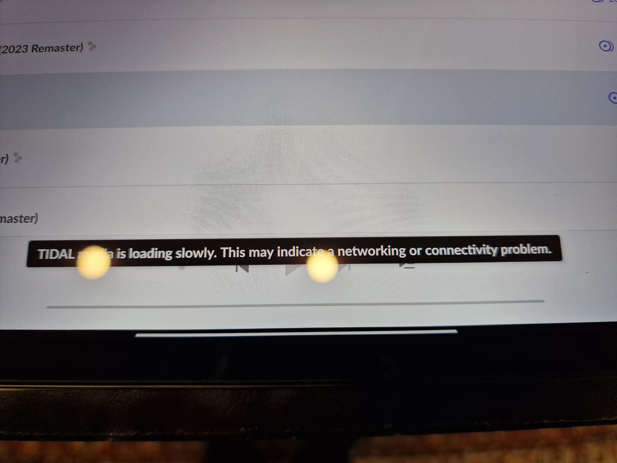

When I try to listen FLAC 192 kHz 24 bit I will gor this sentance: "Tidal media is loading slowly. This may indicate a networking or connectivity problem". Could this problem accure because of my too old year 2015 HP-computer, where the ROON-server is located. What is the minimum demands for ROON-server?

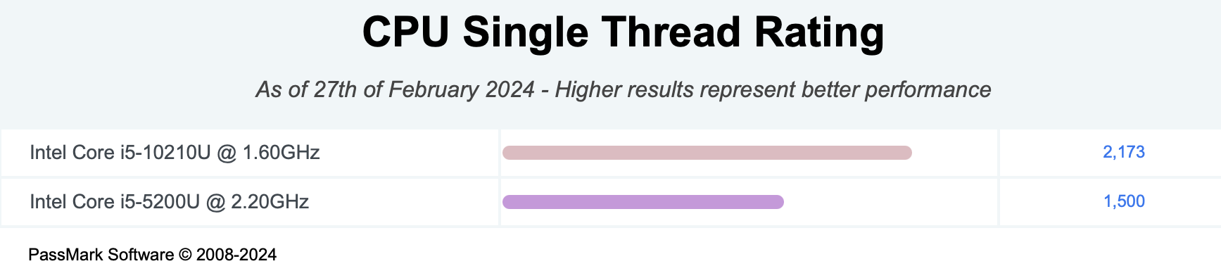

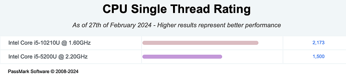

Thanks. The HP’s CPU is not the latest :wink: but on gut feeling I would have said it should be fine for straight playback of 192/24. I have a 10th gen NUC from 2020 with ROCK, and this is the comparison of CPU single core speed (the most relevant benchmark for Roon). Mine at the top, yours at the bottom:
So yes there is a difference, but nominally it’s just 30% difference and mine does not even notice the load caused by 192/24 playback. I would have guessed MUSE but you don’t use it…

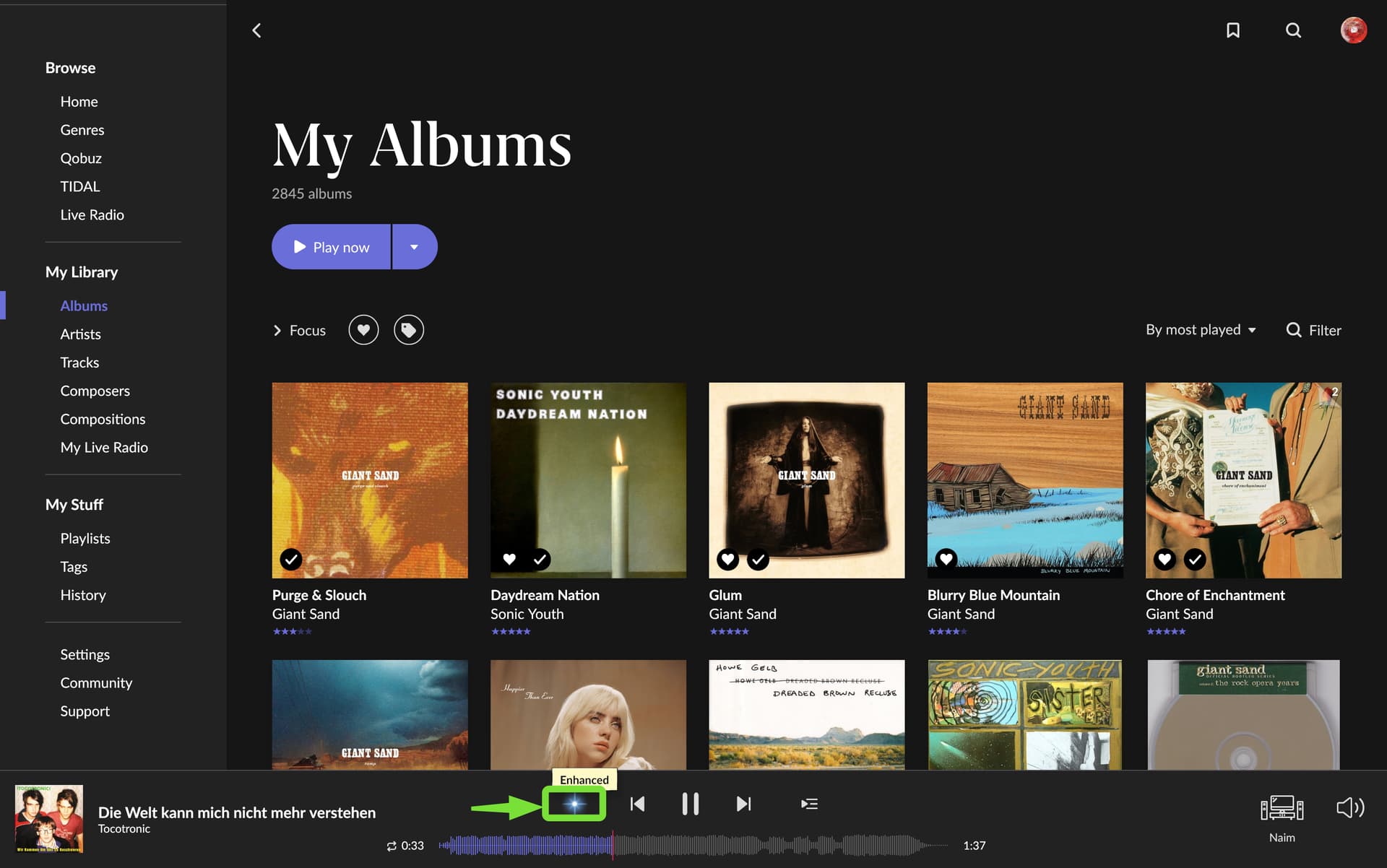

Can you post a screenshot of your signal path while you are playing 192/24, please.

It’s Roon’s Signal Path, you just need to click this little “light” on the play bar in Roon while you are playing:
It will tell us a little bit about the computer performance.

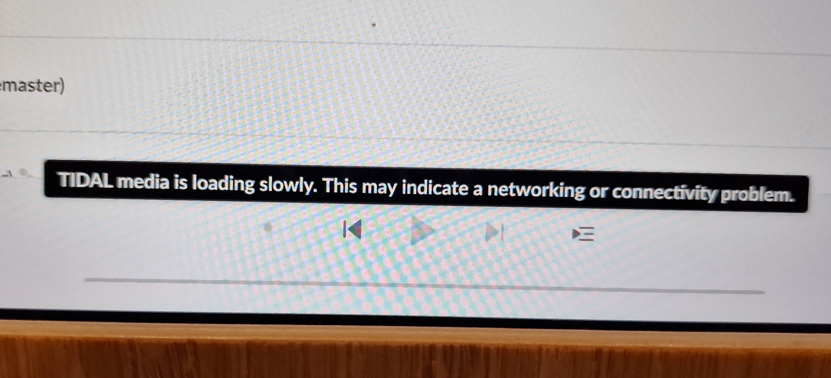

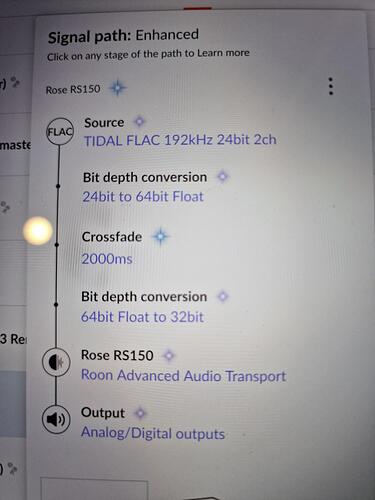

How, nice to see the signal path so easily :slight_smile: The small glowing light was Purple. But same problem, after start 192/24 stopped and informed me
OK, the signal path seems fine when it was taken. At this point, it did not display the performance indicator, meaning that performance was by far good enough, despite the small usage of MUSE for the crossfade.
It doesn’t look like the speed of the HP is your problem.
Which brings us back to whether the HifiRose is network-connected and whether this is by wifi, too.
