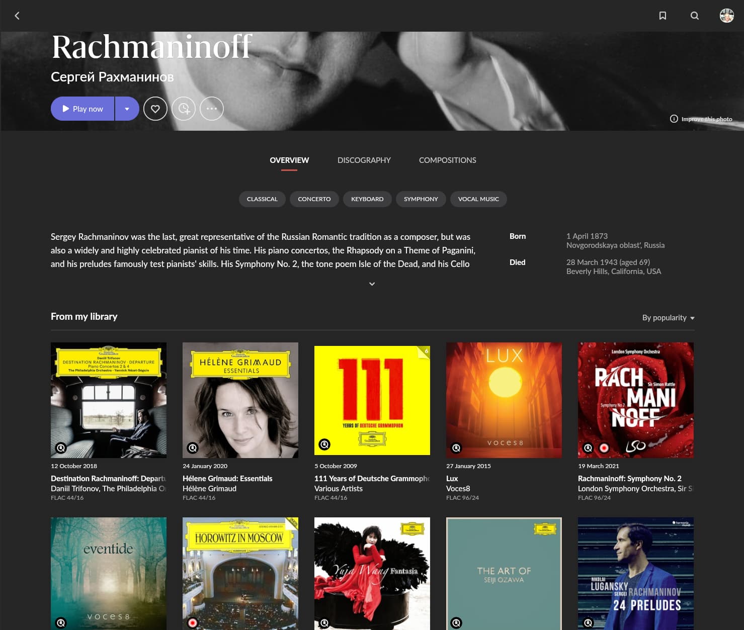

…are you saying that in the Composer browser, you are not seeing all the albums in your library with Rachmaninoff as a composer in the “Overview/From my library” section? For example:

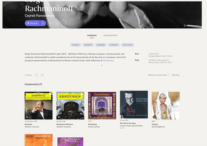

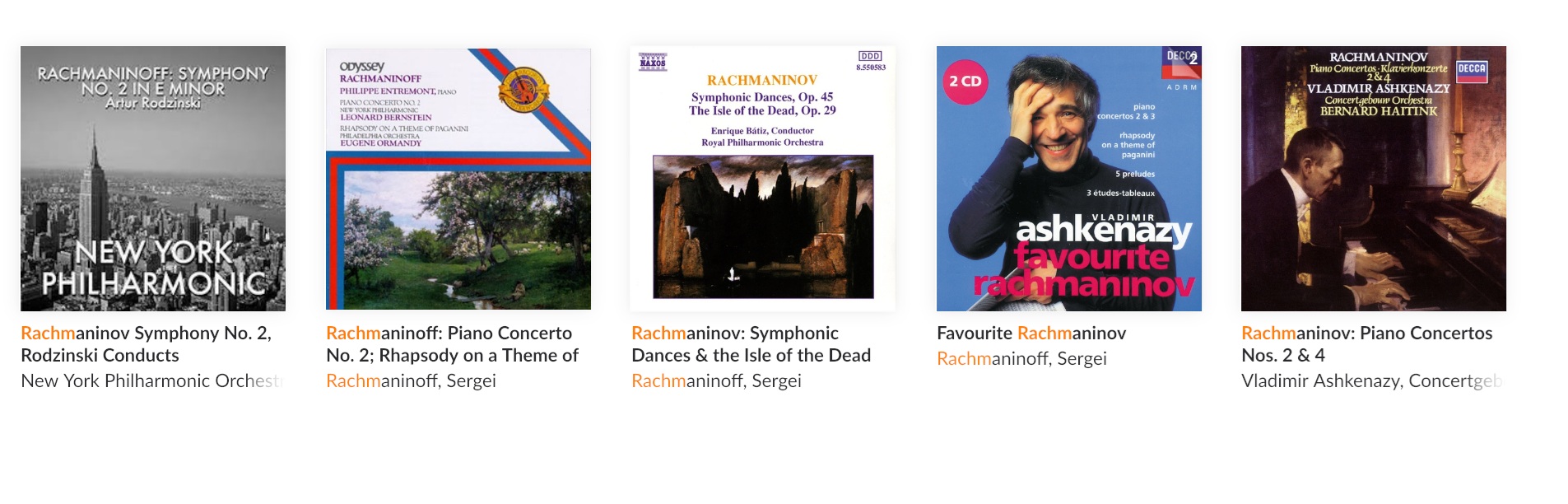

Hi…thanks for the quick reply. Yes, NOT seeing all albums under composer Rachmaninoff…see screen shot.
and here are the albums i have in the library that DO NOT show up under composer Rachmaninoff no matter what i’ve tried so far

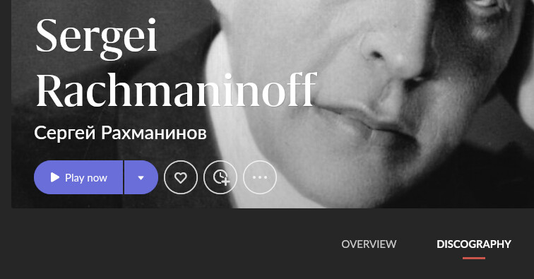

Not seeing Discography…that would be nice
If you don’t subscribe to a streaming service (e.g. Qobuz or Tidal) then you won’t see the discography tab, because this will display all albums associated with the composer or artist, whether you have them in your library or not; i.e. it is a full discography, not just the contents of your library.

I have approximately 40 albums under the Overview section of the Sergei Rachmaninoff page, and spot checking about 10 or so it appears that Rachmaninoff is a listed composer in the Credits Section under the album editor. While most of thee albums are classical, i do have a few that are pop (Sinatra’s Where Are You?) and rock (Dylan’s Shadows in the Night)., and in both those cases Rach appears as a credited composer in the album editor and also on the individual tracks on those albums. I’m not entirely sure that listing him as a composer in the album editor interface will do the trick, but give it a try.

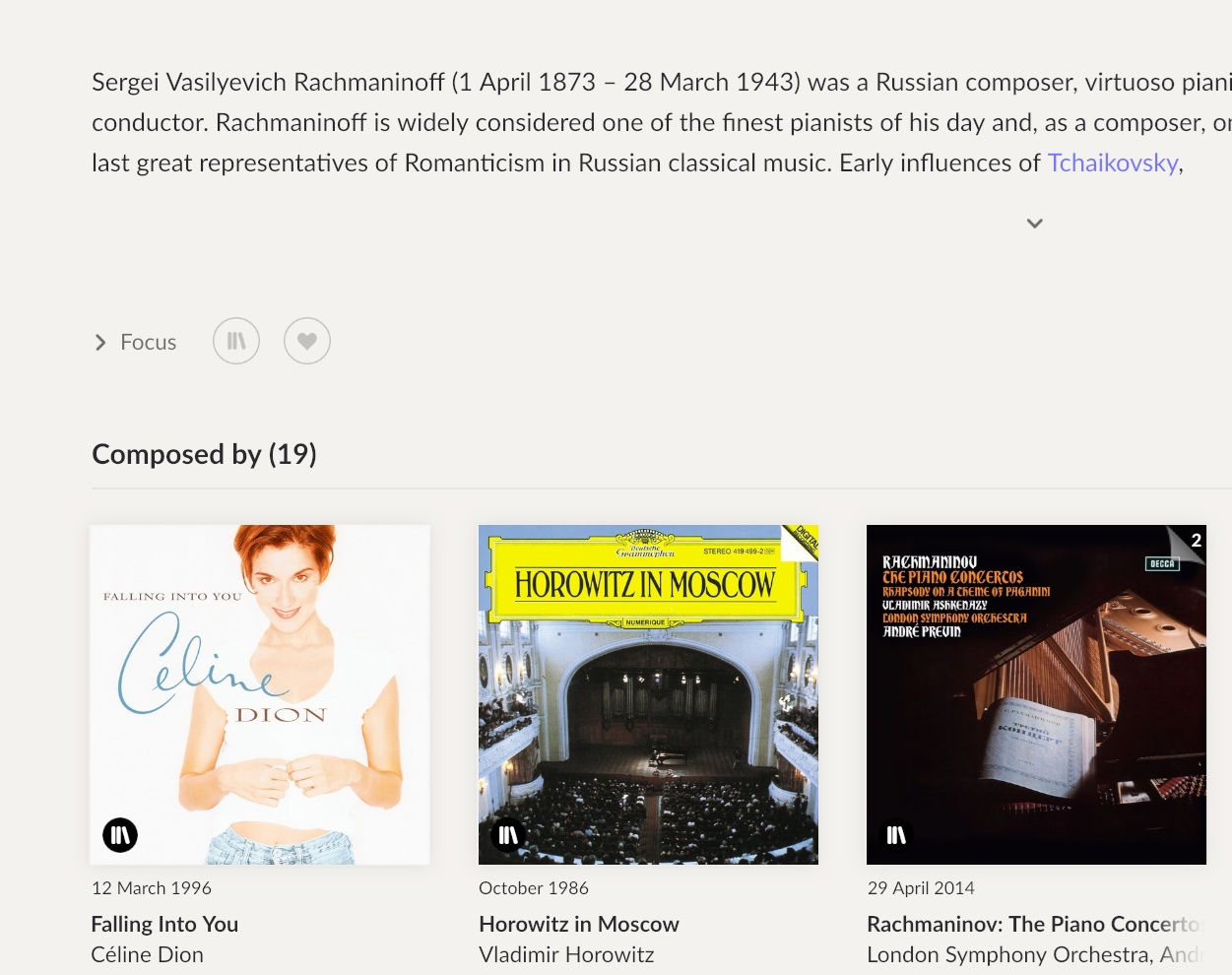

I’m going to do a redo of this library…all my classical composers are a mess. as example…JSB is listing some jethro tull, ELP, mike oldfield, george winston within the JSB Composers albums overview, with EACH Track on Aqualung thinking JSB is composer… I thought the purpose of setting “show composer credits” to Less alleviated this issue. Anyway, does anyone have any “Import” settings to change from the Default that might help Classical setup better? Thanks for your help!

Apperently, Sergei Rachmaninov is assigned as performer or primary artist with these albums (at least some) which will prevent roon from showing the album under ´Composed by´. This is presumably a measure to prevent albums from being shown twice on the artist page, but as Rachmaninov is long dead and not granted a ´Main albums´ or ´Appearances´ category, these albums are hidden.
Solution: Edit the credits of the affected albums, remove Rachmaninov from all entries as performer, editor, primary artist or album artist. Have done it numerous times. That can be done with a file tagger if the erroneous credits are originating from file tags, or in roon´s album edit option.
To identify all these albums, you might want to see album overview and select Rachmaninov in the Focus Filter section as performer.

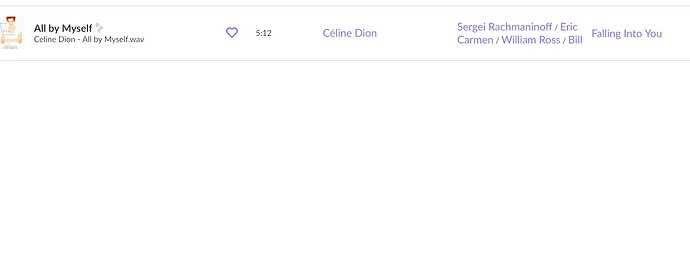

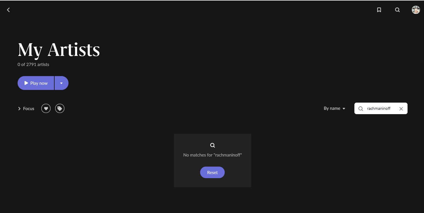

So, still have the one nagging issue. how to remove an Album from a Composers Overview when ALL Tracks have, through “Edit” removed reference to the Composer of that Track AND through Album “Edit” the Composer is removed as well. After doing this, and restarting Roon, the Album is still listed under the Composer
the second pic is to show that even after removing Rachmaninoff from the Track through Edit he’s still listed…confusing, sorry
