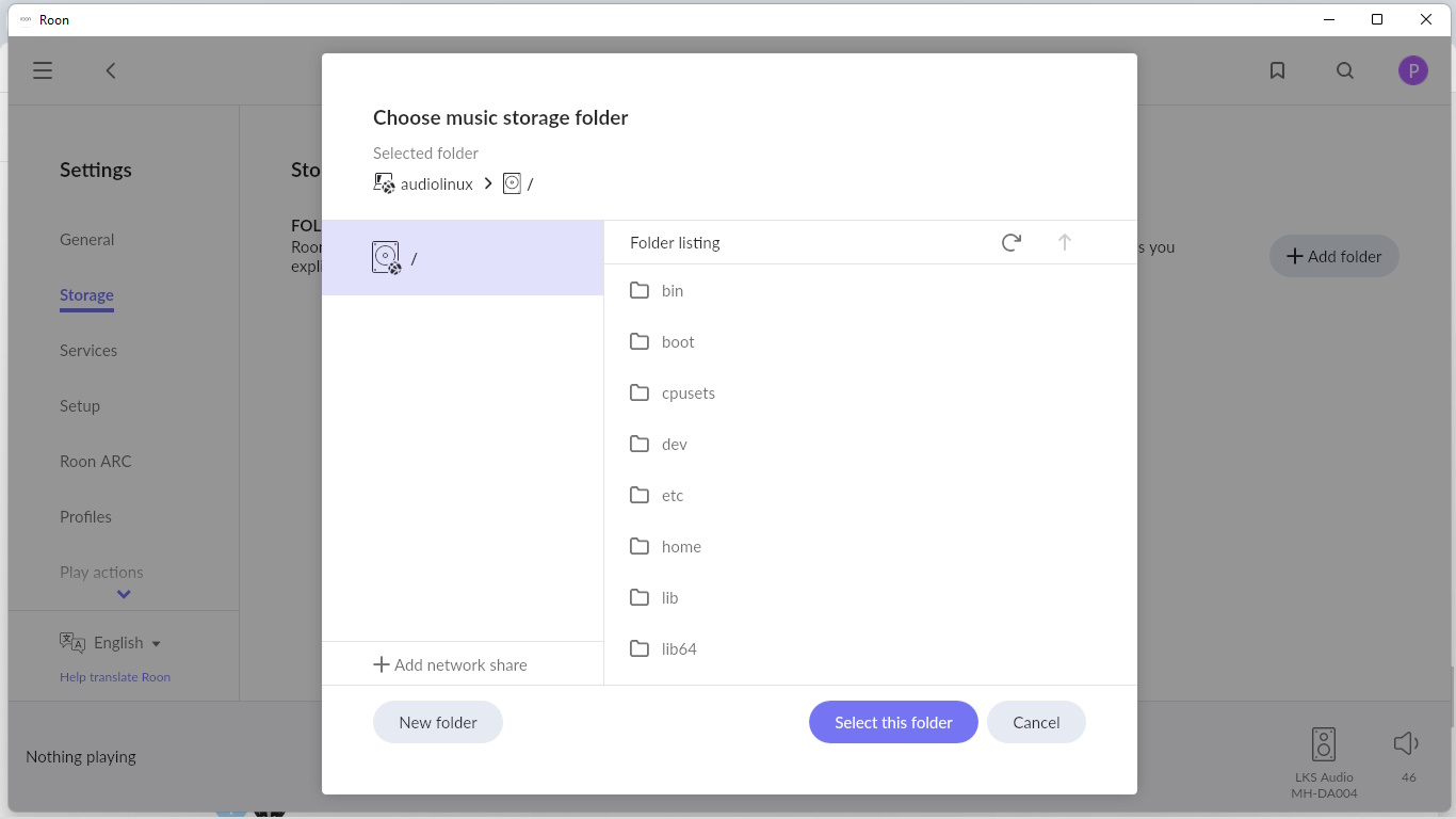

Problem scenario: I can’t find a way to ‘point to’ or access the SSD music catalogue? I only appear to be able to ‘browse’ to folders on the audiolinux USB pen drive? ROON doesn’t appear to automatically search for music files on my system? Which by the way are MP3 files. How can I resolve this issue please?

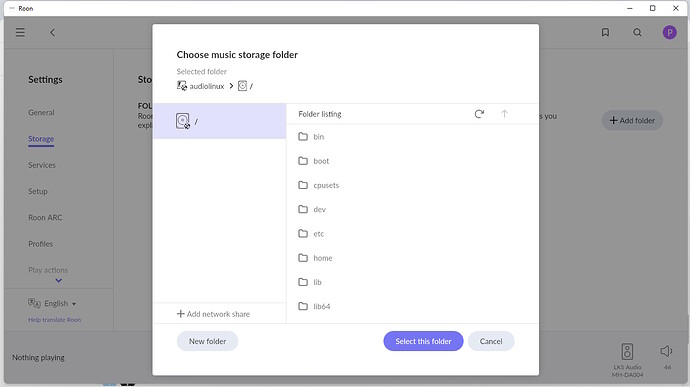

Go to: Roon - Settings - Storage - Add folder, to input your music location.
Go to: Roon - Settings - Audio, to look for your Roon endpoints.

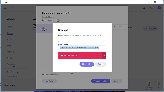

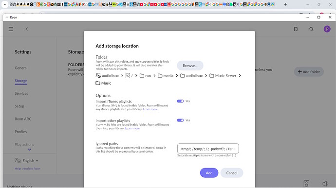

I tried to add network share: “computer:///run/media/audiolinux/music server/music”, but it didn’t work?
on the file manager in audiolinux the path is: “run/media/audiolinux/music server/music”

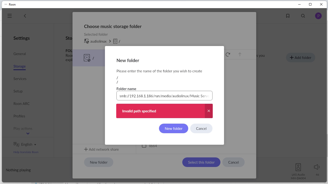

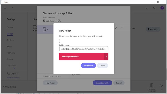

also tried add folder with this:
but didn’t work either?
You’re not trying to create a new folder. You’re telling Roon where to look for your local music files.
this also didn’t work?
I don’t know how to write the path correctly?
Can anyone suggest the path name?

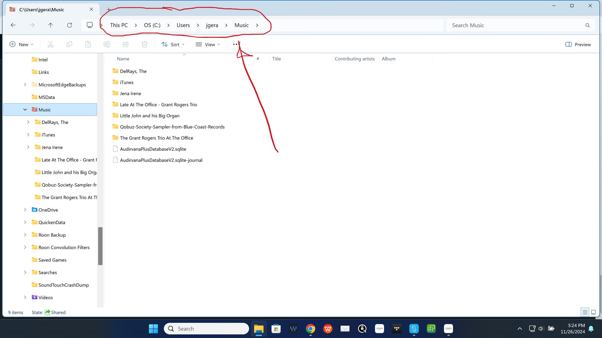

For instance, here’s the path to my handful of albums on my “away from home” Dell laptop Roon server. It’s probably C:\Users\jgera\Music
You should be able to navigate to it.

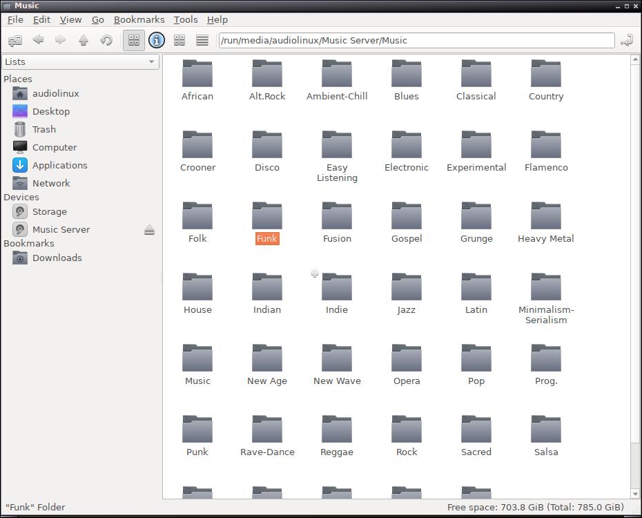

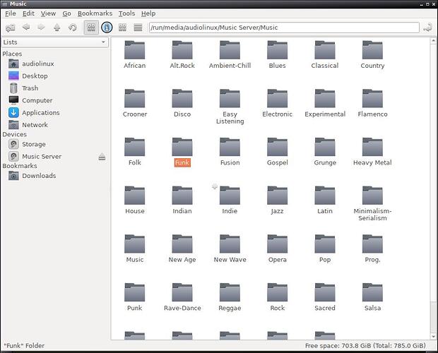

yes I can navigate to it on the server PC using the audiolinux file manager and the path given is: “run/media/audiolinux/music server/music”. But that doesn’t work (as is)?
how do i get to this: “run/media/audiolinux/music server/music”, which is on the server PC using the audiolinux O/S?
this is where the files are stored, but what do i do in ROON interface to ‘get there’?
Found it:
