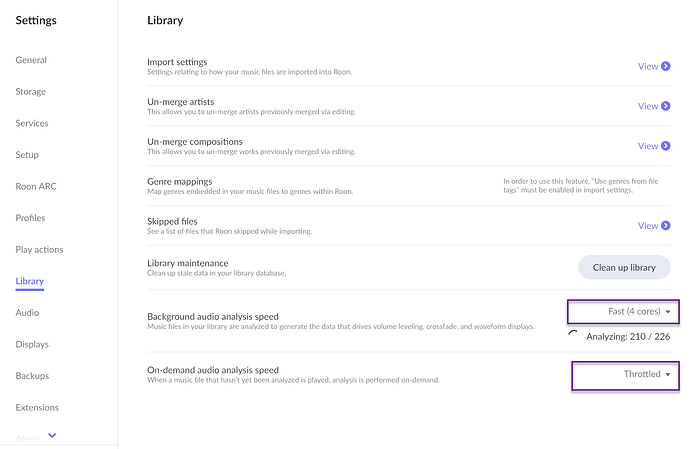

Will these settings make a difference?
By the look of this you are still analyzing the library 210/226 , if this is an existing library it is likely stuck
Reboot the server and it should clear.
Setting On Demand at the bottom my be better as Fast, if an album hasn’t been analyzed this governs how quick it’s processed , by throttling you may be causing the issue you are experiencing
