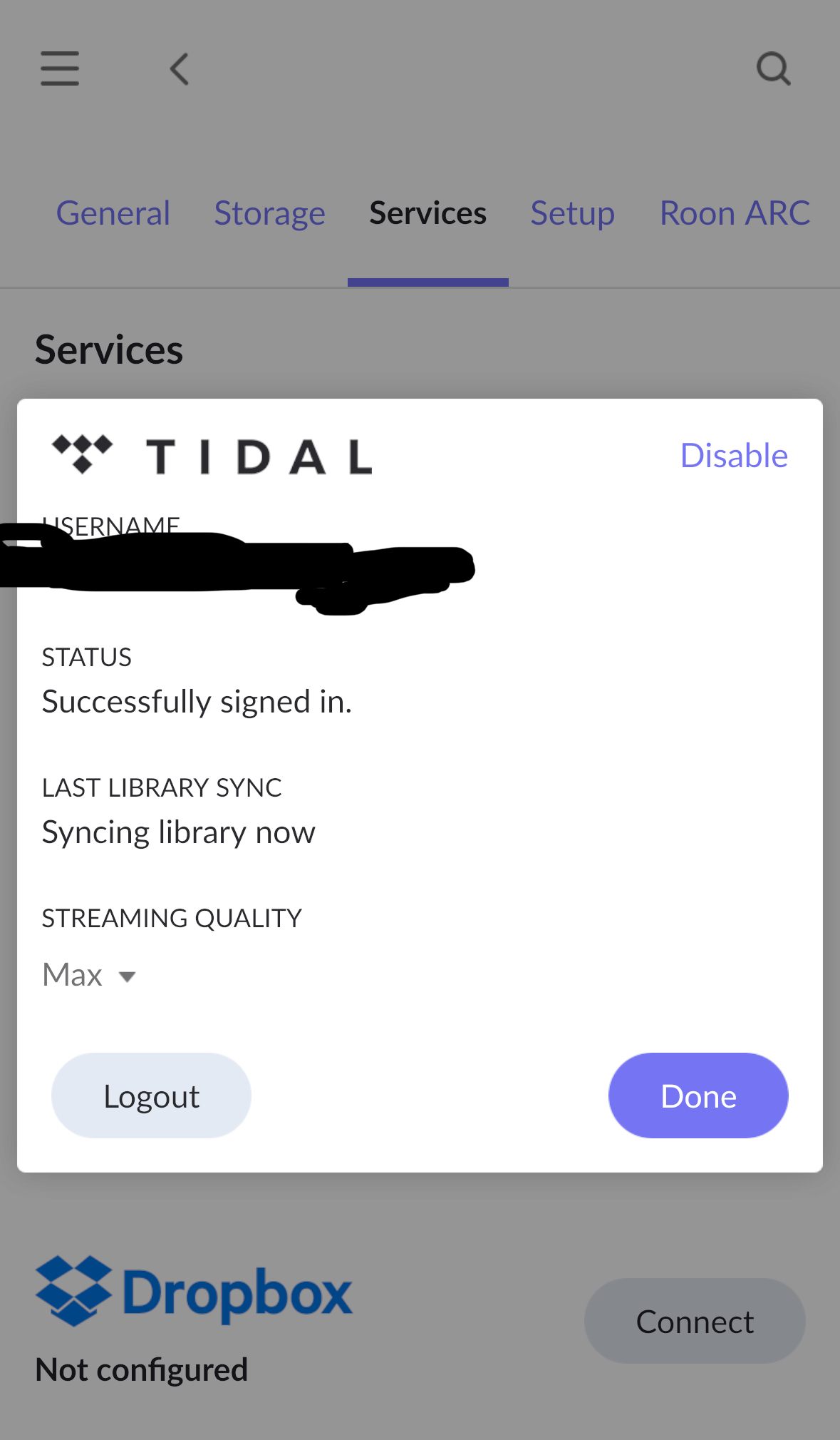

· I have problems with the tidal integration in roon even after switching to a roon nucleus one as a sever. The first issue is that when I connect with my account the syncing of the tidal library in roon is incomplete. Only a fraction of the albums are importet and then when I go under “services” and “tidal” it shows “syncing library now” indefinetly but nothing happens. Second problem is that I cannot remote tidal tracks or albums from my roon library. When I try it showes me a message saying “files cannot be found”. I tried to remove the track or album from tidal directly but then it stays in roon.

I initially didn’t restore a backup into the nucleus and just logged in with my tidal account, but then it only synchronized about 100 albums. I tried to log out, reboot the nucleus but didn’t have any effect. Then I restored a backup from my old roon nucleus. I tired the log out and reboot route again with no effect. My tidal library is very big but I cannot see exactly how many tracks and albums. I estimate it is around 1000-2000 albums. The sync never complete at all.
