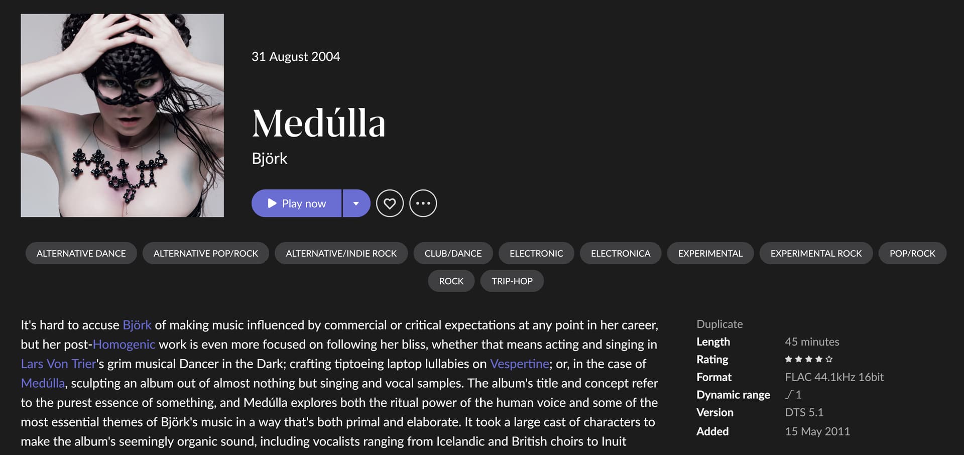

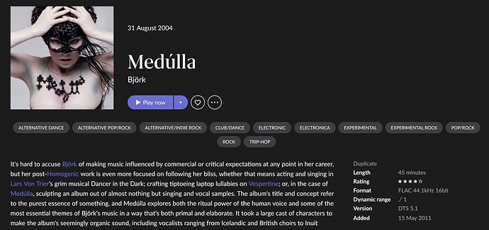

I used a commercial service to rip 100+ SACDs. These numbers are presented to me in my library.

I’m hoping someone can educate me here. How do you go from 16-bit/44.1k stereo to 24-bit/88.2k in 5.1 surround?
I realize things can be up-sampled but isn’t this just making stuff up? It’s not the original recording, so whatever it is, it’s data that has been fabricated, no?
Short answer: yes.
Long answer: You don’t lose any audible content when down-sampling DSD, but since the conversion changes the origila bits, it’s technically lossy.
I only have two SACDs which I ripped to ISO. I am backing those up, but my library only contains down-sampled versions.
I’m not assuming any deceit here, I’m just inquiring, being curious about the non-DSD rip. Up-converting the CD layer is easy, emulating surround not so much.
