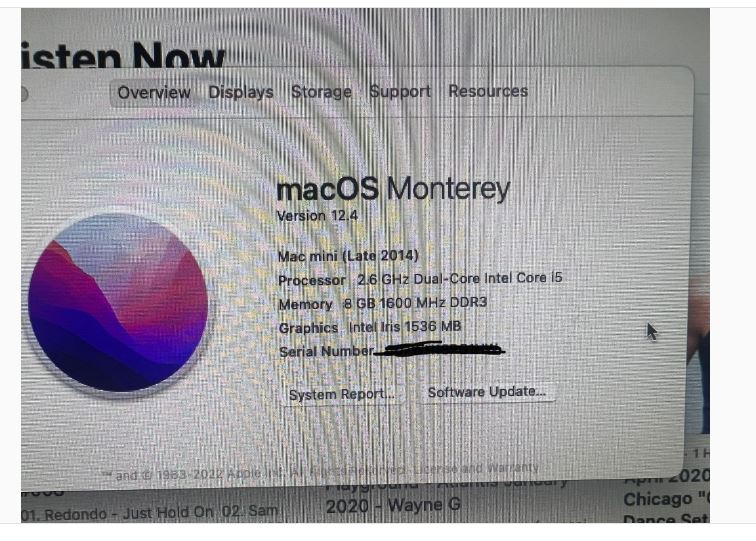

Yep, think the below will fit the bill. $250 including the key/mouse, 2014 model. Thanks @BCBC
What does your below mean?
No SSD startup drive just a 1TB HDD. Roon will not work well without SSD as startup drive.
Possible to boot from an SSD in an external case though.
Ooh; great catch @BCBC . I would have bought this. Don’t want to mess with , yet another gizmo for correct start up drive- grateful thank you!
Often the older Mini servers have both SSD and HDD installed or the previous owner had the HDD replaced with an SSD. Still, nothing older than a 2012 Mini.
Sure it will. Lots of folks are running on even older Mac Minis. in 2018, I was running on a 2010 Mac Mini with no SSD whatever. Heck, right now I run my Core on an underpowered NAS with no SSD drives in it. Roon recommends having an SSD drive for the database, but it’s not a requirement, and even that can be satisfied with a thumb drive in one of the USB slots.
Where do these mythologies come from?
From the Roon Labs website.
It’s not a mythology it’s the recommended specification it’s not good to recommend a system that is knowingly under the minimum.
What is the real-world downside to the above mini as seen in my snips, with HDD only (if I don’t want to mess with a side-boot SSD)? I really like this guy’s deal, because he throws in a key/mouse. It’s a 2014 model.
Personally, I haven’t seen a downside. “Recommended” is not the same as “required”. I don’t do a lot of fancy upscaling or DSP, and I don’t play much that isn’t standard CD format, so there’s not that much going on on my Core.
If I do see a downside, I’ll add an SSD. But so far that hasn’t been necessary.
So not the same as my use with DSP and multiple endpoints. I agree with ged, why invest in a system that doesn’t meet minimum requirements.
Appreciate the dialectic, Gentlemen!
