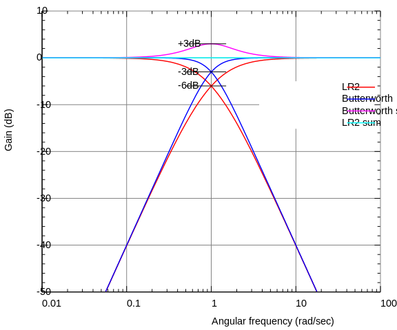

Can you or anyone educate me on what purpose the high-pass filter serves? If the crossover only sends frequencies below a set level to the sub, what’s left for a high-pass filter to do?
My limited understanding is that to create a smooth response, you don’t want high pass and low pass set at the same frequencies. Because it’s not a cliff edge/brick wall, you need a gap between the two so that they gently roll into each other. Not sure if that makes sense! :slight_smile:
The LS60 low frequency response is still only 6dB down at 26Hz, according to KEF’s specification, so a high pass filter is needed provide bass roll-off from the LS60 speakers, otherwise they would be adding to the subwoofer output and potentially a smooth response would not be obtained.
Secondly if the low-pass and high-pass filter are based on Linkwitz-Riley designs, they will both have −6 dB gain at their design cut-off frequencies. This means that, upon summing the low-pass and high-pass outputs, the gain at the crossover frequency will be 0 dB, i.e. a flat response through the crossover region.
This also means that the -3db points will be slightly apart, as in the 65Hz High-pass and 47.5Hz low-pass automatically assigned for the LS60 Wireless and KC62.
This is explained in more detail in this Wikipedia article:
Would this pertain to the type of amp & subwoofer being used?
Some amps have a sub out and a RCA sub input on the subwoofer. Then this Linkwitz-Riley filter would then seem to apply.
However for some subs they are connected via the speaker out of the Amp and then to the speaker input of the sub and from the speaker output of the sub to the speaker. In this scenario the sub would filter out the low and pass the high onto the speaker.
–MD
If we take the case of the LS60/KC62 combination, KEF is fully aware of the frequency responses of both products, and can therefore tailor the high-pass and low-pass filters accordingly.
In the second case you mention, the subwoofer designer is generally unlikely to know what speaker the high-pass crossover filter built into the subwoofer is being designed for, so will incorporate a generalised high-pass filter with variable controls, so that the user can adjust to achieve the best-sounding result.
