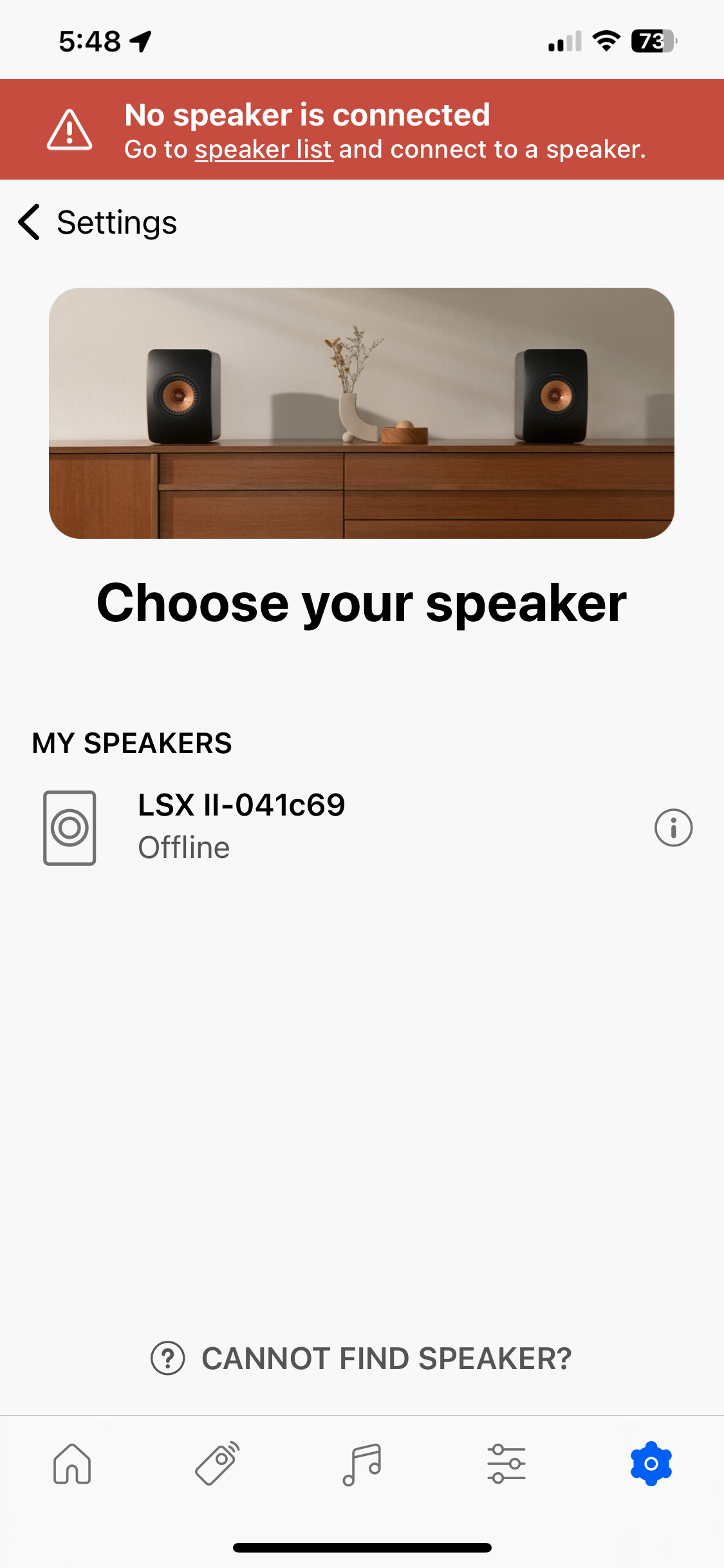

They do sound great, but only problem I have I can’t connect them with Ethernet cable to my network. They only work with WiFi which sometimes is dropping. Anyone have idea ?

Yeah, I prefer everything to be Ethernet. Everything is working perfectly on the wire (many things), but Kef speakers is the first one to not working.

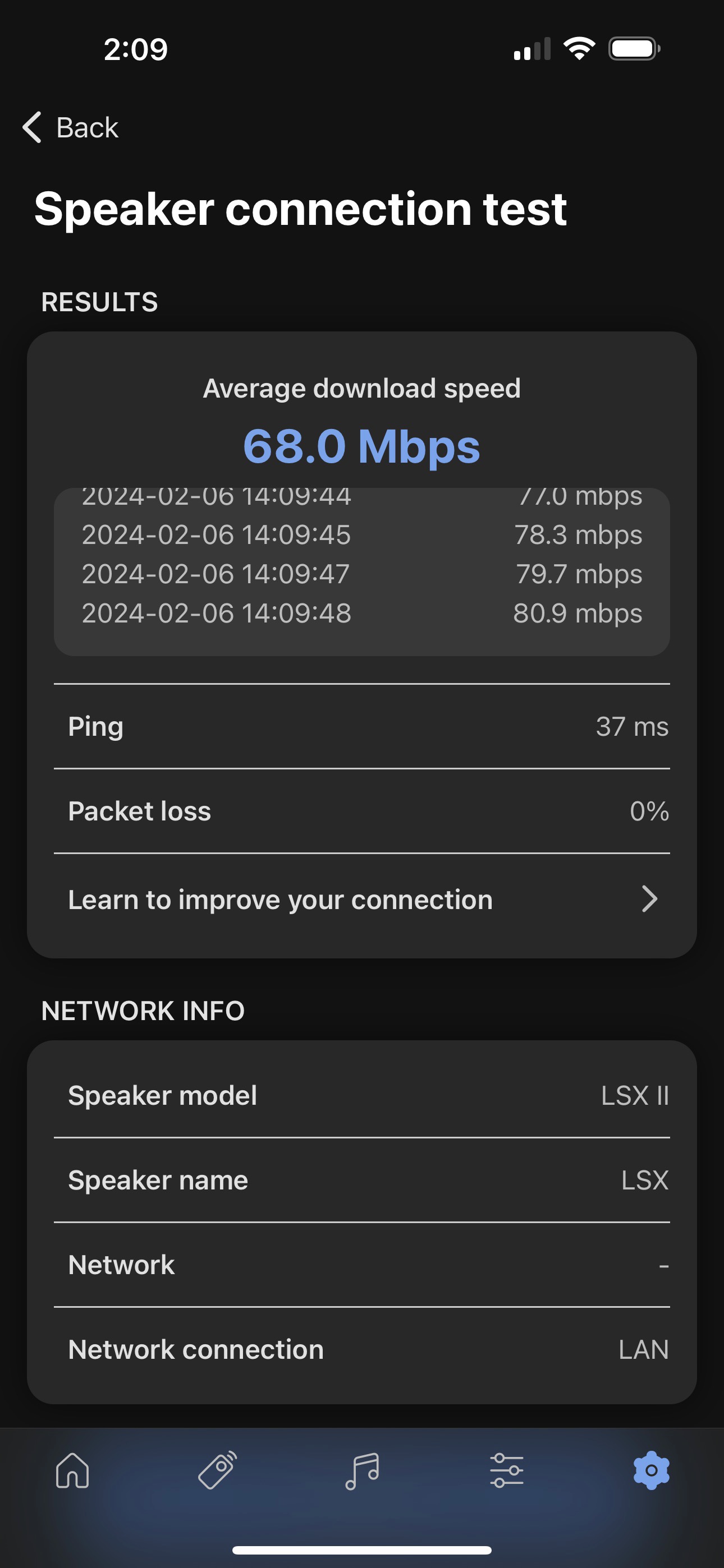

Mine didn’t work on ethernet either - At first.
I plugged in the ethernet cable and the music stopped.
Roon could no longer see them and the KEF app showed they were not connected.
After about 5 minutes they appeared in Roon again and are working via ethernet.

Have you tried restarting your router after connecting via ethernet?
I just did connect the wire and speakers disappeared from network.
Restarted the entire network, and still no Kef speakers on the list on the Kef app.
I have many things connected via Ethernet, and same the transition from WiFi to cable is seamless on all the devices.
Have you tried unplugging the KEFs?

Yes I did that, and still the same.
As soon as I disconnected the Ethernet, they came back via WiFi right away.
I will try to do factory reset, and start from the beginning.
Wery weird.
I’ve connected mine via ethernet before I even turned them on for the first time and they immediately worked.
I also did that, but it didn’t work. I lefted for a long time, and couldn’t find the speakers. Then I unplugged the Ethernet, and WiFi worked immediately.
Did you try to connect a different device to the same ethernet connector, just to check the connection is OK?
And - please excuse the very stupid question - did you use the correct RJ45 connector on the speaker, i.e. the yellow one?
Yes I tried 3 different devices and works perfectly. And I did used the proper RJ port.
Will try to factory reset and start over.
