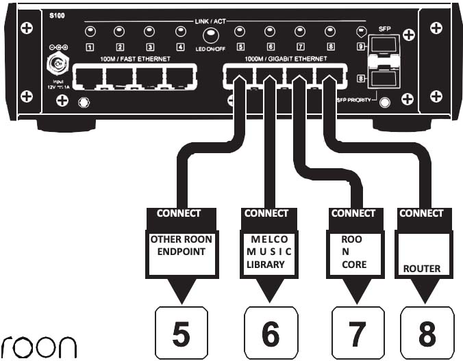

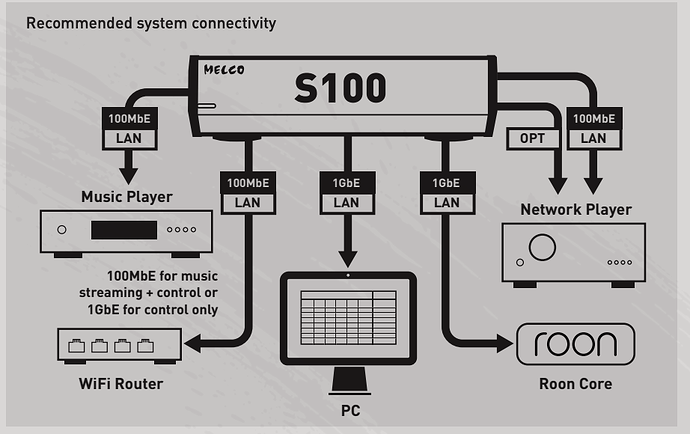

Please note the recommended configuration from the S100 manual. This audiophile switch will be prioritizing throughput over upstream connectivity on certain ports; there may also be filtering on certain ports that is causing small amounts of packet loss to accumulate, affecting higher-quality streams.
I recommend trying this, which places the router and endpoint on the 100M port.

Note that on the Melco FAQS there is an entry for configuring the S100 and they are describing a recommended configuration when using Roon.
let me add the way to their FAQ FAQs - Melco Audio

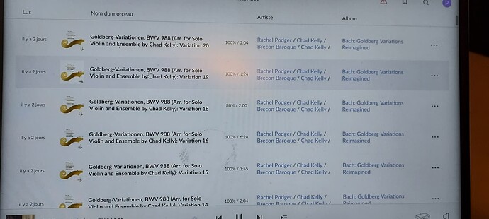

Hello Connor. i made the configuration change on friday and during played local and qobuz all FLAC resolution a whole day i was only able to see one track being shortened (see attached).
by the end of the day i realized i made a mistake having the router on 1Gbits port and Roon Core on 100Mbits port (cables are sale model).
since i have corrected (So Roon server on 1 Gbits port and Router and Roon End point on 100 Mbits ports, system was up and running friday night, Saturday all day and Sunday all day and i was not able to detect any track skipped, stopped or shortened. The system is very reactive and the track/Album transition are instantaneous.
