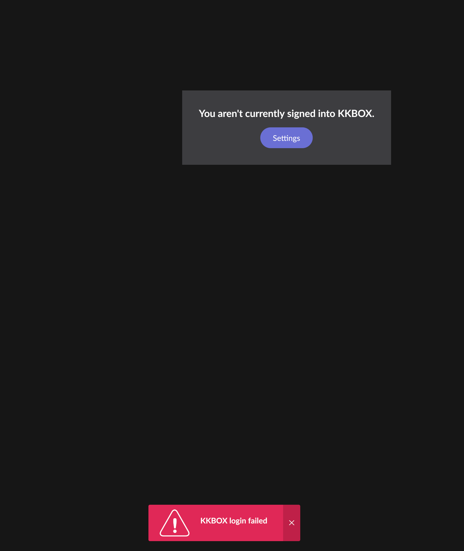

KKBOX unexpected logout, I am a lifetime Roon user and also a KKBOX user [moderated - email address removed], I recently got couple times expected logout by KKBOX , please help.

Various logouts today and yesterday. I have no precise info when they occurred. Core=Nucleus. Remote= Iphone pro max 12. Issues took place at home and away using ARC.
I will not use KKBOX via Roon right now, because logouts happen too often (minimum 5 times a day) and simply make KKBOX via Roon unusable.

All logouts occurred without any VPN.
Logouts happened with any remote I used.
