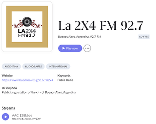

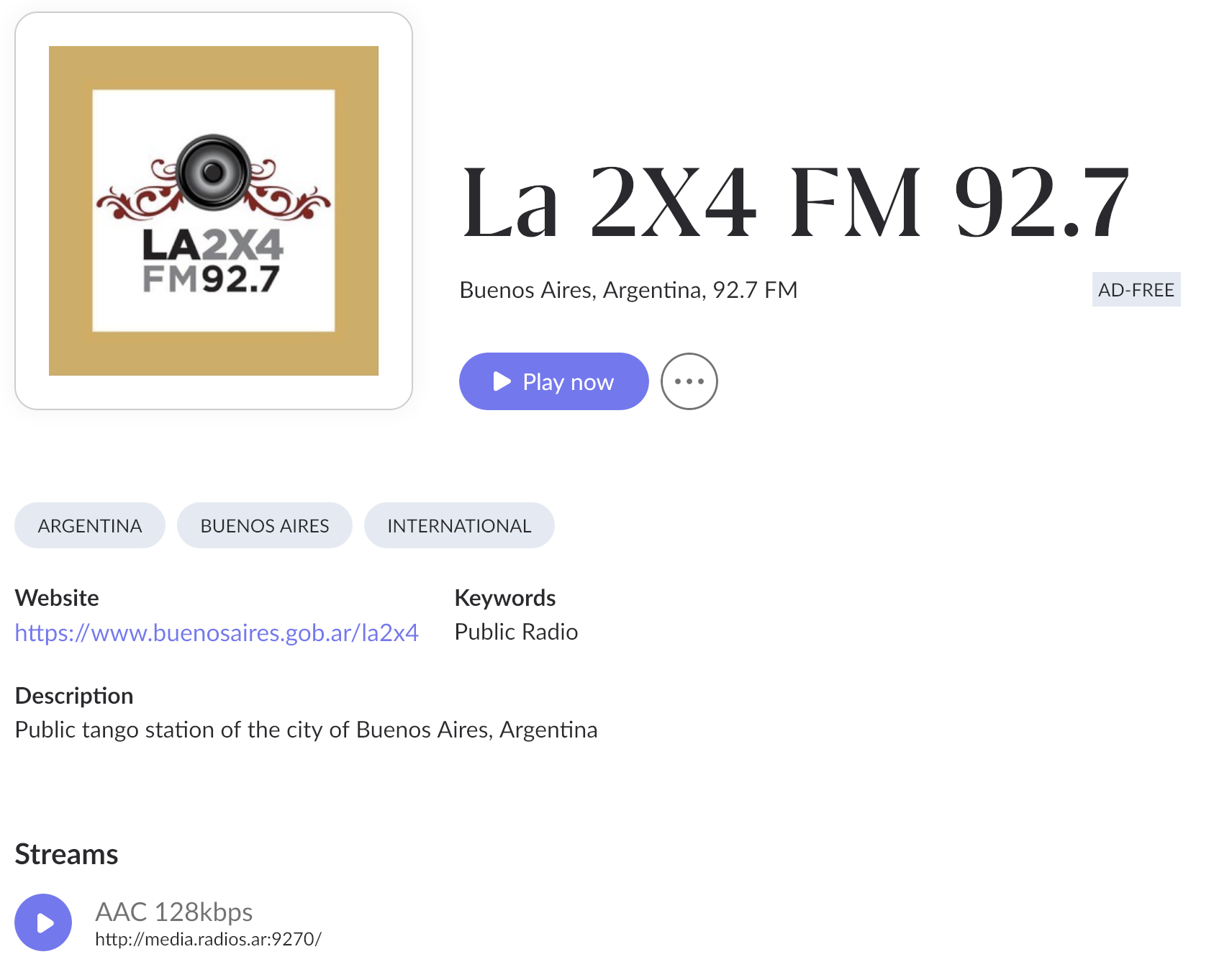

Hello @Filippo_De_Maio , the station was in the database as La 2X4 FM 92.7 although the URL was out of date and didn’t work. I’ve updated the URL - try now.
Hi Brian,
thank you for your support.
Still doesn’t work but the message changed, now it says " Playback was interrupted because a track failed to load"
Hmm, works for me.
It’s a .aac stream - can you play other such stations? CJSW or any BBC station.

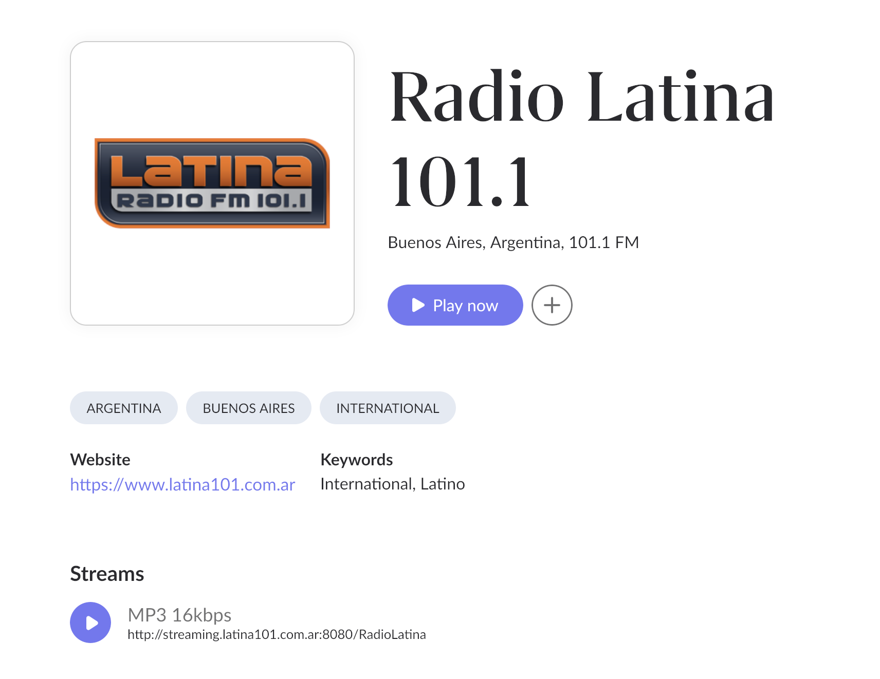

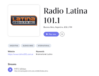

Well, I run Radio Latina with no problem, it is an MP3 stream.
It seems AAC not running on my side… same message with BBC radio and others.

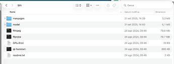

I read that this is an old problem. So bad that running QTS 5.2.6 and RS 2.54 this problem is still up. My RoonOnNas/bin folder is empty…

I copied JohnVanSickle – ffmpeg static builds in RoonOnNas/bin folder but it’s not enough … maybe I need to do more ![]()
Did you apply the executable permission on the file? (I assume you downloaded the correct version, unpacked it correctly, and restarted the server).
On the QNAP NAS. Log into the NAS, open the QNAP file manager, navigate to the RoonOnNAS/bin folder, right-click the ffmpeg file and go to Properties, Permissions or similar, enable „execute“
