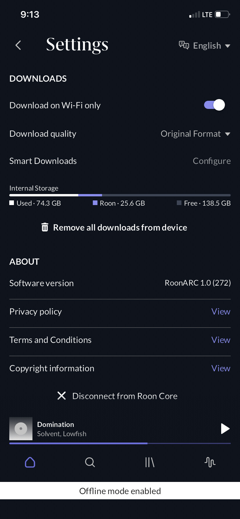

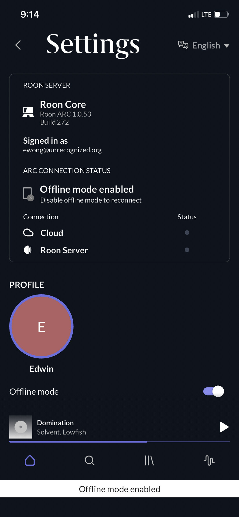

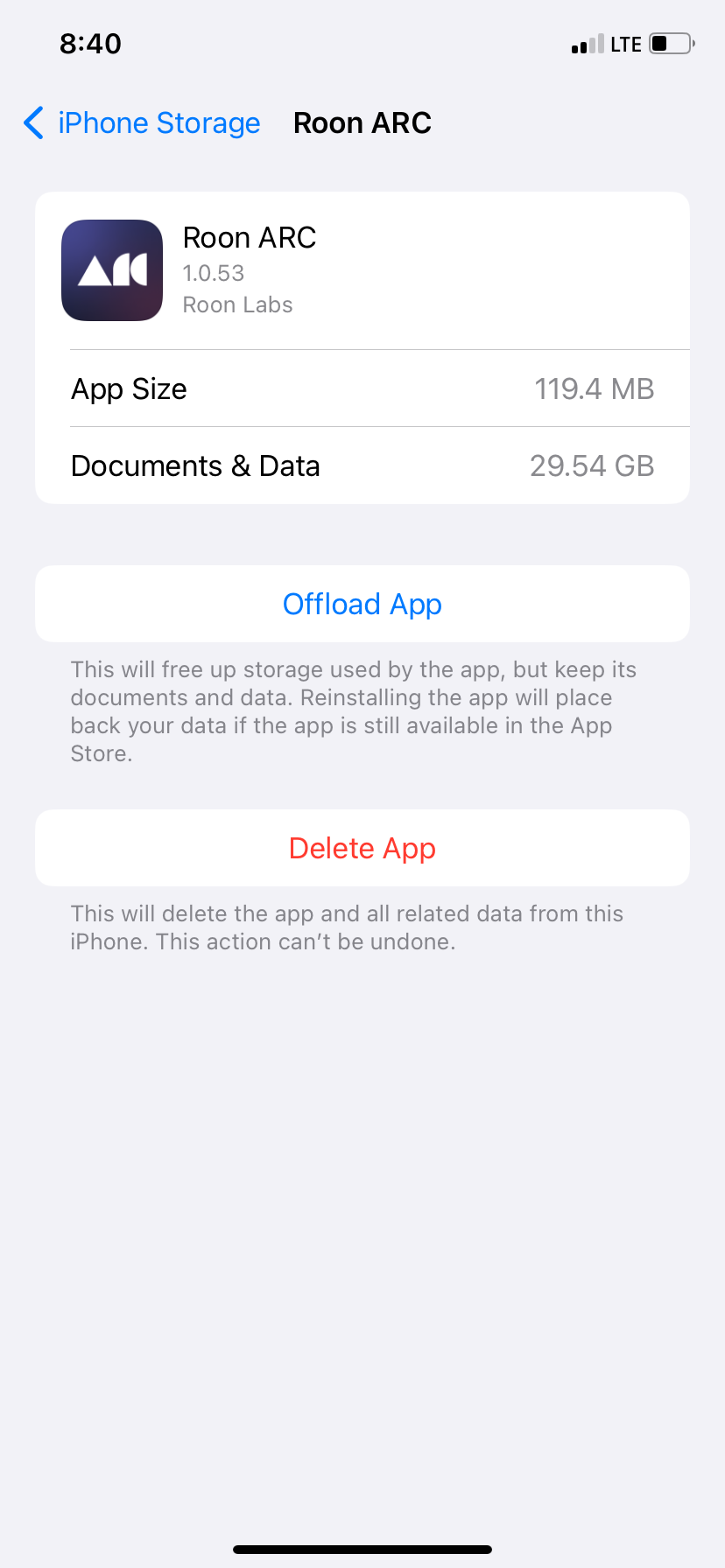

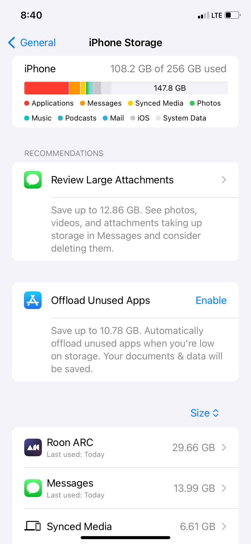

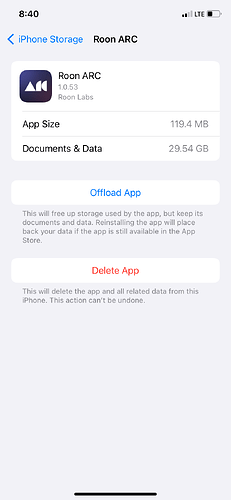

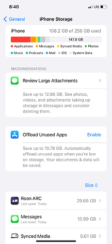

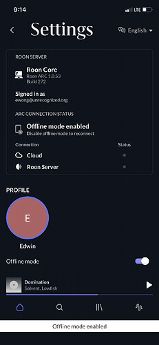

It seems Arc thinks the device is out of space, which makes sense considering the size of your library. Are you able to share a screenshot of your Arc settings>device internal storage?
I still have 150GB free on the phone.
Thanks for the screenshots, just to be thorough can you also share a screenshot of your Roon Arc settings showing the size of downloaded content?
I should have more information to share after discussing your case with the development team this week. :+1:
