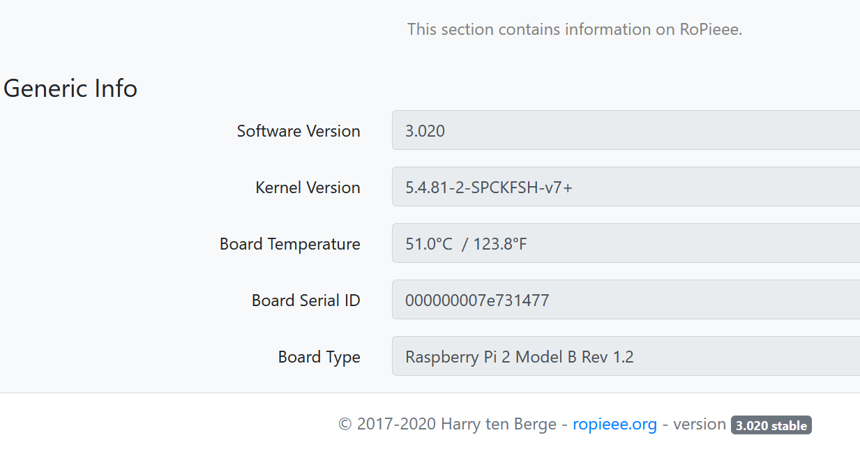

Hi, I’m new to Ropieee and have a question. I’m using a Magna Mano Ultra as a Roon bridge with RopieeeXL. I have auto update for Ropieee activated but would like to know if it’s working. The Ropieee web page says I have stable 3.020 installed. Is that the latest version? Roon says I have the latest version of Roon Bridge installed (version 1.7 build 571).

No, the latest stable branch is 3.094. See Stable release 3.094 (2021/04/07) for details.

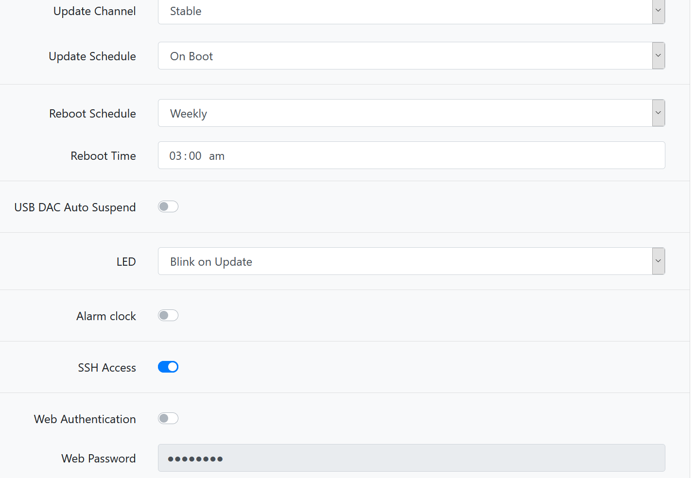

I’d suggest that you reboot manually to see if that triggers an upgrade, after verifying your settings.
Thanks Nathan,
I’ve tried rebooting. It’s not working. Here are my settings.
