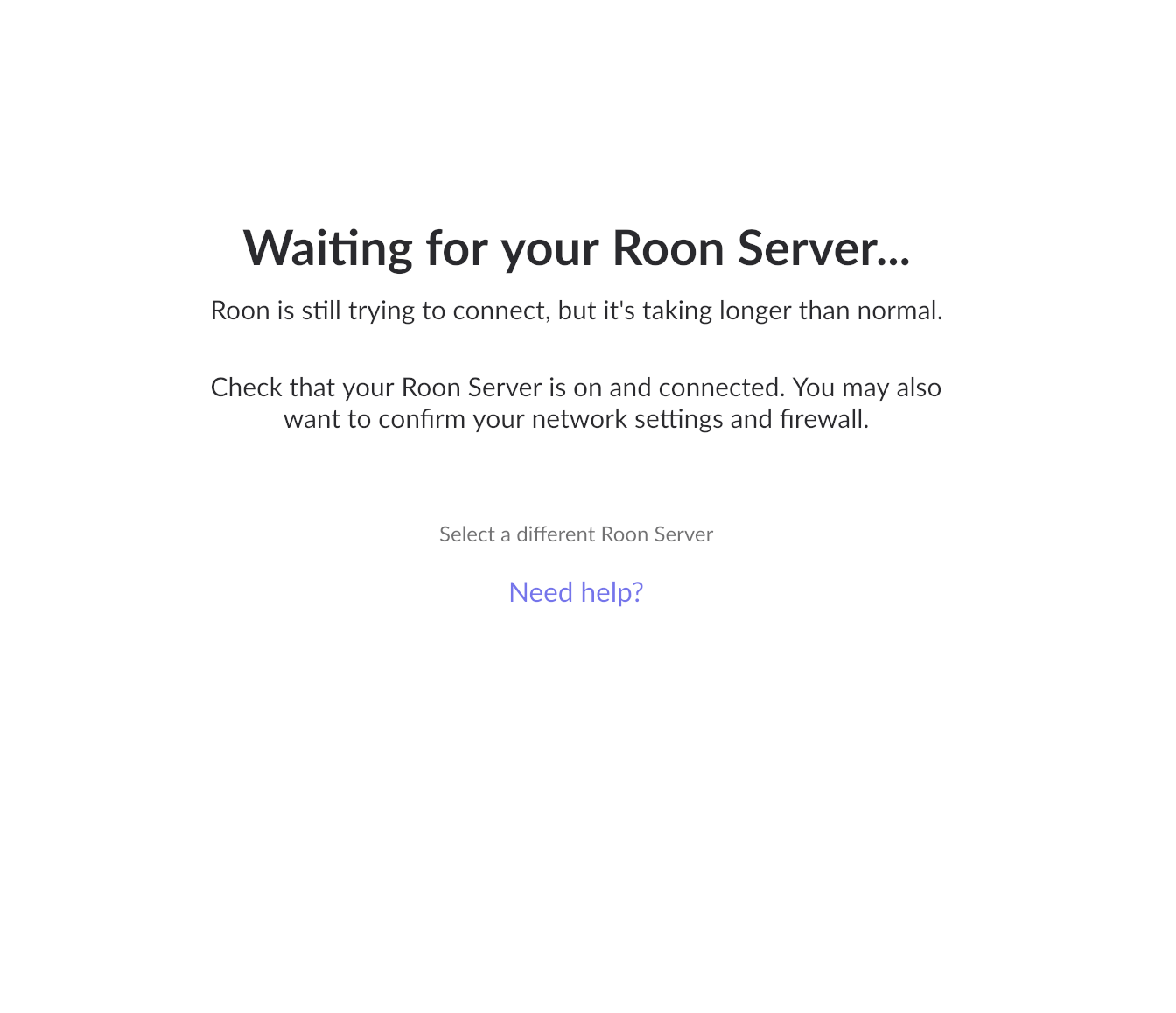

Turned on Roon tonight on iPad and told me an update was available. Now 30 mins later and it is waiting for server. Why release a n update that breaks the server connection? Can’t you test it first. I am a paid up user not a beta tester. What do. i do now. I want to listen to music, not spend the rest of the night trying to sort this cock up.
Does it look like this?
What happens if you click Select a different Roon Server?
Yes, exactly like that. On my iPad and iPhone.
I have tried selecting a different server on my iPad but same thing.
I have shut down my ROCK NUC and rebooted it, but same thing.

Thanks. Tried that and still waiting on server.

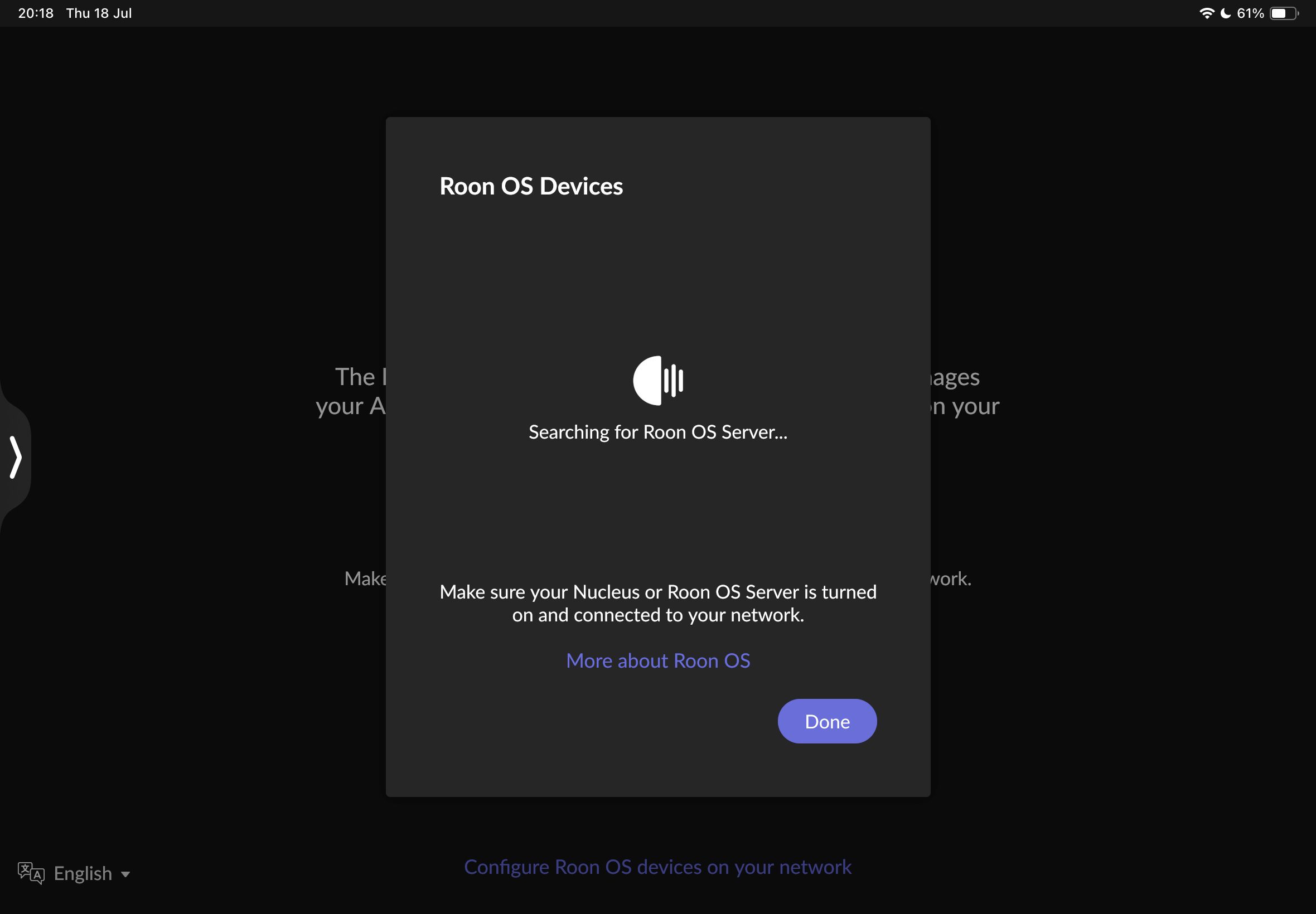

I now have this
