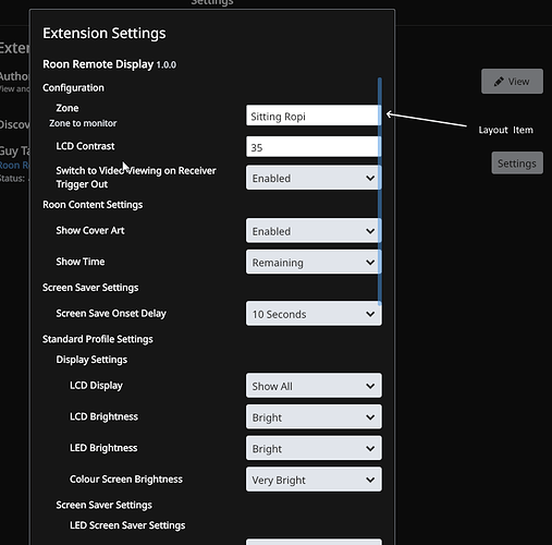

I am writing an extension which manages the settings for an external piece of hardware which communiates to roon via the Roon API.
The way it works is I change the setting via the Roon UI and the devices reads that to get it’s settings.
What I mean by a latout item, is one of the users editable fields in the extsion setting dialog. See following image:
So, with 30 items everything worked fine. When I added the 31st the saving spinner just sits there and never goes away…

Hi @gwpt,
Thanks for the screenshot. Can you provide a snippet of the extension showing how you’re calling the layout items?
