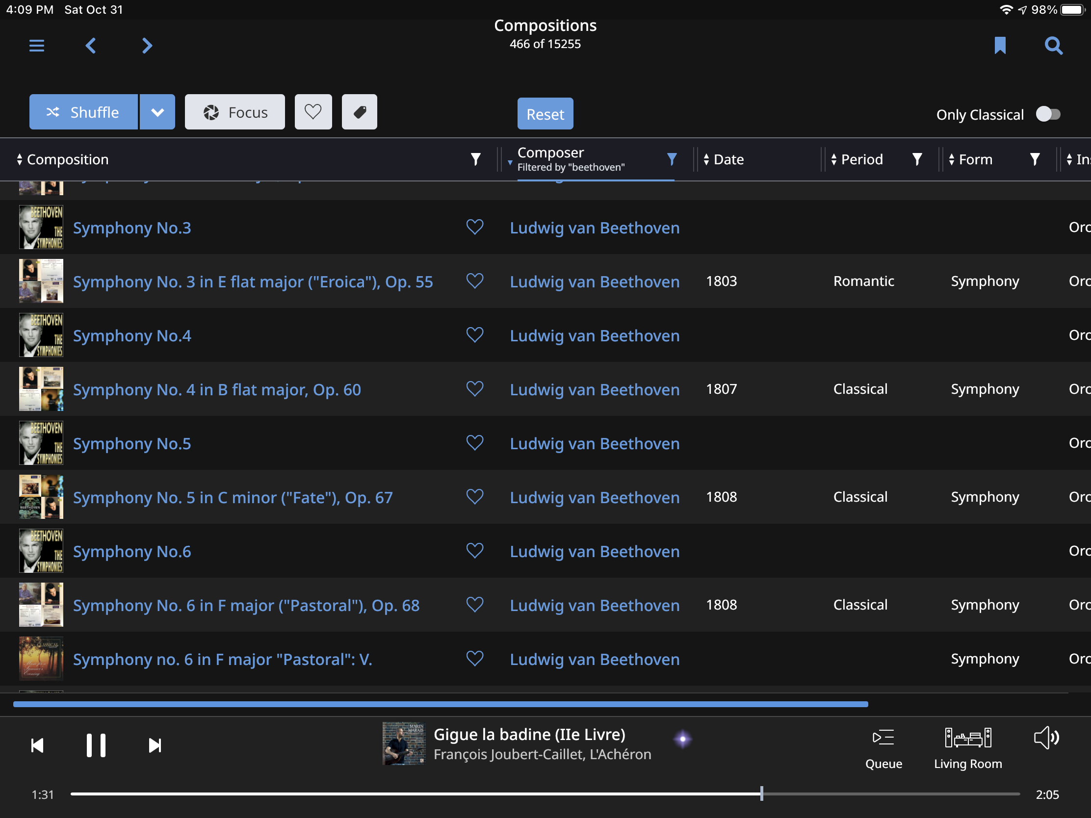

How did you get the layout in your screenshots, please… I should be able to try for my library if I know which Settings you used?
For some albums, the metadata that Roon retrieves from its metadata providers is enough for compositions to be grouped correctly. For others, you need to use an external metadata editor (I use Metadatics on macOS) to add WORK and PART tags to tracks to help Roon recognize compositions. If you do this, ideally you should use the exact same composition name as Roon uses, which in most cases you can find by looking in AllMusic.com. More details herehttps://help.roonlabs.com/portal/en/kb/articles/file-tag-best-practice.
For some older or reissued material, especially boxsets assembled from older material, getting it all right can be a lot of work, in part because the reissuing labels don’t bother to provide good metadata to AllMusic.
That’s the Compositions view from the hamburger drop-down, I didn’t do anything special, just selected compositions and sorted by composer. That’s on an iPad.

You can sort out the top image by Merging the Compositions , that will give you one value per symphony. Just left click to select the 2 versions and the Merge Composition button should show
