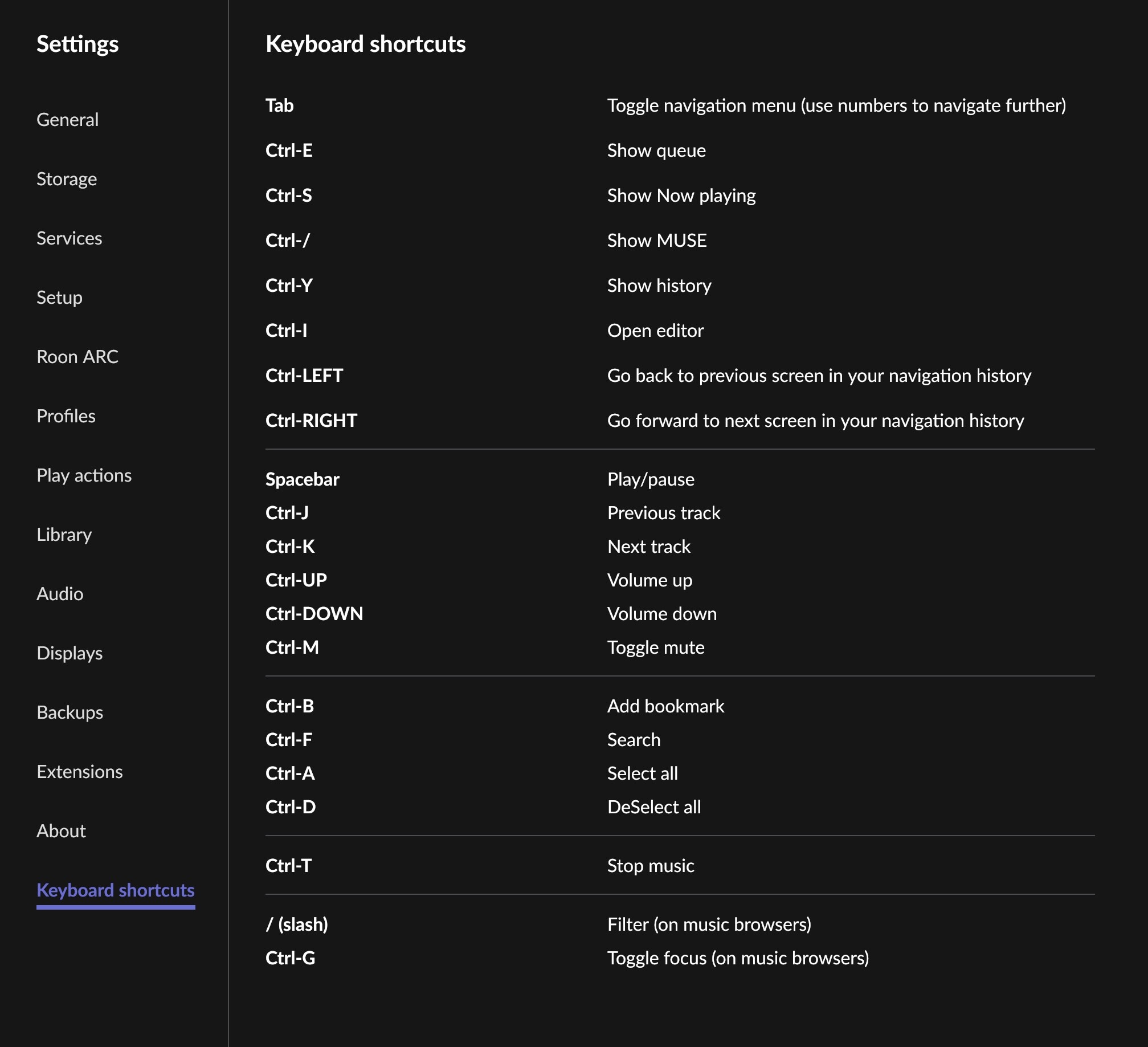

When one of these stops happens, can you try to connect to Roon with your iPhone and check its state? Reason I’m asking is that I use a Macbook often as a Roon remote and occasionally an accidental wrong key press causes Roon to misbehave while in the background from other apps.
There are a few keyboard shortcuts that could cause problems if roon is running in the background…
Have you another device you can use to prove the source of the problem?
