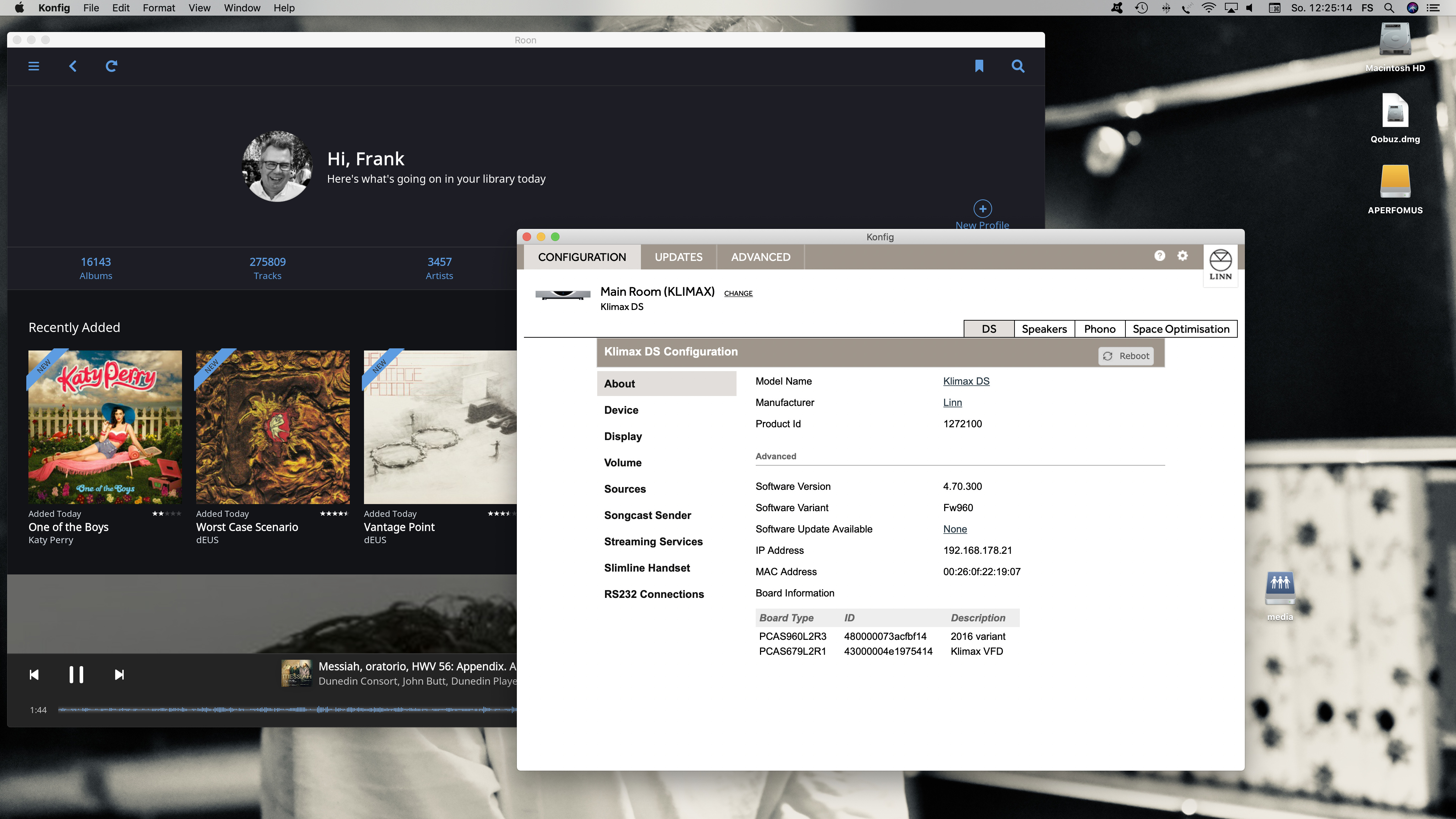

LINN Klimax DS via LAN and Linn Klimax Kontrol (preamp) connected via RS232 to Klimax DS

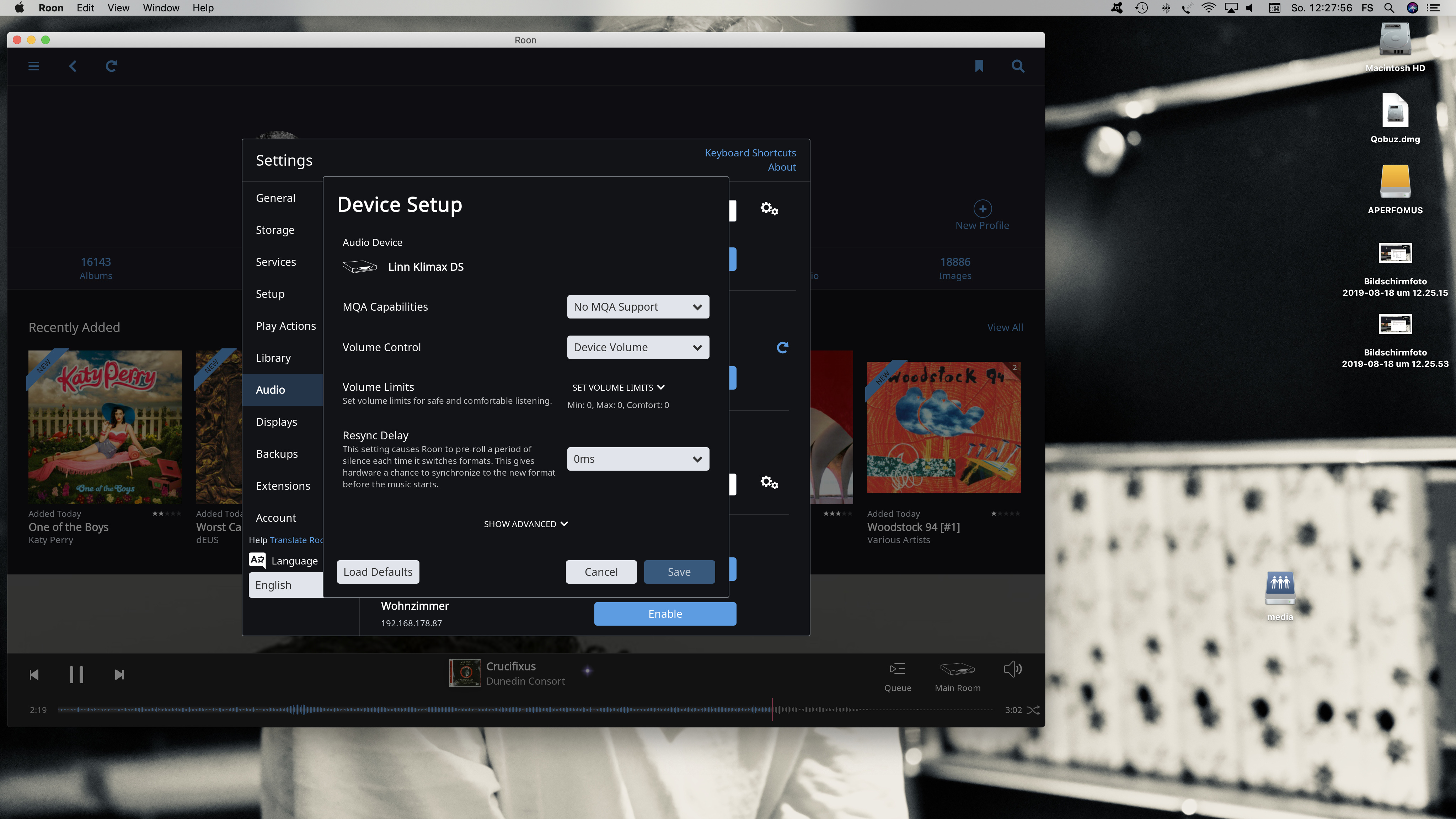

I note that Min, Max and Comfort are all set to zero. Can you change the Volume Limits?

I tried it but it´s not possible to change these settings.

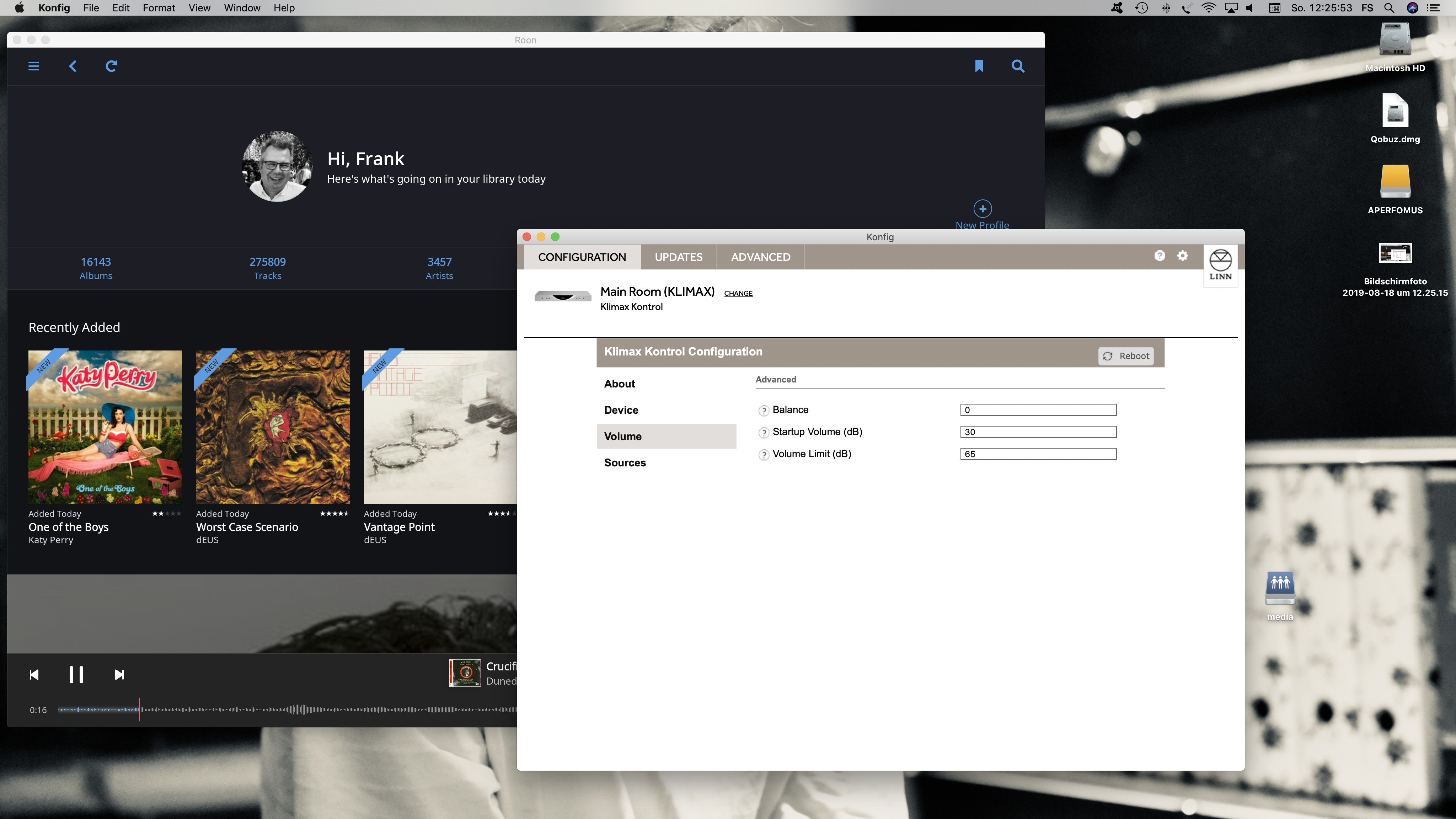

The Klimax Kontrol (KK) is discontinued by Linn Products, but is still a superb preamplifier. To control volume through the Linn Klimax DS there is a RS232 wire between KK and KDS, so you can control volume through the KDS. It works with control points like Bubble DS or Linn Kazoo.
It´s the only thing wich I miss in roon to control volume. I´ve to use the Linn remote control in addition .
Frank

Unfortunately it appears that Roon’s built in Linn streaming is unable to access the volume control of a connected Linn Klimax Kontrol preamp. This is due a limitation in the Linn Klimax DS limiting the device to only being able to expose its “fixed” volume control to Roon. Linn makes mention of this in the Roon documentation on their website:
https://docs.linn.co.uk/wiki/index.php/Linn_DS/DSM_control#ROON
