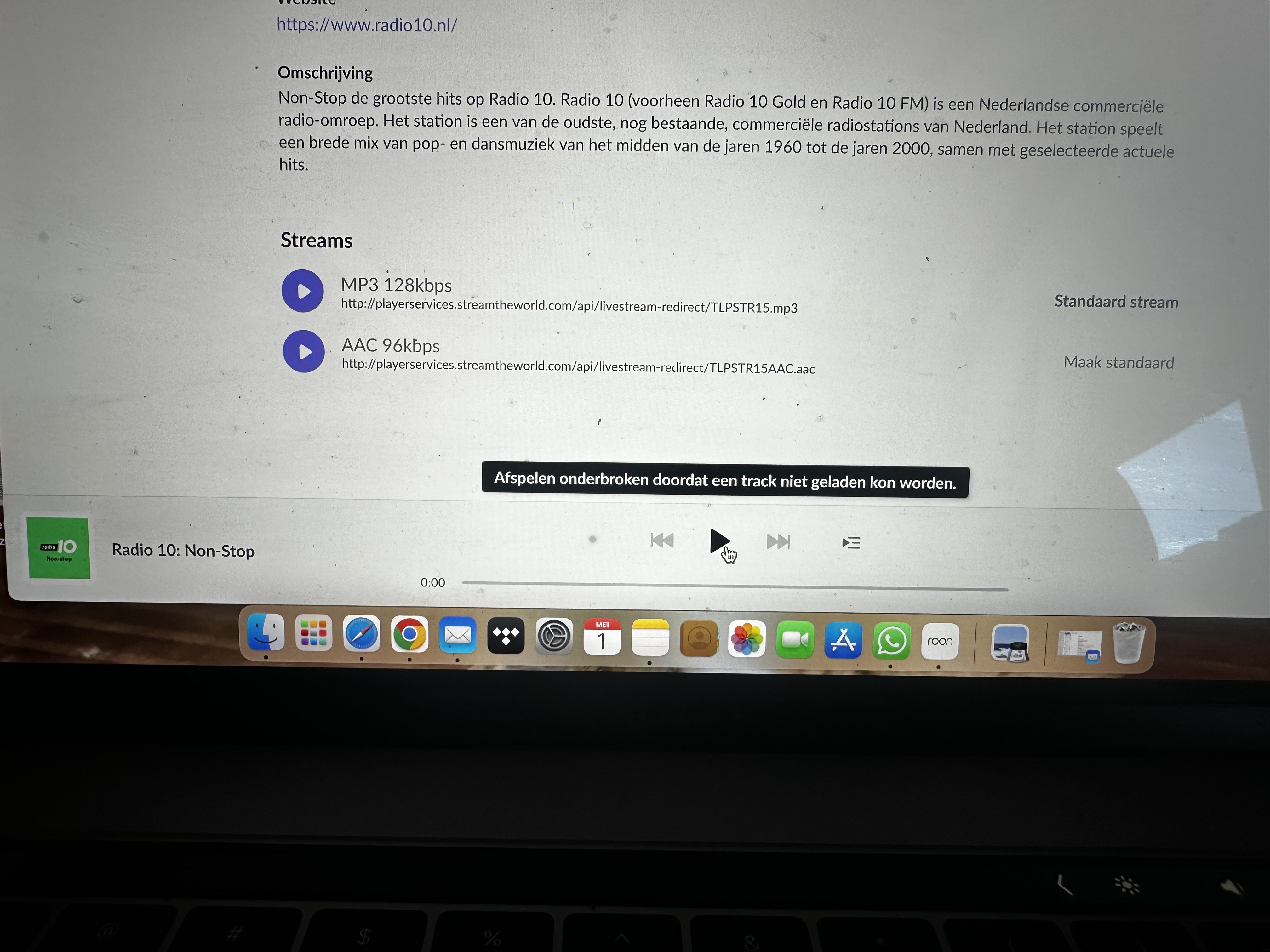

Hi, My live radio stations did work perfectly until now … Not anymore, I get the message that he stopped playing also a track could not be loaded. Have no clue what to do!
Can anybody help me out?

We were able to enable diagnostics on your Roon Server, and observed the following errors around your live radio playback:
Warn: [Worker (2)] [zoneplayer] I/O Failure While Opening Sound: icy://playerservices.streamtheworld.com/api/livestream-redirect/BNR_NIEUWSRADIO.mp3: Read failure: ExternalProcMissing
Could you please share a screenshot of the webUI from your ROCK? I’d like to see if any codec updates may be needed, here’s more info on this process:
