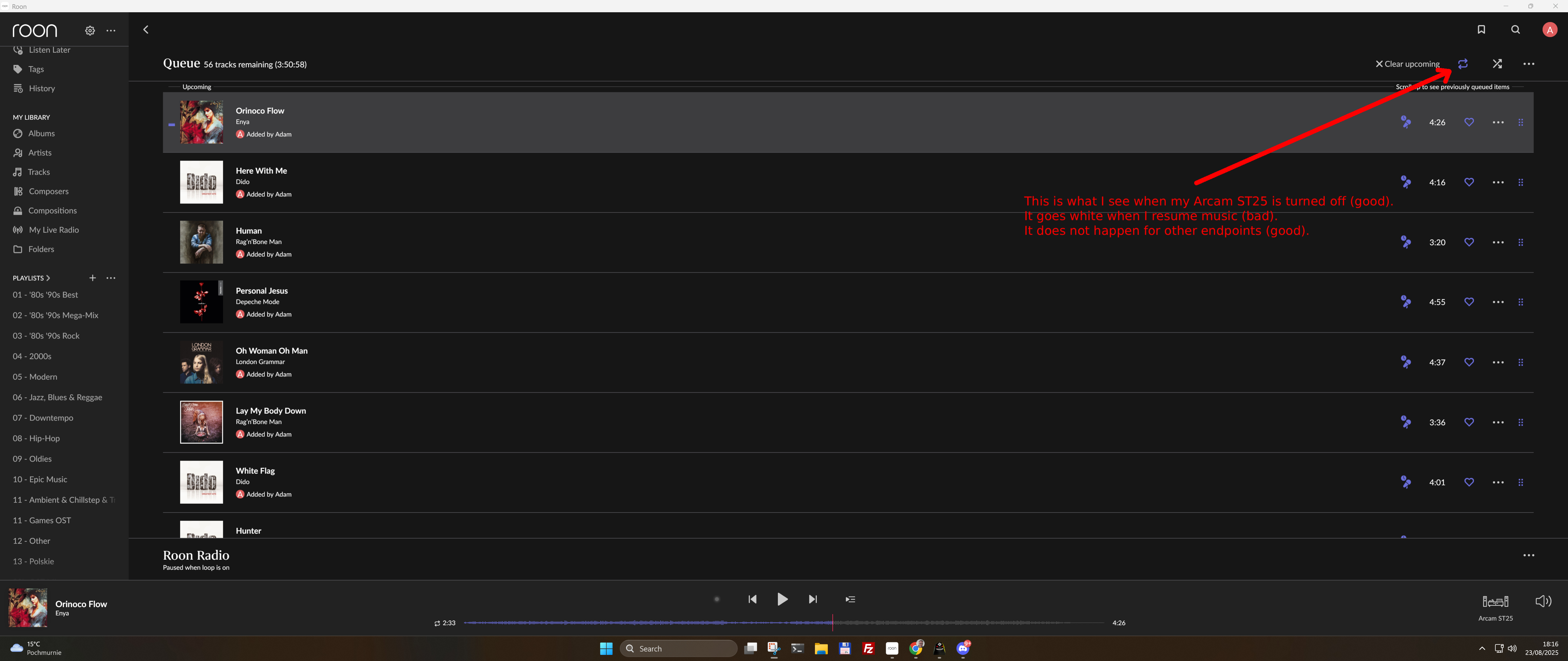

Hi, I am having issues with loop playback. When I use my Windows PC, Raspberry Pi (HiFi Berry OS), or Arcam ST25 via AirPlay, it preserves loop playback without issues. I select my playlist, pick shuffle, click loop in the queue, and that's it. Every time I resume playback, it is still looped. However, it does not work with Arcam ST25 as a Roon Endpoint. When I stop playback and ST25 goes off, I can see the loop still turned on in the Roon app. Sadly, when I resume the playback, it instantly goes off.

Sure. Here are the timestamps:
18:30 - Started playback of a playlist named 01 - '80s '90s Best on my Arcam ST25. The first song was No Son of Mine by Genesis.
18:37 - Stopped the music and turned off the ST25. It was still visible in zones.
18:38 - Turned on the ST25 (the loop was still enabled in the queue).
18:39 - Resumed playback. Loop was disabled.
All times are UTC+2 (Polish time).
