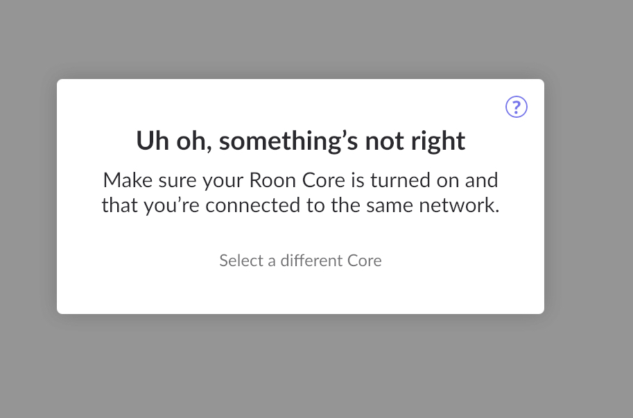

Since upgrading to build 970 I’ve noticed that I’m losing the connection to the core during the initial part of a backup. It starts as normal, with the snapshotting database message, then switches to the following …
Then there’s a few minutes of this …
Then everything goes back to normal and the backup page indicates that the backup is being prepared. Everything else is normal from then on and the backup completes successfully.
I haven’t posted in support, as this doesn’t seem to be an issue per se, but it is different behaviour from releases prior to build 970. Has anyone noticed the same?
Dave, definitely interesting but also troubling. What platform do you use for your Core, is this screenshot from the Core platform or a Remote, and and is the backup target another device or are you backing up directly to the Core?
Robert, everything is taking place on a Mac mini M1 (16GB) running Roon Server and the Roon app as client. The backup was also to the same machine.
EDIT: I just forced another backup, and the same thing happened. This time though, when the “Uh oh, something’s not right” message appeared, I click the text at the bottom of the dialog, i.e. “Select a different Core”. This took me straight back into Roon where everything seemed to be progressing as normal …
As I mentioned in my original post, this doesn’t seem to be a huge issue, as everything else seems to be working as expected.

I’ve also started having daily issues with errors with my core and clients not connecting. I’m honestly at a loss as to where to being my toubleshooting.
First off, I’m running core on a MacMini i7 running MacOS 10.15.7. Core is Version 1.8 (build 970). Each time I launch Roon on my MacBook, MacPro or iPad Pro 12.8 there is no core to connect to. I select the option to select a different core. Then I see the Core running on the Mini. I select it and then receive the Uh oh, Something’s not right message.
I’ve rebuild the core from a backup from 2 weeks ago. I have restarted the Core mini (multiple times). I’ve validated all networking is working (nothing has changed on the network at all in the last month or so).
Where do I start with my troubleshooting.
