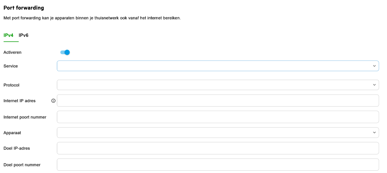

Hi, one night ago my provider KPN in the Netherlands upgraded my router (KPN Box 12) software. Because it did not work I had ro reset the router completely and have lost the ARC port forwarding settings. Also the UI has changed because of the upgrade. How do I reinstate my previous ARC settings (port settings on the router?). I believe that several people in the community use KPN as provider in the Netherlands and have the same KPN Box 12 router.

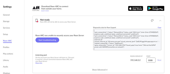

My Roon settings for ARC: error message

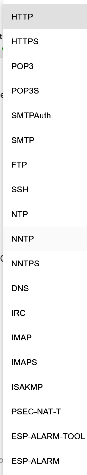

What service do I choos on the router? This field is obligatory. Choices:
Apparaat = device (I can choose the Rhein here)
Doel = target
The rest looks pretty similar to the English words;-)
Are these choices or presets?
Can you treat the filed as free text and enter something like: “Roon-ARC”?

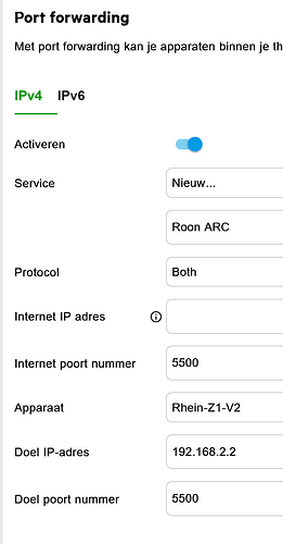

If so you can then go on to enter:
Protocol: TCP
Internet Poort Nummer: 5500
Doel IP-addres: 192.168.2.2
(Incidentally, 5500 is an unusual port number for ARC. The default is 55000.
If not, is there an ‘other’ type selection available?
This might then allow you access to a ‘service name field’ (which you can name ‘Roon-ARC’).
If neither of these are possible, there may be another settings page for explicit rules.
Actually, 5500 probably isn’t expected to work because according to the docs:
You can enter any available port in the 10,000 to 65,000 range.

Only if these settings have been successfully done by a KPN (=provider) user based in the Netherlands, Europe they may be an option. But, last time I found out that the port range between 10,000 and 65,000 (in Europe we would call that 10.000 to 65.000 (. instead of ,) are NOT used/usable in this part of the world. The port is not my problem, it was 5500 and worked and I believe that that is still ok. So, for Europe/Netherlands port 5500 is completely ok.
My problem are the other router fields. So, I’m looking for a Dutch (Netherlands) client of the KPN provider like me who uses the KPN Box 12 router (after the recent upgrade) like me.

I use 55000 in Germany, it depends on your provider. However, i referred to the range in the docs because I figured that Roon is not even listening on ports < 10000, at least I understood the docs this way.
But if it worked for you, then OK. It is, however, a very unusual configuration by your ISP and arguably violating internet standards because
The range of port numbers from 1024 to 49151 (210 to 215 + 214 − 1) are the registered ports. They are assigned by IANA for specific service upon application by a requesting entity.

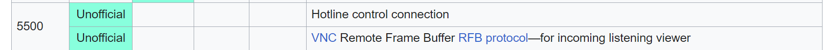

and e.g. 5500 is already in use by other applications:
You are not likely to be using them, but the reason that the ports 1024 to 49151 are registered is precisely to avoid conflicts, and is why Roon defaults to 55000, which is in the free-use private range. If your ISP messes with that, they are being idiots.
But OK, as long as it works…

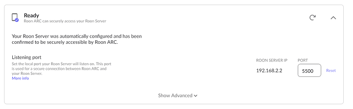

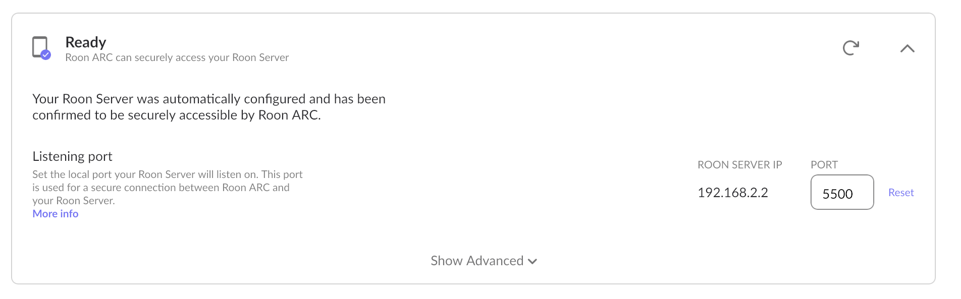

HI GUYS, MY PROBLEM IS SOLVED
Hi,
Thanks for your knowledgeable answers. I looked it up in the list and found the following.
I found this port via a another KPN user in their community. Considering the above I do not believe that there will be an actual conflict or transgession of rules.
And, Roon ARC rules! (irony).
Thanks,
Hans
P.s. the port Roon provides as standard did not work with my provider/router.
