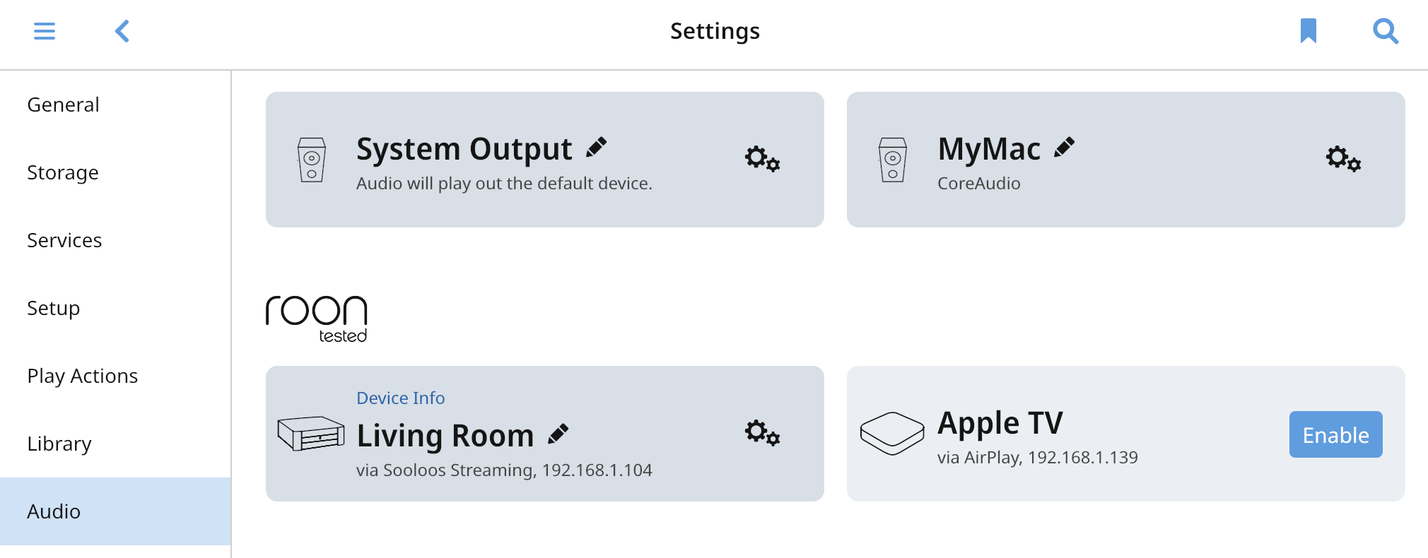

I could always see my Bowers and Wilkins 800D’s in my speaker output list and now suddenly they have disappeared? See screen grab.
So the sound seems to be playing through the standard Apple output drivers which is the cause of the reduced sound. Its strange that i can still see my Meridian 818v3 in Roon though which is strange?

Does this show up if you go to Settings > Audio?

I can also see the ID41 (Meridian on the network) see attached.

Hey. I am pretty certain (although I can’t see it now) that I could see the Bowers and Wilkins name in the Preferences. What I am not sure is any mention of Meridian. If preferences effectively picked up the ID41 on the 818v Could this be responsible for recognition of the speakers? Anyway, either way, I now can’t see either of them and the sound is playing trough the ‘default’ external output preference.
@Matt_Farrar, I think your 818 should appear in Sounds Preferences if/when you have connected it to the Mac using usb. The user guide says…
“When the 818 is plugged in to the computer it will appear as a sound output device called Meridian 800 Series Output in the Sound control panel (PC) or Sound System Preferences panel (Mac).”
If it’s not connected, it won’t appear.
If Roon is identifying the 818 Sooloos input ID41 on your network though (which it appears to be) I think music is playing correctly over the network, and the Sound Preferences settings are irrelevant.
