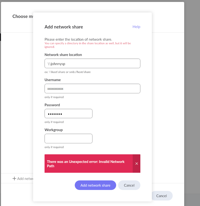

After Roon Rock & Roon ARC ran fine for weeks without any problems I recently lost connection to my Synology NAS storage shares and have not been able to add them back. I continually received the message “There was an Unexpected error: Invalid Network Path”. What I did to remedy this was reinstall the OS via the ROCK home screen options, tried again to add a share from the NAS and still I was not able to add NAS shares with the same message. Via the ROCK home screen I reset the database, reposted the ffmpeg file in the Codecs folder and still I can’t add any shares from the NAS. I also rebooted the NUC & NAS a few times in between as well. I have gone through the Synology NAS settings and have found nothing out of the ordinary as both SMB & DHCP are turned on. What am I possibly missing here?

What ever you entered as path for the share does not get accepted as a valid SMB network share (path). I don’t know what component is responsible (a validator in Roon, .NET, system library, …). Without you sharing more details, we simple Roon trying to help, do have a hard time to come up with additional troubleshooting steps. Do you have any special characters in the path name maybe?

I have entered the NAS share name of johnnysp in all possible ways including the internal IP. There are no special characters in the path.
\johnnysp
\johnnysp
\johnnysp\Music Library\Music\Albums
\192.168.1.249
smb://johnnysp/
None of the above nor with variations will work for me at this time.
All the variants that contain the host part only, omitting the share part, are invalid. This leaves us with only: \\johnnysp\Music Library\Music\Albums\\johnnysp\Music Library without the ignored parts.
Assuming that you actually have a share named Music Library, I would say it contains a special character (a space character) that usually needs to be escaped to work properly. Google finds different variants of escaping spaces in share names – none of witch I’m sure it will work reliably here. I think it would be best if you could just change the share name on your NAS (Music_Library or MusicLibrary) so it no longer contains a space.

I tried Sven’s suggestion resulting in the same failing message.
As for Jack’s suggestion, I tried another share on the NAS with \johnnysp\music as well as other shared folder names that do NOT have spaces or any special characters in the folder names with he same failing result. Keep in mind Jack that \johnnysp\Music Library with the space worked perfectly for weeks. Any other thoughts appreciated, but I am beginning to think this may be on the Synology NAS side.

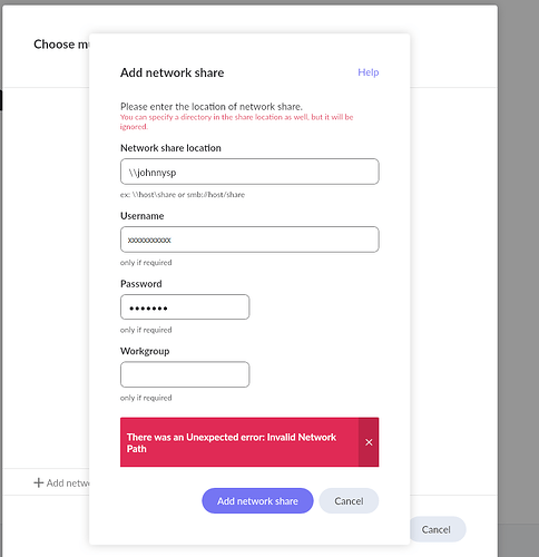

Update: It appears the editor will not allow double backslashes while in this edit. So in all my messages please realize when you see my post with a single backslash it is meant as double forward slash. Thanks.
Use a triple backslash to see a double in the forum.
Failing but really for the same reason (invalid path)?

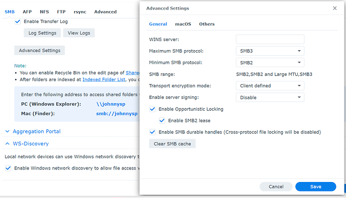

To be sure while troubleshooting, I would always use URL notation (smb://host/share) and IP-Address instead of host name. Check on the NAS if SMB v2 connections are allowed. Share your related NAS settings if you like, check the DSM manual if unsure and take a look at Roon’s NAS setup guide also.

Escape correctly using 3 backslashes (type \\\ to get \\) or format the string as preformatted text (symbol </>).
Got it on the backslashes, thanks!
Yes Jack, still invalid path what ever path I try. Yet no problem reaching it from my PC. Also no problem playing music if I use DSAudio app from the road.
Included here is a screenshot of my Synology SMB settings.

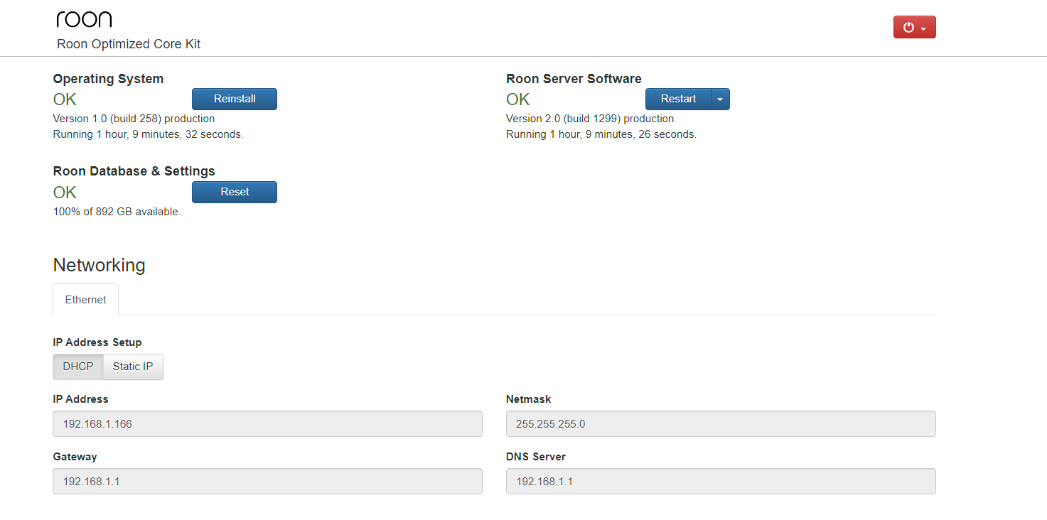

Good things to try Sven, and I will, but first I want to figure out how to ping the NAS from the NUC Rock also per your suggestion. I have the NUC set up now with a monitor mouse & keyboard with ethernet to the router, but the usual Ping command does not work from the NUC’s OS. How can I ping from the NUC? What is the command? I am not too familiar with SSH and I have it turned off on the NAS.

Thanks Jack. As I mentioned to Sven, I need the command to ping from the NUC to the Syno.
ROCK is a closed OS – no access for the user. If you want to test the physical network, boot the NUC with a bootable USB-Stick with a Linux.
