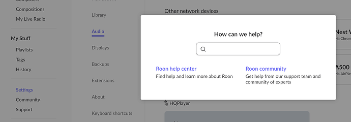

To me that is a question for roon really but I notice it is no longer possible to tag @support on the forum. Also the roon support link now splits to Roon help center and Roon community
Maybe it has been that way for a while but I have only just noticed. Can I expect an official response on the roon help center channel? I do notice a large number of comments about a lack of roon support responsiveness but is that about the community channel or the help center channel?
