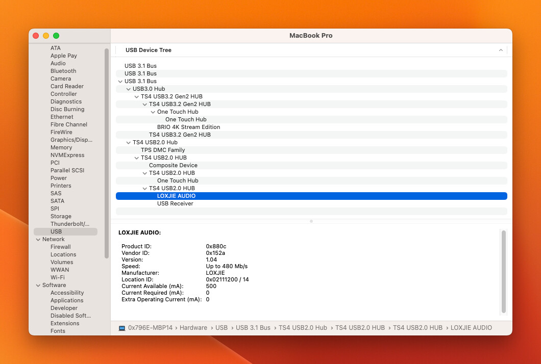

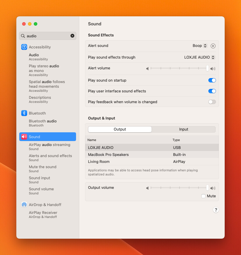

DAC used to be visible on Roon, and one day stopped being visible. I can still use the DAC with every other Mac OS app on the computer where I want to use this DAC.
Roon client experiencing the problem is a MacBook Pro m2. For months, the DAC was working perfectly, but one day after an update Roon stopped listing the DAC, but it is still visible on Mac OS and perfectly working there.
The DAC has always been connected through a cal digit TS4 without any problem.
