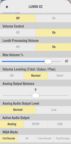

Wow! I just installed the firmware and it seemed to supercharge the sound quality! As you’ll see from my screenshot I’m using “normal” vs “quiet.” I guess the quiet setting diminishes the volume level. I might end listening more via the Lumin app vs Roon. I need to do one additional experiment. Many thanks, Peter!

To compare against Roon, please set Lumin Volume Leveling to Normal, Roon Volume Leveling to -14 LUFS with adjustment for unknown loudness -5 dB.
Lumin Volume Leveling Quiet is -19 LUFS to follow Spotify.
Since the overall volume is decreased when using Volume Leveling, please turn up the volume by at least 10 steps in Lumin app, or at least 5 dB if using a preamp.
Thanks, Peter.
I was already using Roon volume leveling with these exact parameters, so the comparison with the Lumin app with the new volume leveling set at normal still is a pleasant surprise. I was, of course, expecting the same volume levels from Qobuz track to track but, for whatever reason, the overall sound quality of music from the Lumin app seems to have increased substantially.
