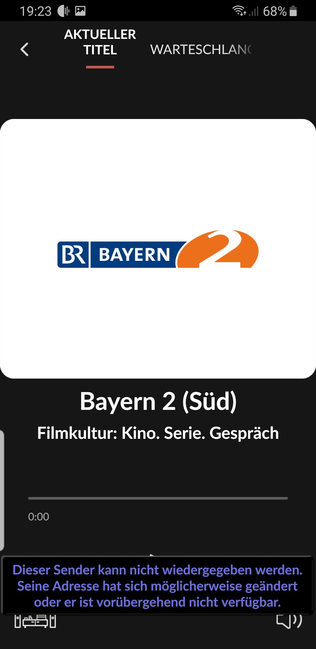

I can’t find “address has changed” from here. If it’s impossible to screen capture or take logs, please memorize the exact and complete wording for the “address has changed” message you said you saw and tell me.
Were you playing to a single endpoint (T2) or grouped with others?
Is the network from the Roon Core to T2 and other endpoints completely wired instead of going through WiFi or powerline network?
It’s really hard for me, to get the message (only shown a few seconds, while stopping), but I’ll try…

Now I’ve got a screenshot for it:
Hi,
Thanks for the screenshot.
The only thing I can think of as a next step is to get a cheap switch (Netgear GS105 or any cheap unmanaged TP-Link switch), and have the Roon Core and Lumin connect to this switch. Then connect this switch to the router.
