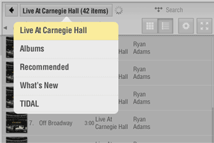

If that’s the case, in Lumin app above the view icons there is a button that shows what Tidal folder you’re looking at:
Tap this button, choose TIDAL. Then choose TIDAL for a second time - this forces the Lumin app to refresh its cache of Tidal view. Then you can go into My Music / Favorite Albums to find the favorite albums in your Tidal account.
