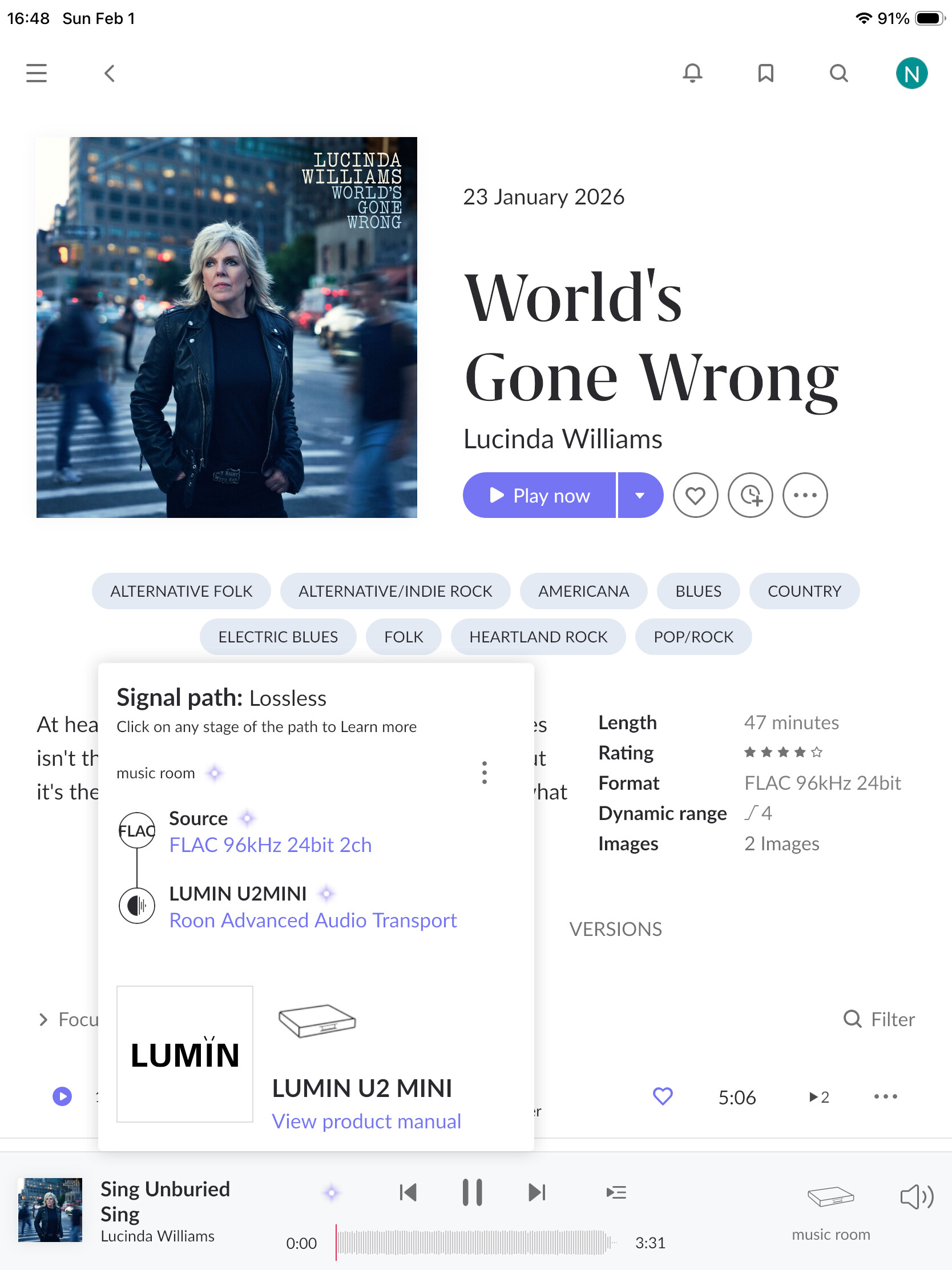

My U2 Mini, which I have been enjoying for over 3 years has just developed a problem where it will not output a signal to my Ferrum Wandla DAC over USB.
I have been using it in Roon Only mode, but did a factory reset, updated it from firmware 20 to the latest version of 21 using the Lumin app, checked to make sure the USB was still selected for output and power cycled it. Initially it worked, passing a signal through and I had music streaming from my Nucleus, through my Asus router and several metres of Ethernet cable to the Mini. From there it was outputting as normal to the DAC. However, if I pause the stream, I can’t restart it until I power cycle the transport again.
When looking at the Roon routing it is clear the file is being sent to the Mini, but it isn’t being sent from the Mini to the DAC. Any ideas about what might be happening and how to fix it?

After doing the factory reset and playing from Qobuz Connect and MiniServer, I also tried playing from roon, which also worked. I then paused the stream, turned off my DAC, waited a bit restarted the DAC, and tried to restart my roon stream. It did not work. The album art and information showed up in the roon app but it did not show up as passing from the Mini to my DAC, just as in my photo in the initial post. Although the name of the Album and track showed up on the Lumin’s screen there was no data about the sampling or bit rate, which of course was not being passed to the DAC.
I am using a roon nucleus as a server Roon Server version 2.58(build 1608)
Again thanks for your efforts, it does seem to be an issue with the roon stream, in particular passing through the transport to the outputs. Qobuz through the Lumin App, Qobuz Connect, and the MinimStream through the Lumin App all seem to be passing the signal flawlessly. Of course none of these have the functionality nor ease of use of roon.
